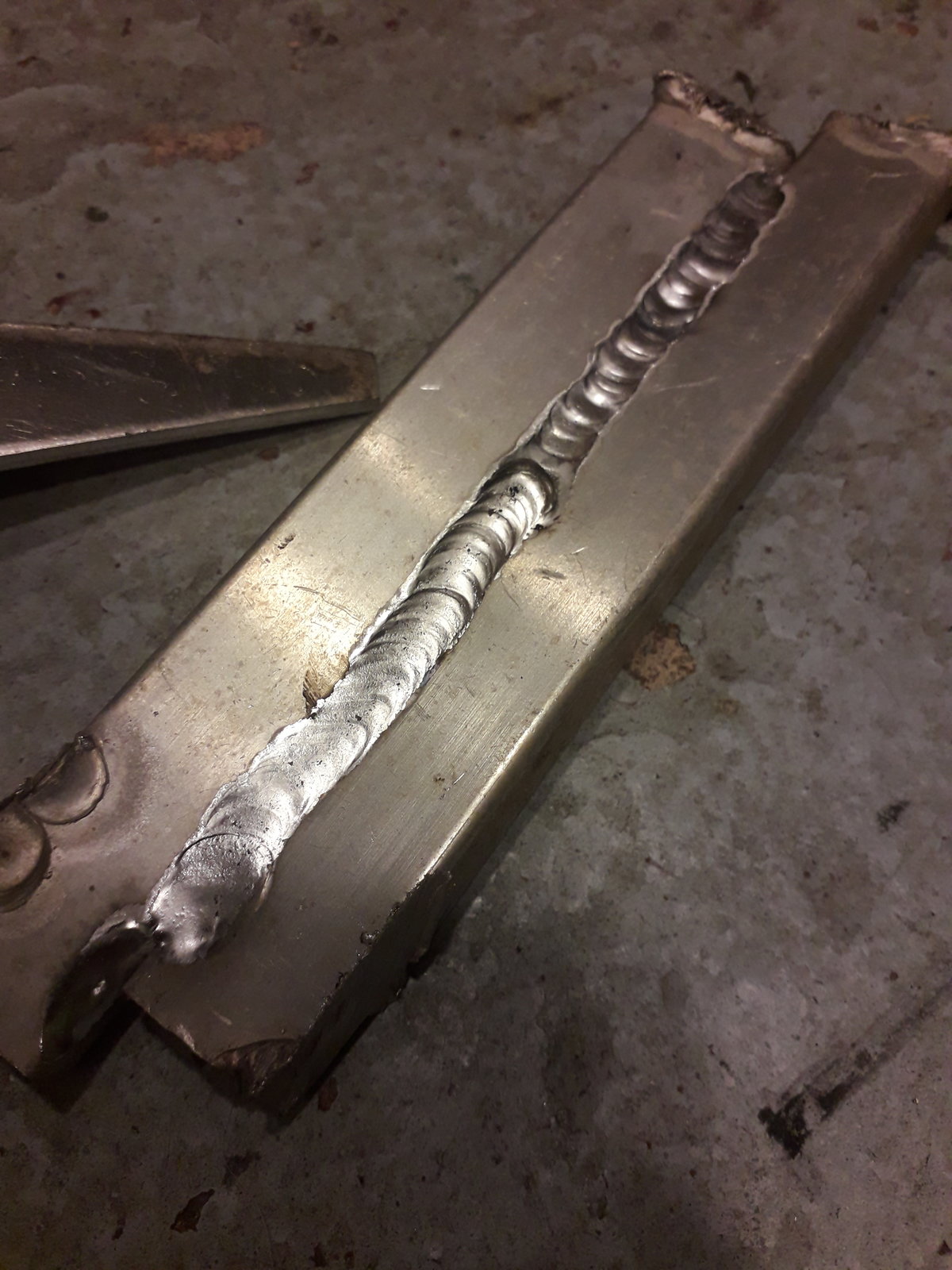

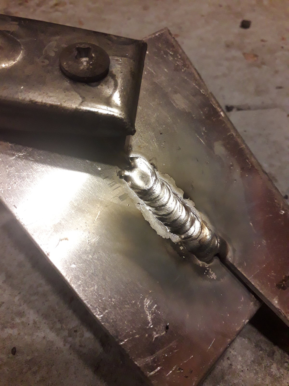

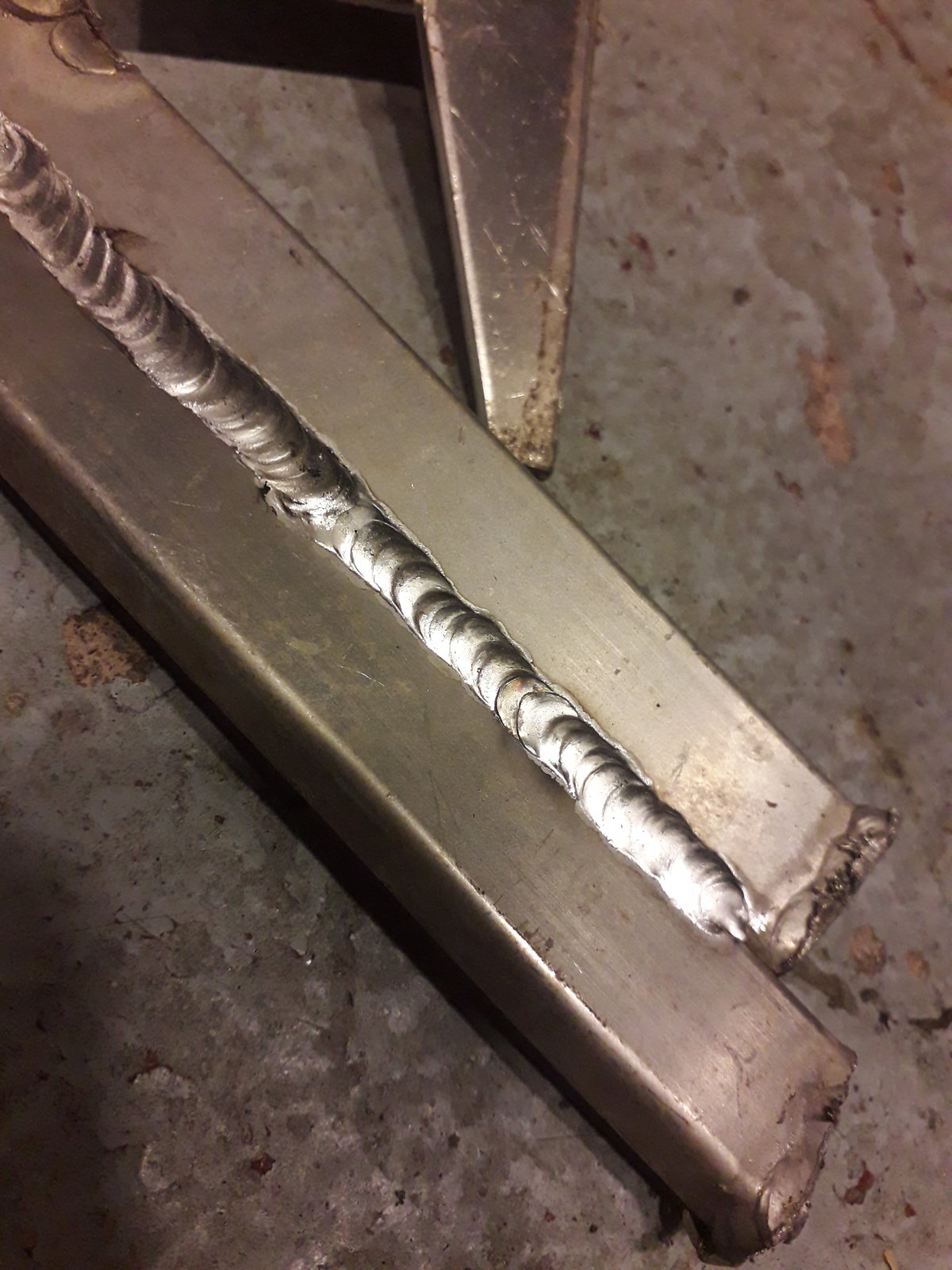

Too vicious imo
A thick piece of aluminium
Set balance to 50/50.
Set down slope to 1 second
(Doesn’t work with red tip tungsten)
Set current to 100-120 amps for 2.4
Set current to 70-80 amps 1.6.
Prep tungsten as per the 2 angled prep in the guide I wrote.
Dead on 90° to the job, 2mm arc length hit the button watch it ball and release. Short busts till your happy.
