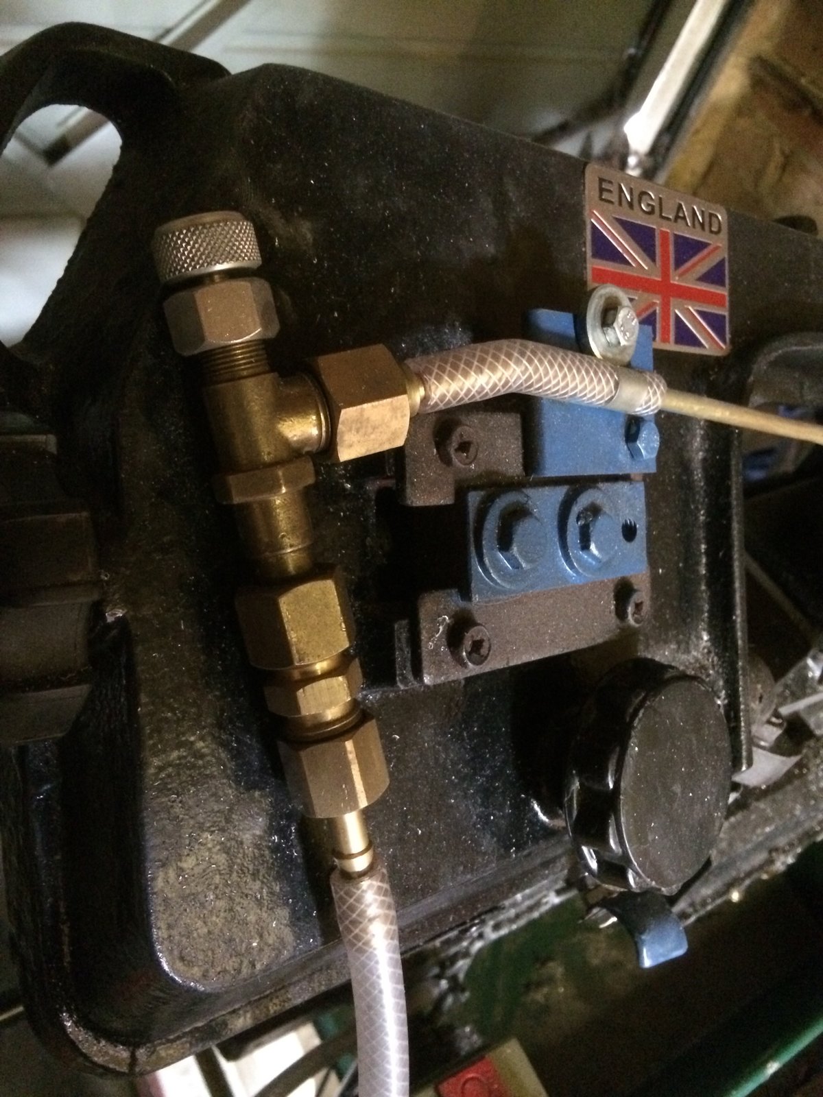

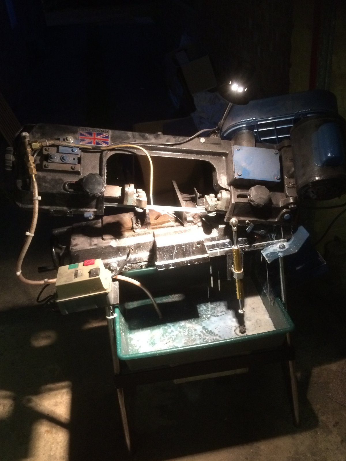

This my old thing.

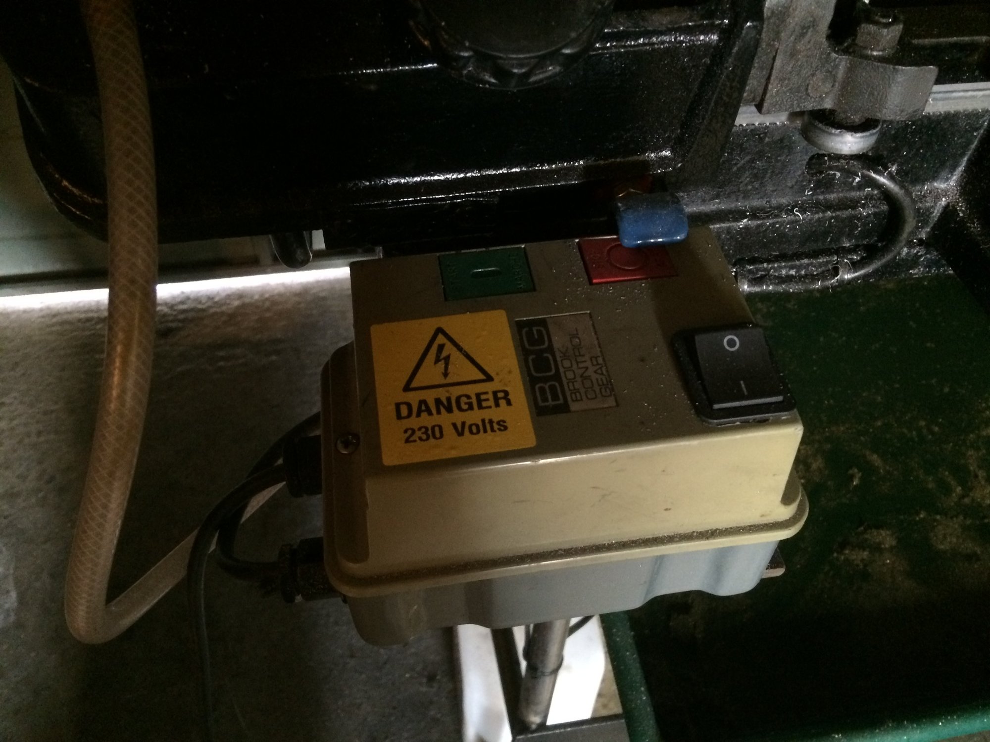

See the black switch on the panel. That’s the switch I fitted on the feed to the pump. So I have the control to dry or wet cut.
The suds feed tube on the top bow I’ve butchered an old flow meter and used the valve as a means of flow control.
