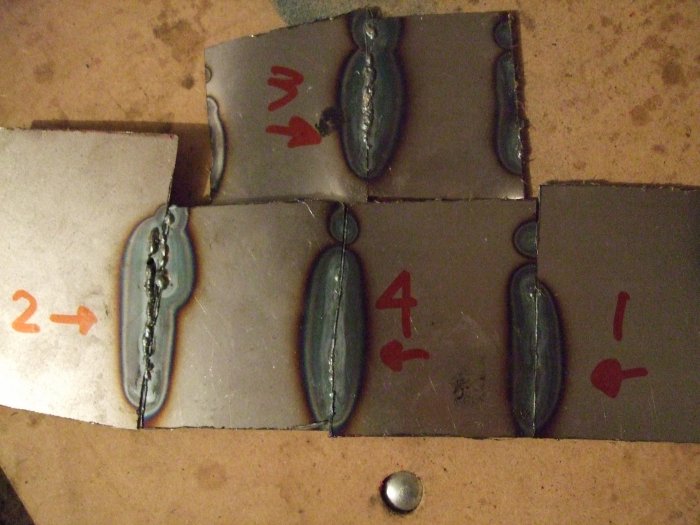

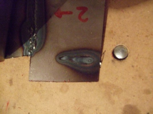

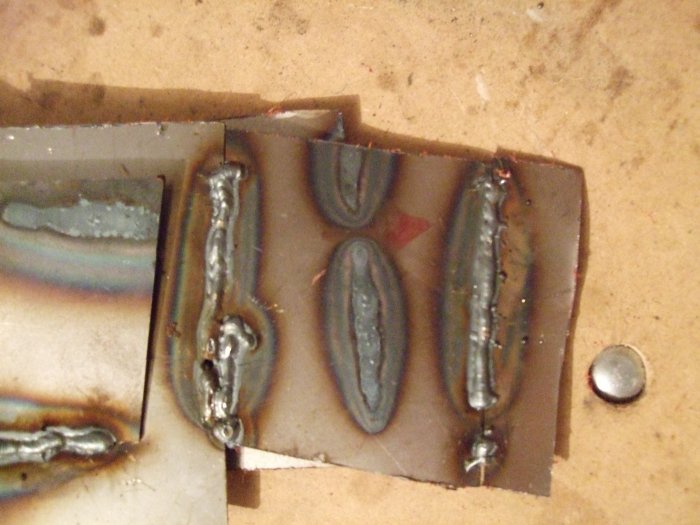

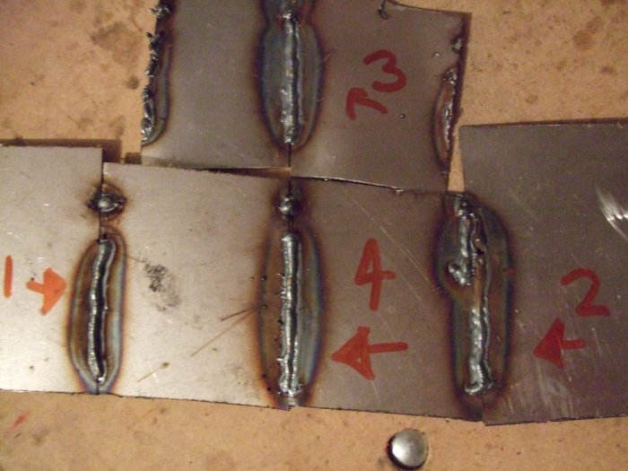

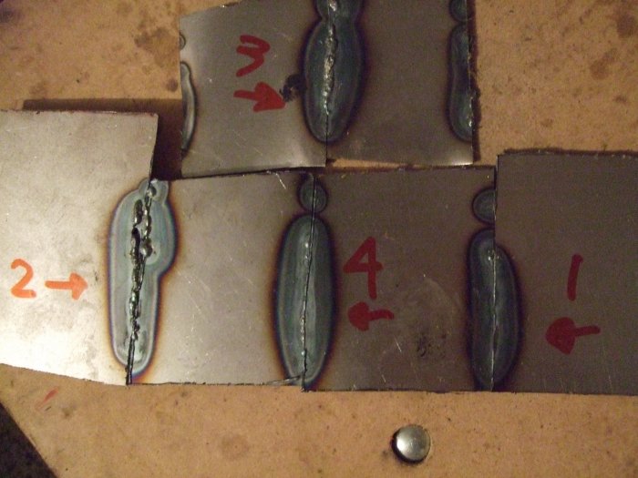

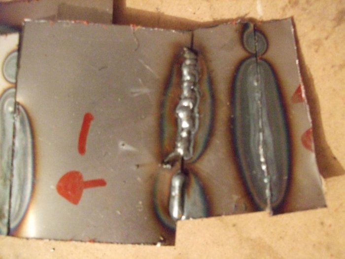

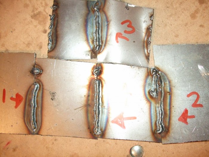

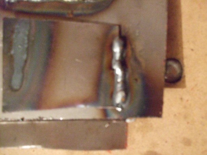

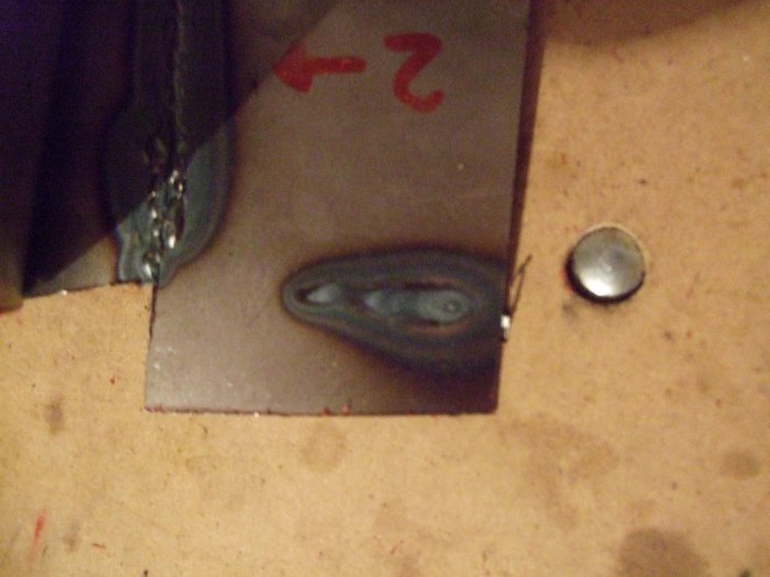

Weldinator, that's a great improvement. Well done.
As Gav says, the best practice is to try jointing material - fillets and butts. With butt welds it's invariably worth leaving a gap between the pieces to allow for full pen. The thinner the material, the less gap required. For example I'd never have a gap less than 1mm, even for 1mm material. For 2mm material a 1.5mm gap, maybe - but it depends on your machine settings and travel speed. Do some experimenting if you feel like it. Your test pieces on plate don't reflect what really happens, inasmuch as you're getting penetration through solid steel - which you don't want. It is what you want in a welded joint though.
You're obviously getting the hang of adjusting voltage (the steps) and wire speed now, plus becoming familiar with manipulating the torch. Keep it up!
Finally - when you do weld up the car, don't grind off any weld unless it's cosmetic - it detracts from the strength of the weld and unless you're sure your welds are full penetration, can lead to cracking very quickly.
