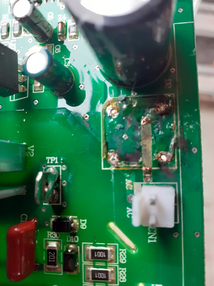

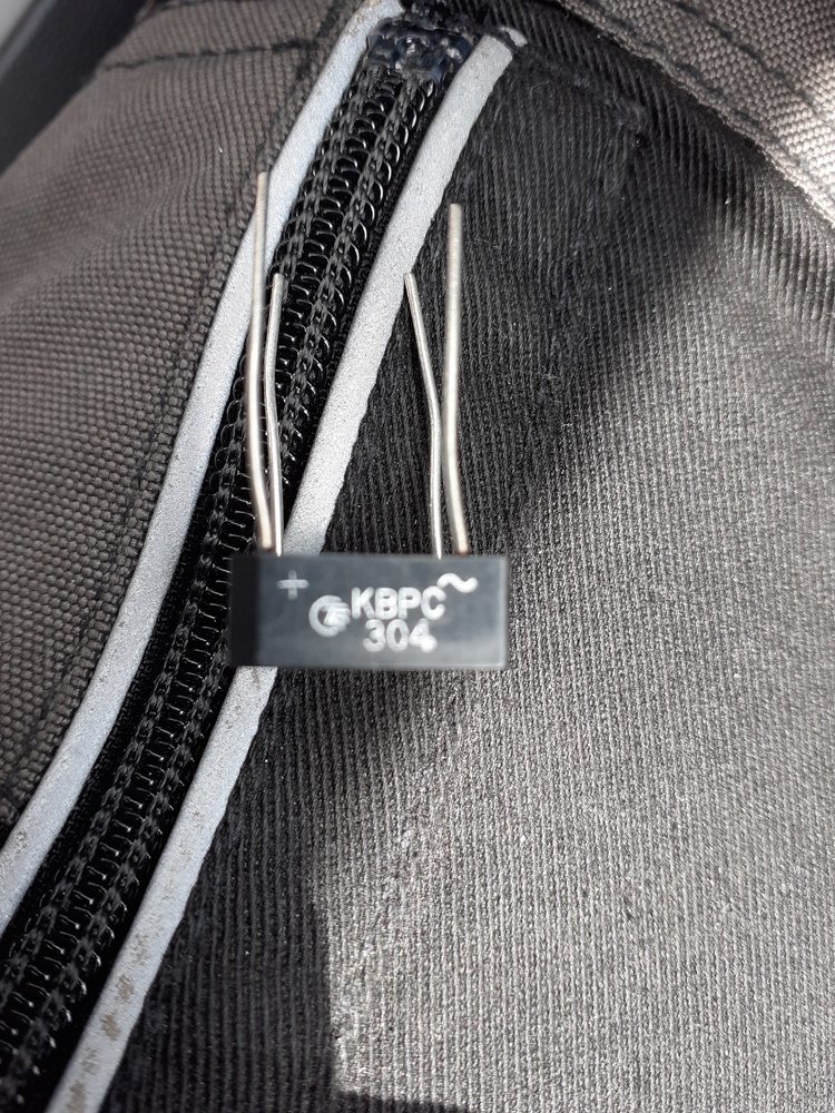

Was in Potts this morning for some t5 fuses - £45 later Thanks guys, i think ill keep as is and see how I go, just want to do a few bits on the a car. Just been to potts and they have sent me away with this :
No, it's *never* the motor.Ok ill grab another couple of rectifiers and give this a bash, you think that possibly the wire feed motor could be causing this?
I don't know what is causing the rectifier to burn out. Initially I thought it was related to the polarity swap, since the first time it happened was just after that action. However, it could be just a coincidence, something else has gone wrong.you think that possibly the wire feed motor could be causing this?

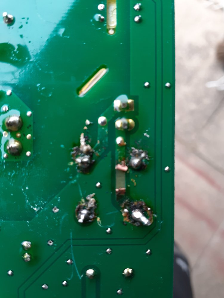

Yeah, hoping thats all that would need to sort it, strange its blown both sides but im on it so fingers crossedAre we looking at a blown track here?
If so, a copper wire soldered in is the fix.
