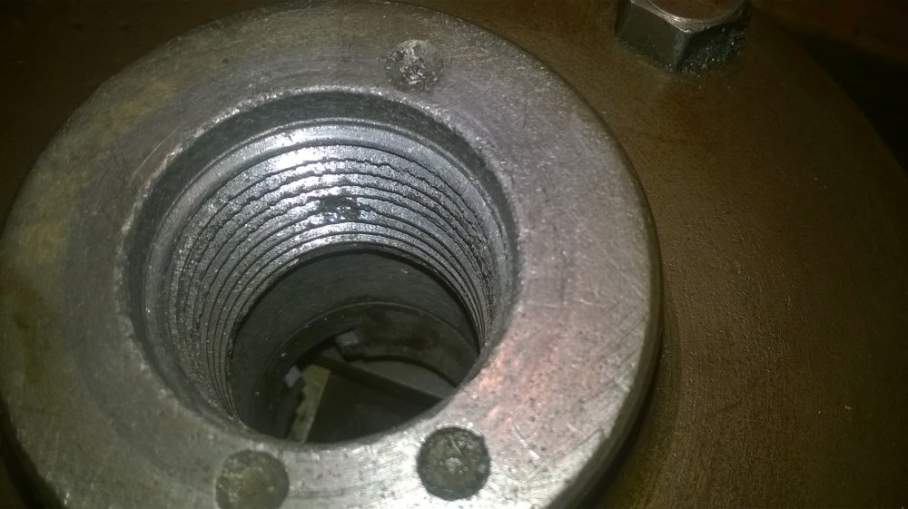

It took me four months of playing , cleaning with scotch brite green scrubber & WD 40 to get things clean and moving & learning how to set the lathe up correctly .

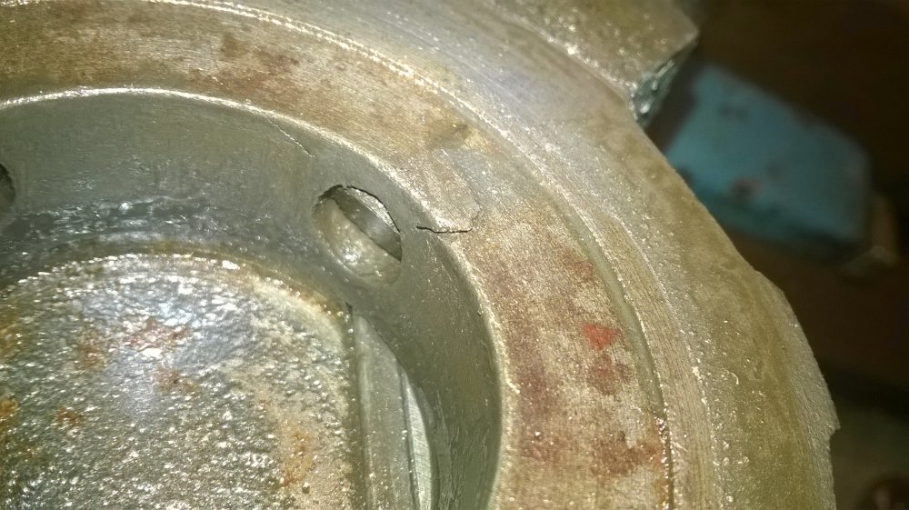

My tight chuck was solved by soaking the area of the chuck & spindle in WD 40 for three days night & morning , then putting it in drive ( motor unplugged ) inserting a 2 foot length of thicik broom stick across open jaws sot was on one and stopped by the other bringing it just above horizontal then giving it one sharp wallop with a three pound rubber hammer on the end of the broom shaft . Others have said put the biggest Allen key you have .. if it's less thant 1/2 inch AFf it's not a lot of use even if you slip a power bar/pipe over the end and wallop it . Untill you have loosened it don't go puttingn the chuck key in the hole and walloping nit for you may well shatter brak out the edge of that jaws drive screw

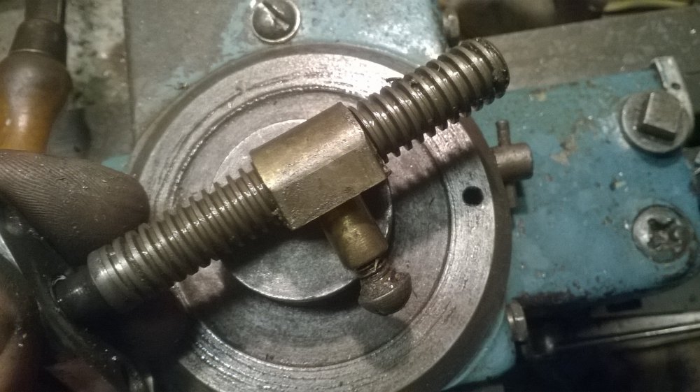

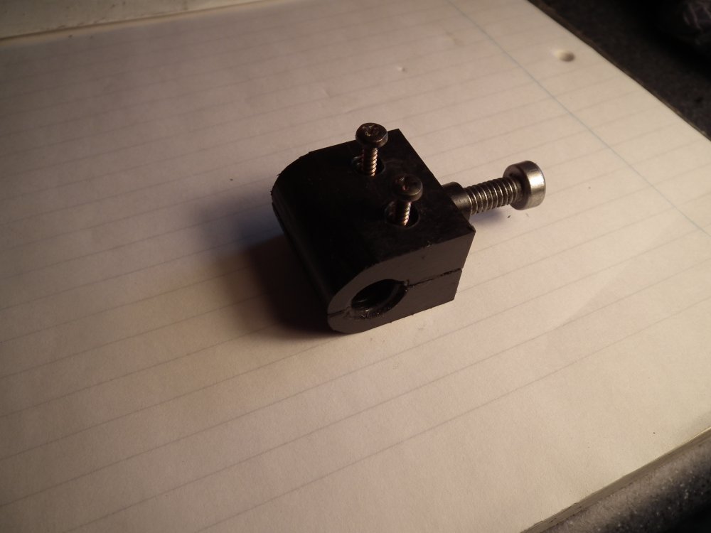

. Delrin sounds interesting option to keep a worn screw going but with same problems as above? edit... Nice link Henrik - it suggests slop is not a problem with these nuts but we don't know how worn out the guy's threads were...
