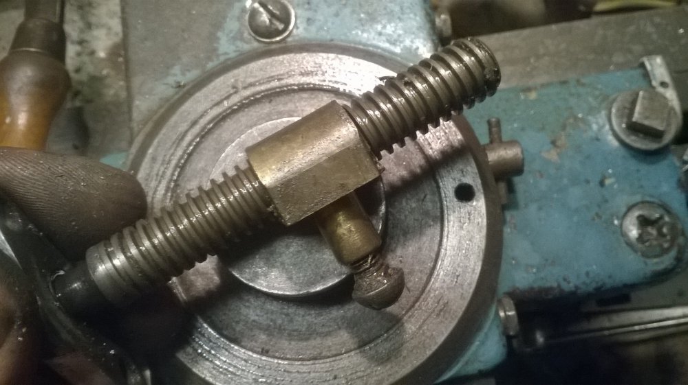

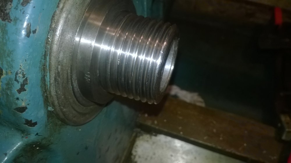

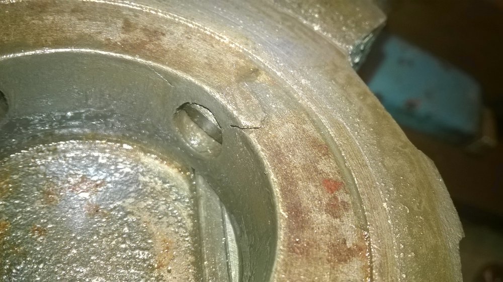

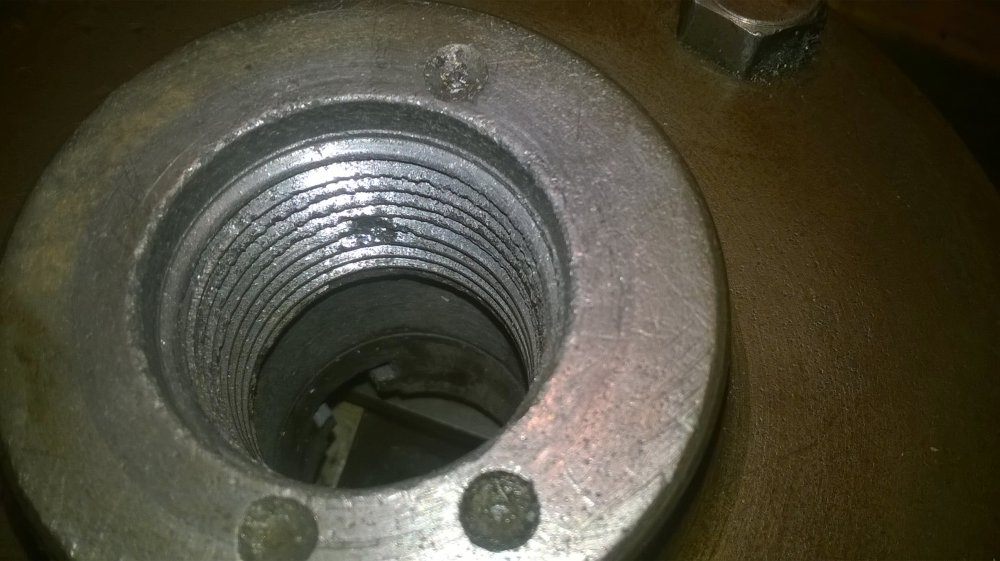

Phew! A lot of things to consider... as I wasn't looking for a lathe when it was offered to me I feel I've done ok out of the deal. Had a knackered lathe to mess around on, got to make a few useful things over the years & get chance to buy it. I've known my late mates family for nearly 20 years. The prices I've seen lathes fetch (on ebay) is always higher than I expect or are miles away - not easy to check over. I'm not in the engineering world & have no contacts for old gear at cheap rates. With all the advice I'm getting here it seems the Atlas may be rescuable. Especially having looked at Henricks long term resto' & other dilapidated lathes, seems it can be done.
Gritineye & Ford 34/2 I was thinking along those lines - shimming. Something I've done setting up magnetos for backlash. Just wasn't sure how acceptable this is lathe wise but any improvement over current state has got to be good. I don't like to watch drill bits squirelling about so off-centre =0 (that's eek!) I'm unlikely to be making anything very hi-fi; just the odd bush or spacer. If I could true up a brake drum that'd be good. Last thing was a nylon adaptor for my bro's non-std bathroom basin tap.
