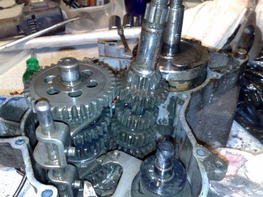

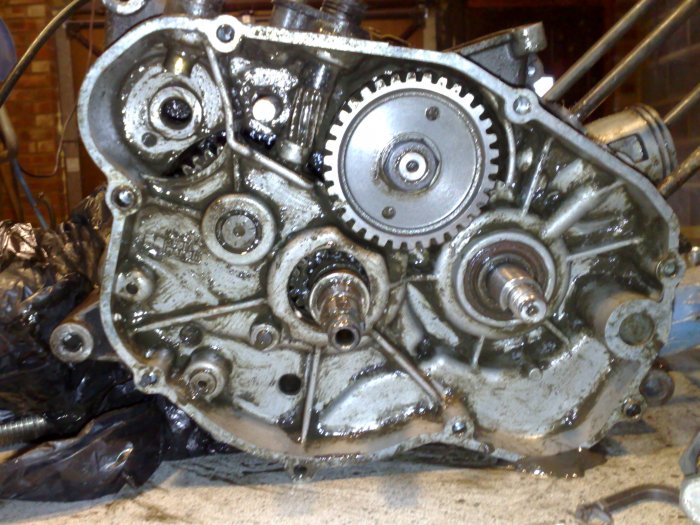

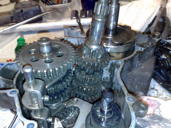

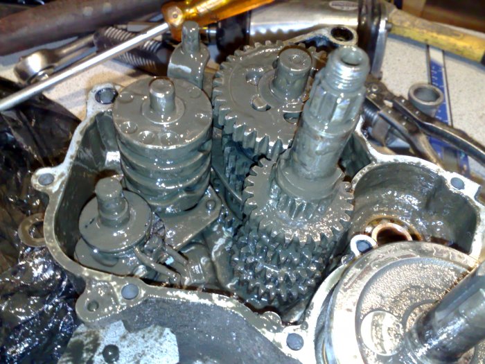

All answers welcome and appreciated ,still waiting for a delivery from aprillia ,most bearings have been bought thru simply bearing and cost 50% less than genuine ,skf bought,,there was 1 unusual seal and 2 dificult to measure bearings so i opted to get them direct ,and am still waiting for them!only found silicone sealant at home so will wait for my return to work and see whats available there as i don't really like silcone ,too sticky when dismantling for my likeing ...thanks again Gav[/QUOTE
Buy a decent sealant £10 is not bad for three bond worth every penny and it stays where it is put not like silicone and will start to leak, some silicons do not like petrol.
I used to split the crank cases every four meetings just to give it a good seal again a two stroke relies on good crank case pressure to work properly.
