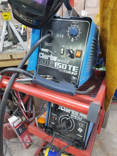

Thankyou,It is Andy apart from mine is the older blue case![]()

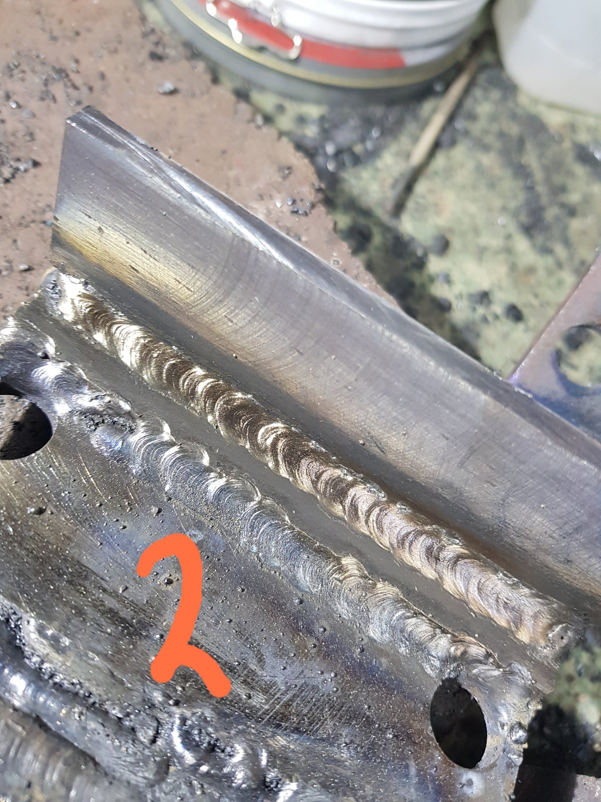

that top weld is looking good mate your sure improving, try stacking your runs when you got good beads of weld, also on a side note is this your mig welder..

ok 2 good welders your arc welding sure seems to becoming along, the videos I added are some of what I've watched over and over again, also are you still on 2.5 rods...This is mine.
I've practically learned how to stick weld watching chuckE2009 and weld.comok 2 good welders your arc welding sure seems to becoming along, the videos I added are some of what I've watched over and over again, also are you still on 2.5 rods...

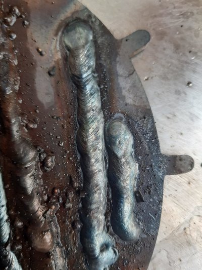

Yes I have seen alot of wed.com vids and I have seen those except the last one on 6013s which confirms what I had to do giving more angle to keep the slag out of the pool.here few more good vids
all in all you sure are getting it tho so keep at it..
you will get there in end, as can see improvement all ready ..Yes I have seen alot of wed.com vids and I have seen those except the last one on 6013s which confirms what I had to do giving more angle to keep the slag out of the pool.
keep at mate or you thinking of getting a dc set..Hi Andy
I have run a few more welds And starting to get more consistency but not yet to the stage I could go strait in on a part and get it right first time.
Rods aren't that expensive so I will keep practicing whenever I can.
I have just replaced the bottle for my mig and have been practicing with that also.
I have to say I seem to get a much better looking weld with stick.
For the moment I think I'll try and conquer what I have.keep at mate or you thinking of getting a dc set..
