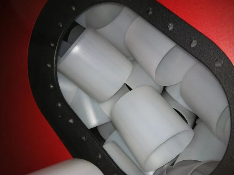

I think slosh I causing poor running in my trials buggy. Certified foam is about £70. These guys sell generic PU foam for much less, which they claim is good for tanks among other uses. I've queried this with them and they're double checking with the manufacturer. In the mean time I thought I'd ask you good folks. £70 may not seem a lot but when every step of the build costs you this much or more it's got cumulatively expensive...
www.thefoamshop.co.uk

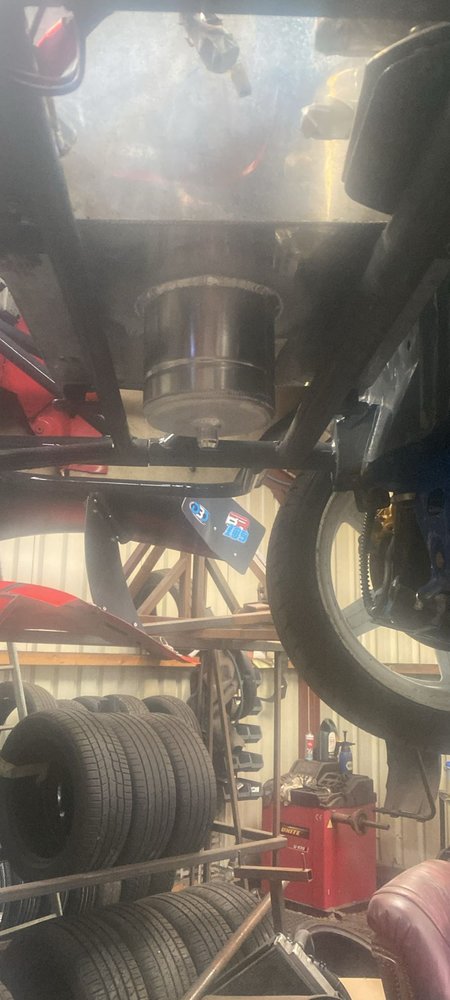

More info:
✓ 300x300x200 alu cube fuel tank with gravity outlet at the bottom
✓ No baffles, tank is void inside
✓ Tank has rally style port which can be removed to give good access to inside tank
✓ 15mm outlet hose leading to a coarse pre filter, then 044 style fuel pump, cartridge filter, then plastic 8mm hose to engine
✓ Pressure regulator on fuel rail then 6mm return to tank
✓ I think the pump is too powerful as well as the return flow is very high.
✓ The exact pump is a 6106539 as fitted to 1.6-2.8l old Fords. Output is roughly same as the pump originally used with the engine, and same 8mm/6mm hose diameters so not sure why the return flow is so high.
✓ Buggy uses 1.6l Vitara EFI engine
QUICK DRYING RETICULATED FOAM
Reticulated Foam: High-Porosity Innovation Welcome to our world of Reticulated Foam, a specialist open-cell foam with unique characteristics. Reticulated foam features a net-like cellular structure, allowing water to drain rapidly through its large pores
