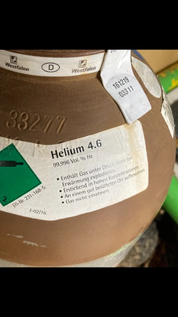

You mean DC- / DCEN.no one mention DC + with helium yet for thick stuff
never tried it as i almost fell over at the price of pure helium
Nitrogen no good. Have you ever welded with a nitrogen backpurge? Plays havoc with the arc.Here we got balloon gas with 95%+ Helium on most suppliers.
Linde is going to 99,5He +0,5% N2.
