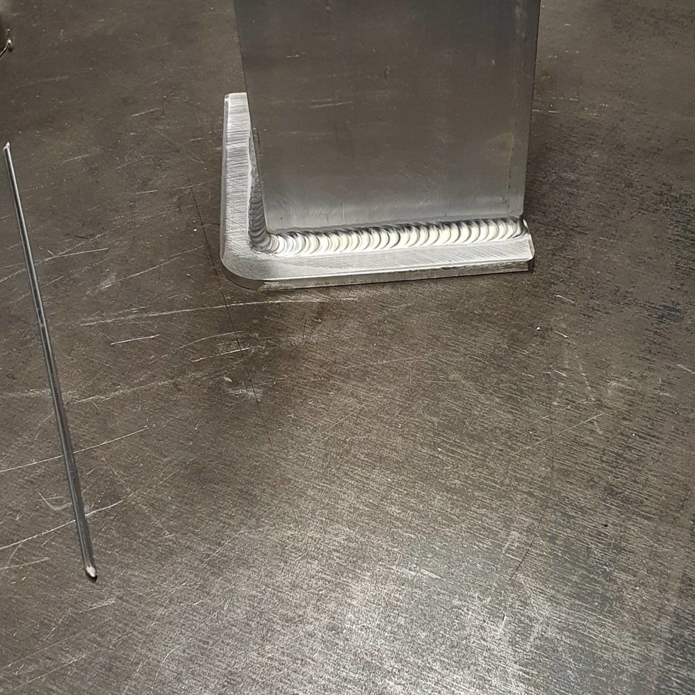

I can't help.... but I'm admiring that lovely-looking weld!Hate the thoughts of having a bottle hanging around doing nothing but every now and then I think about getting a bottle for the odd jobs I get View attachment 318776View attachment 318777 got away with it here but there's been a few I've not been happy with, anyone tried it

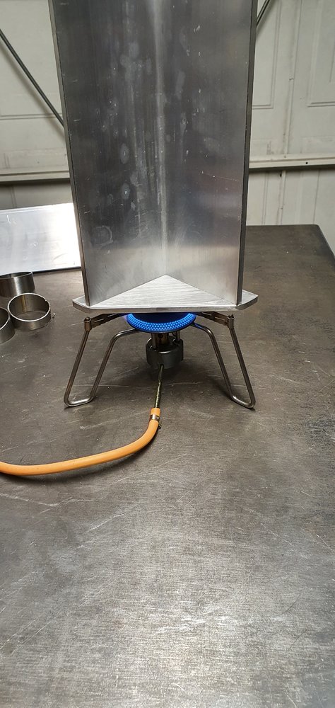

I'll post a photo of the other part that 220 amps just wasn't enoughI can't help.... but I'm admiring that lovely-looking weld!
