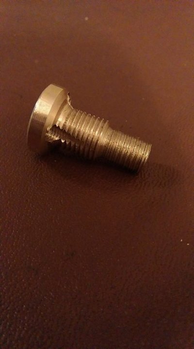

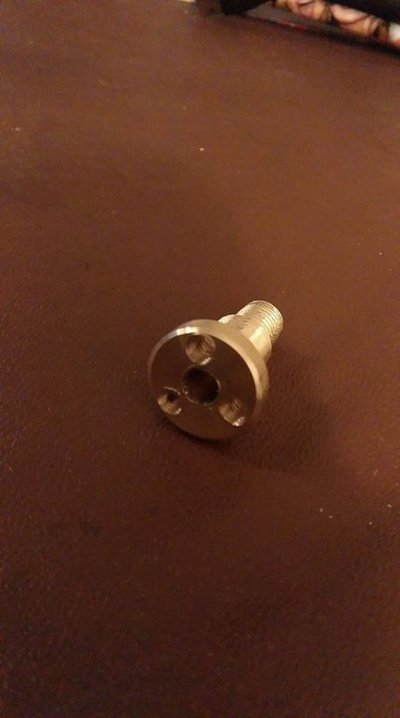

I've given up with that for now, the neck was made of an OA welding tip which I threaded and screwed into the head, but I stripped the thread so I'm leaving it for a while. (1/4"-20 thread on copper was never going to be strong)Bet he's made 2 for a reason. One for you and one for his home made tig torch.
Waaaaaaaaaaay better than I could do too mate.I think it looks bloody brilliant personally. Far far better than I could do with twice the kit.
Just has to be M3 unfortunately as I'm an awkward sod like that.
.I'm not really sure why it went wrong; every few passes the tool would align with the top of the thread rather than the root and would You should only have to do this on threads with an odd TPI, these are both 24 TPI so it shouldn't matter, yet it did.
