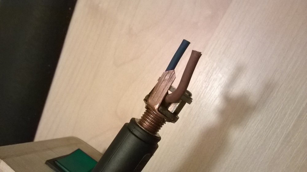

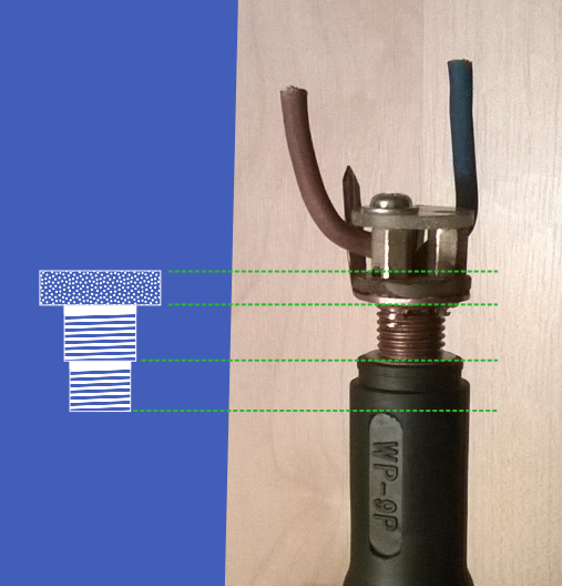

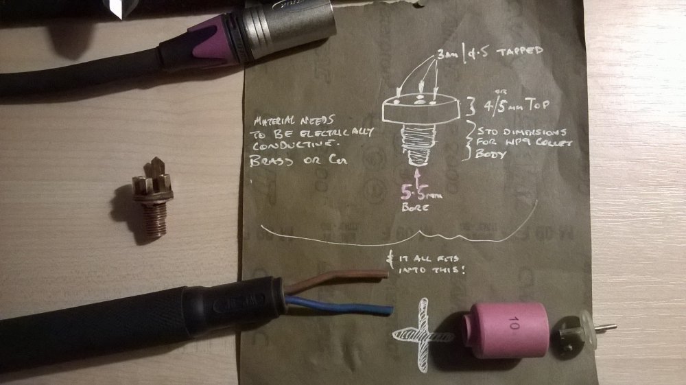

Could anyone help on this please? Happy to pay beer tokens or whatever for the assistance thanks
I'm after a part made. It fits into a WP9 TIG pencil torch body that I've re-purposed as a wand for a pyrography set I'm making (yes still).
A picture speaks a thousand words and all that. Here's a go I had by TIGing a copper plate onto a collet body with Cu cable as filler and a couple of attempts at drawing what I'd like made (yes I suck but I'm not an artist so ):
Oh and @Richard. - this is the copper TIGing I was mentioning.
