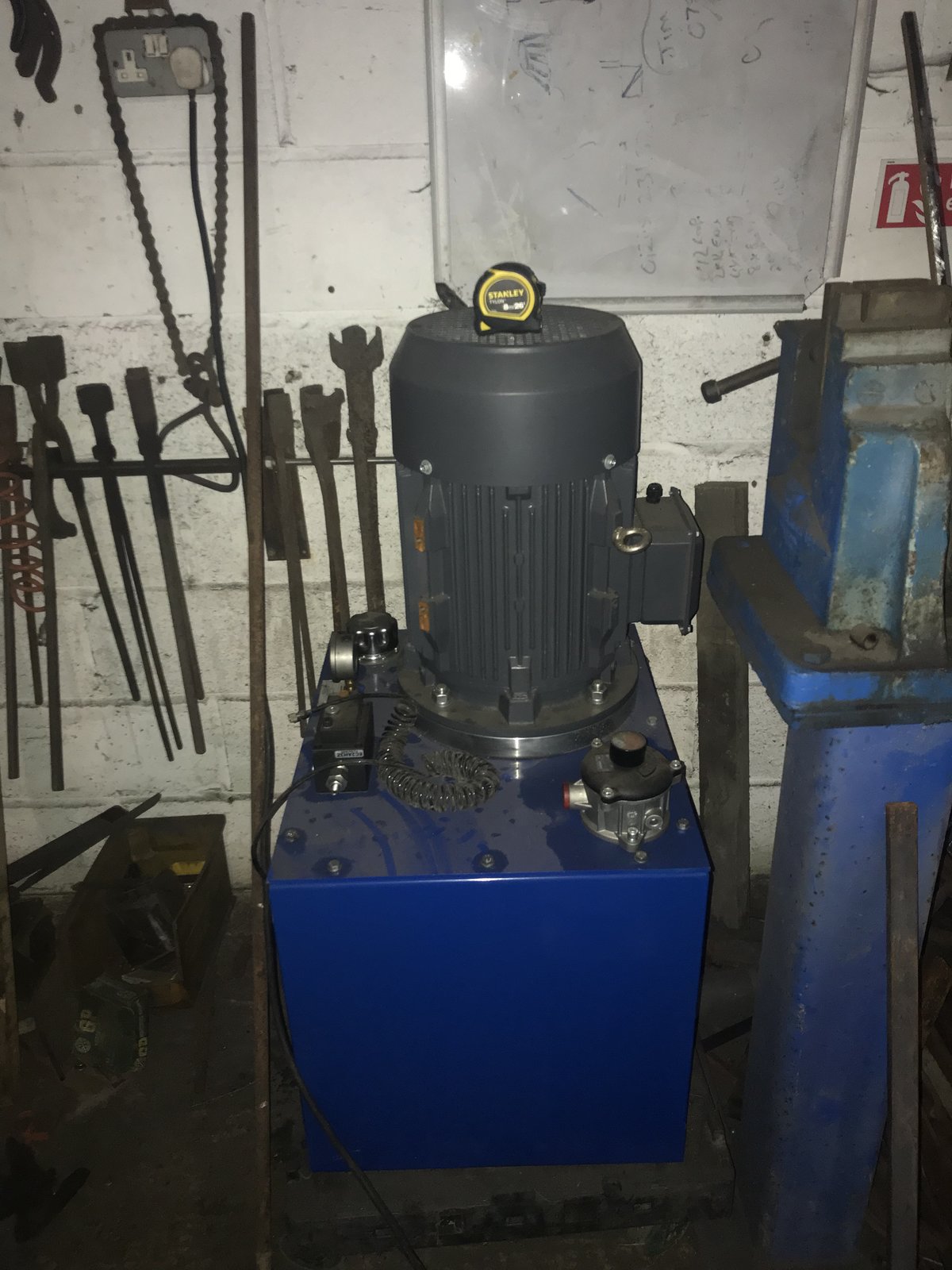

Brad, Are you using a accumulator to achieve hydraulic flow speed.
When you designed it did you use yield strengths to work out structure as I’ve seen some mess ups when they have uts for working out csa of stress members
It’s a lump n half. There won’t be much it won’t break once up and running.No calculations done to be honest mate we are not structural engineers, we have used 250 x 100 x 36kg PFC think it’s S355 for the uprights, 15mm S355 for the base plate, 25mm S235 for the top.
I think we should use something like S690 or Strenx.
If it breaks we will rebuild
No idea about the pump, a hydraulic pump company supplied it for the application.
Richard has seen it, it’s a lump.
No calculations done to be honest mate we are not structural engineers...
