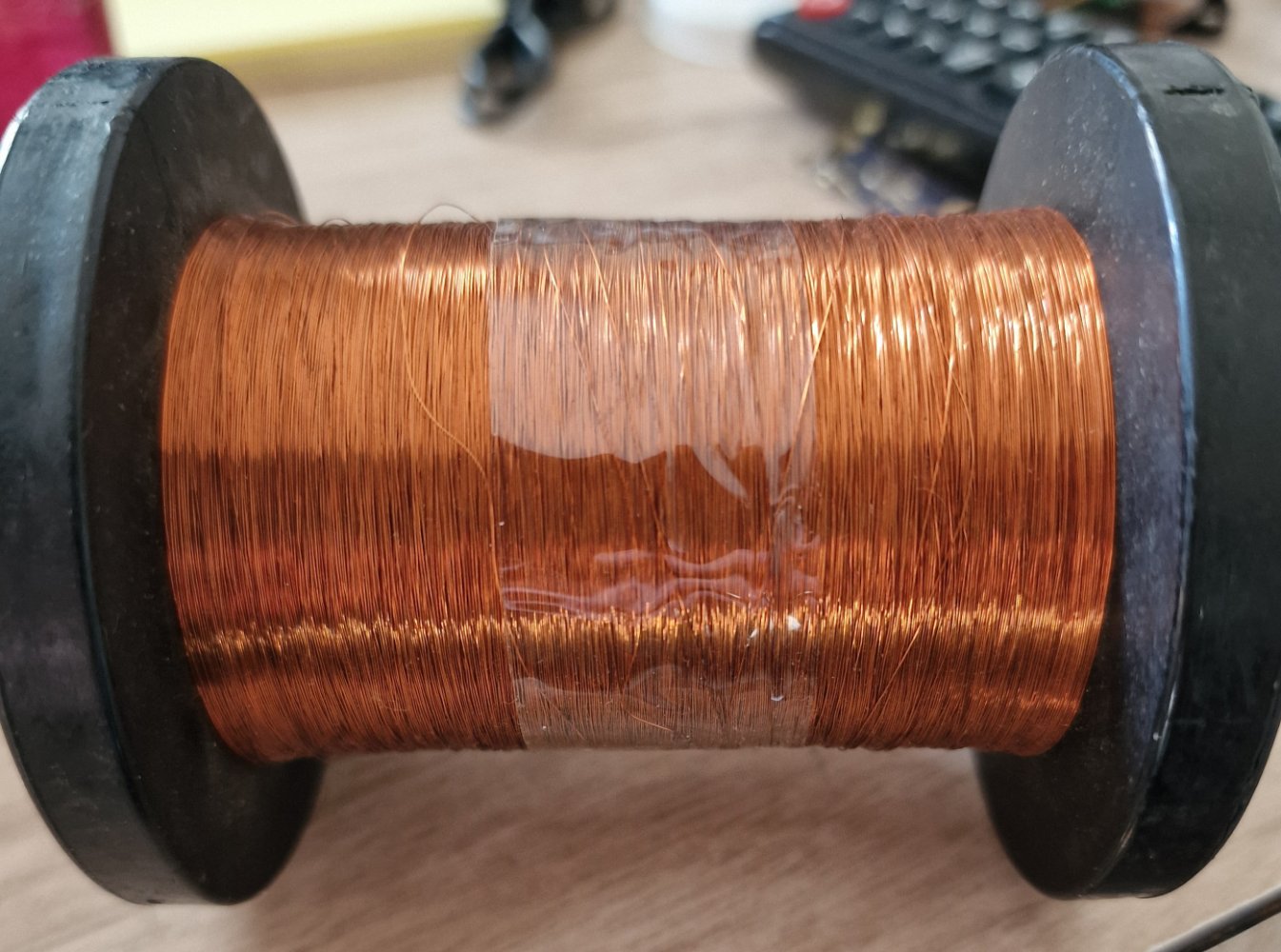

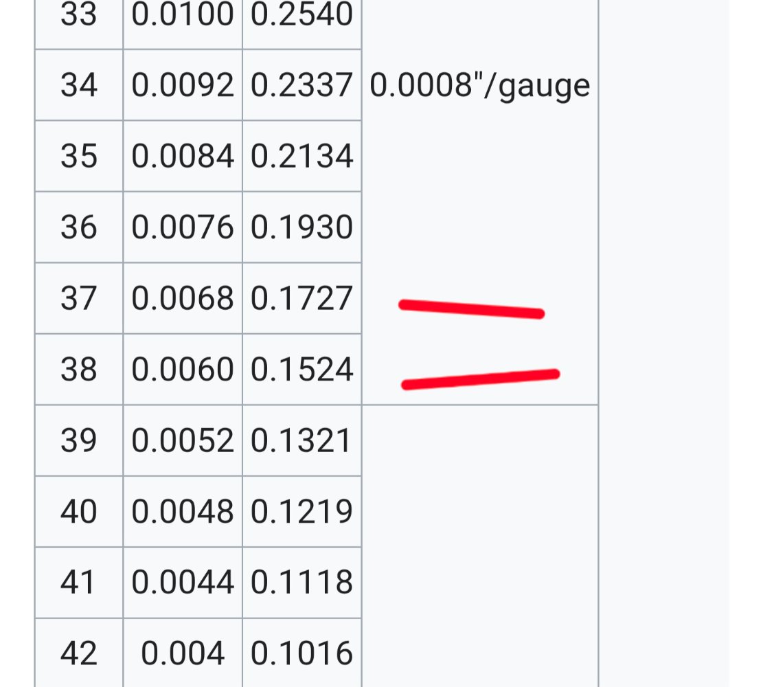

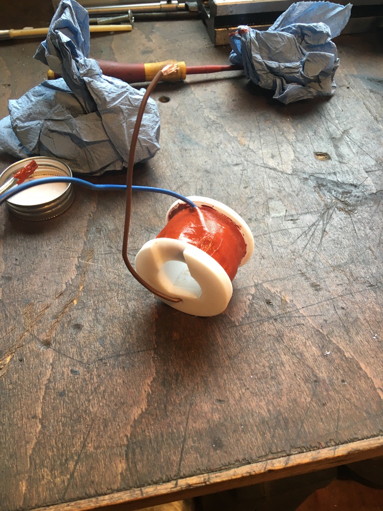

I don’t think there much laquer left. I gave it a scrub with a scotch brite pad before measuring. I’ll try a flame on it tomorrow night and see if anymore comes off. It’s very close to the 0.16 size that brocott stock. It’s a German machine. Not sure if that makes a difference when it comes to wire gauges?Is 0.165 including the lacquer?
It sounds like 38swg which I think that I have.
