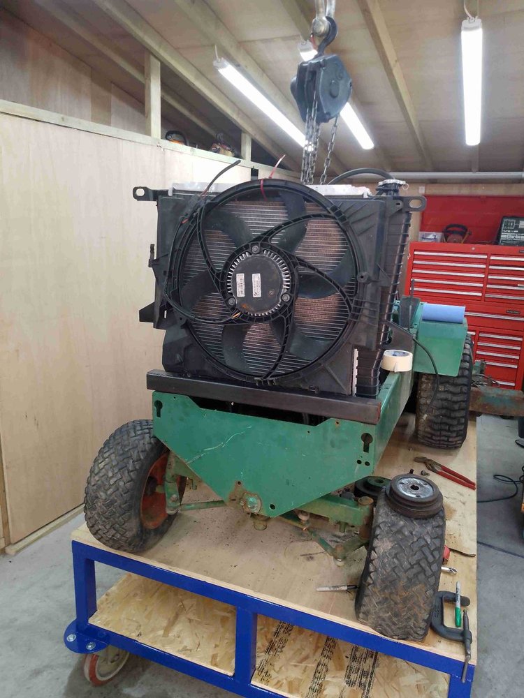

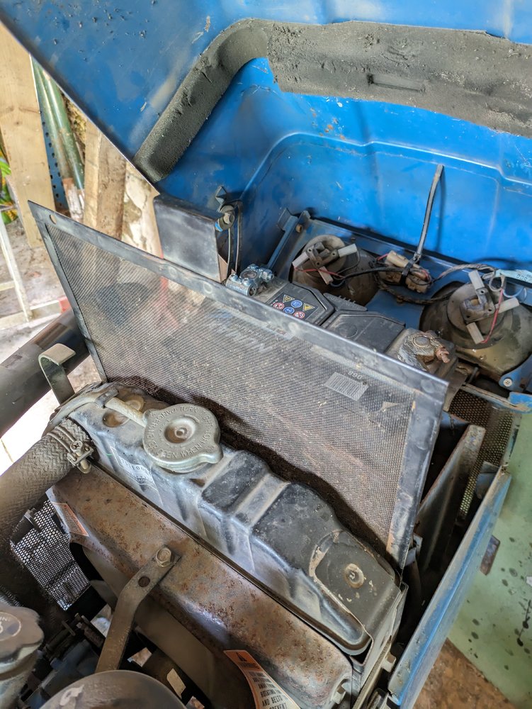

As regards the radiator connections, in my 205gti stock car I had the rad rear mounted where the back seat was. I connected the bottom of the rad to the outlet just above the driveshaft carrier bearing & the top of the rad to the thermostat housing with all other ports blanked off. Never had problems with overheating over many seasons of racing.
