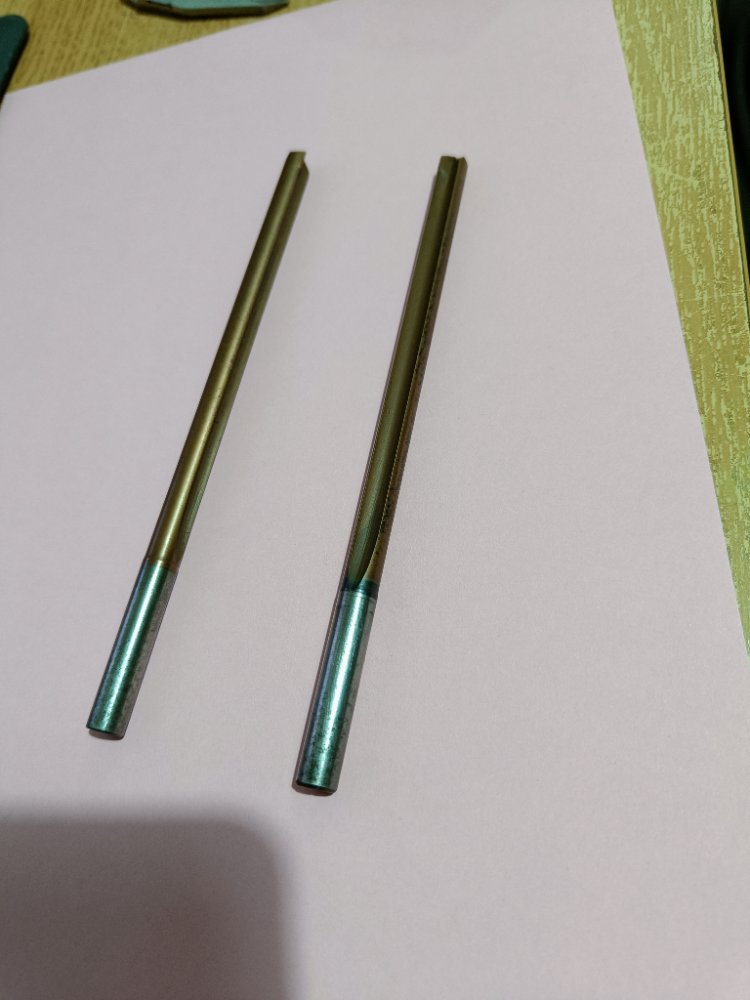

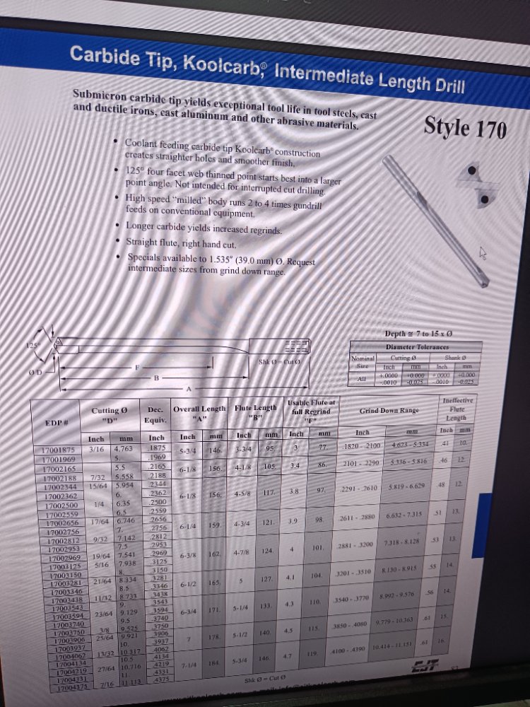

I must say I have gone off the "cement" pouring option, simply because drilling through it is likely to be a nightmare, and will epoxy provide a sufficient "guide" to stop the drill from wandering?
