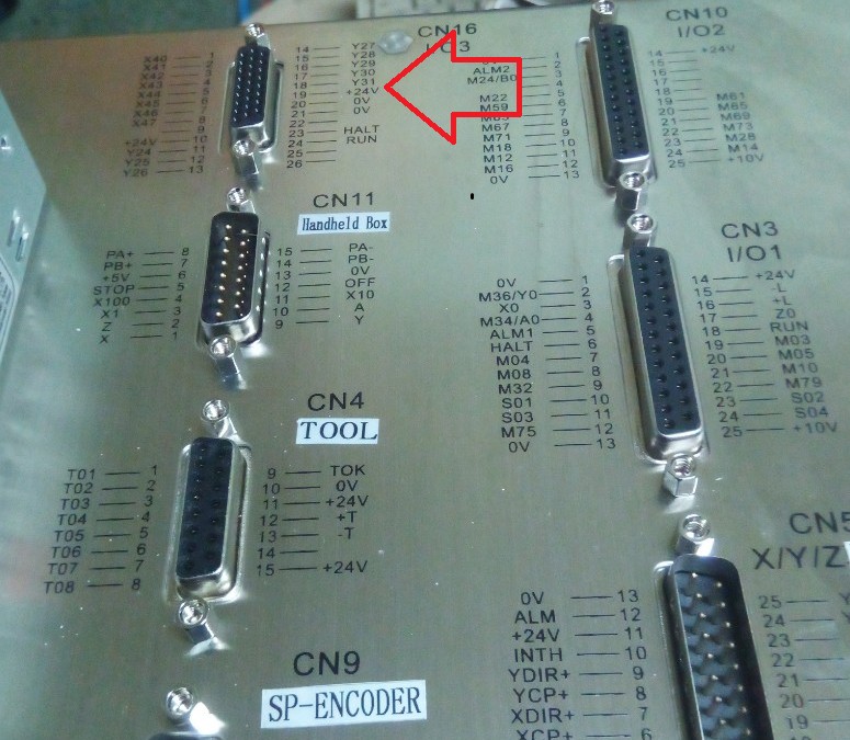

My new Chinese CNC control uses one26 pin HD d-sub female gender used as plug... would have a mating male gender socket on the corresponding equipment. Pretty old school, as I haven't seen anything similar since the early 90s in even rare usage. Usually found on high-end CAD monitors and old UNIX workstation video connectors, plus some old HP kvm switchboxes. Found some "common" pinouts at https://connector.pinoutguide.com/26_pin_hi-density_D-SUB/.

It seems excellent so far.

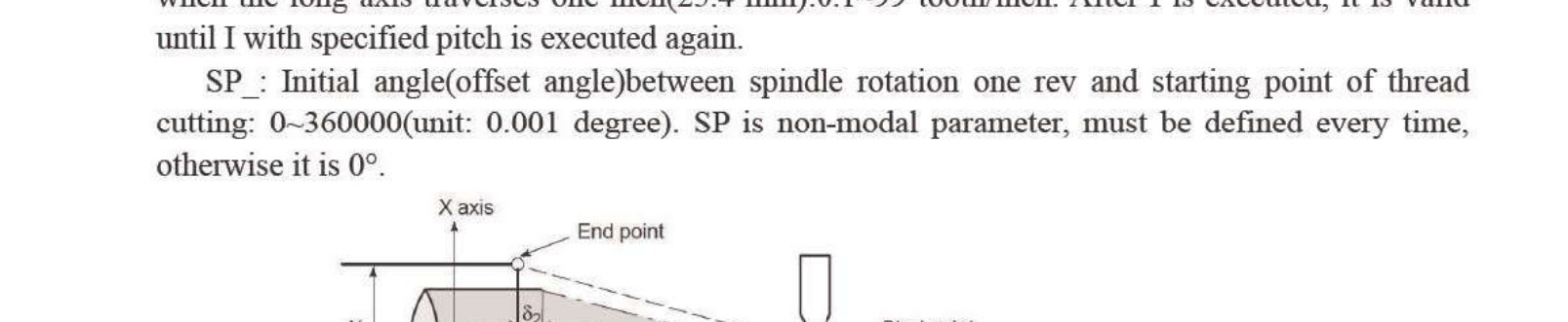

It has G32, G76 and G93 so it may be a possibility but I have never looked into it.

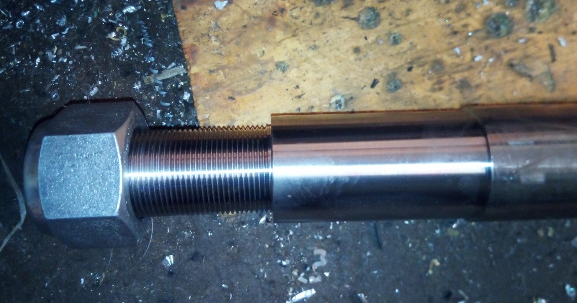

It cuts threads beautifully, have only done a few but this was one I did the last day, 1 1/2" UNF on some 316.
Never had a problem whether on the manual or the CNC, I do however, nearly always, use carbide full profile threading inserts.Thats clean, i've cut threads in 316 and they were raggy no matter what i did.
