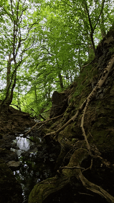

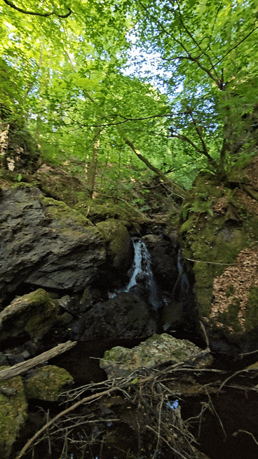

I mean I was originally thinking of just doing that since this stream is literally one of several in the area feeding a larger river from a loch so the amount of flow going through it is barely anything compared to the others and it goes down a deep ravine so isn't used by animals or accessible by anyone so it wouldn't be causing any issues plus there is no fish or anything alive in the water apart from bugs/insects and I'd only be tapping part of the flow and using one of the natural water pockets at the top as the intake so wouldn't be building anything/blocking the flow.DONT TELL THEM

It's basically 300m up the stream in the ravine section.is your catch point far away from the loch?

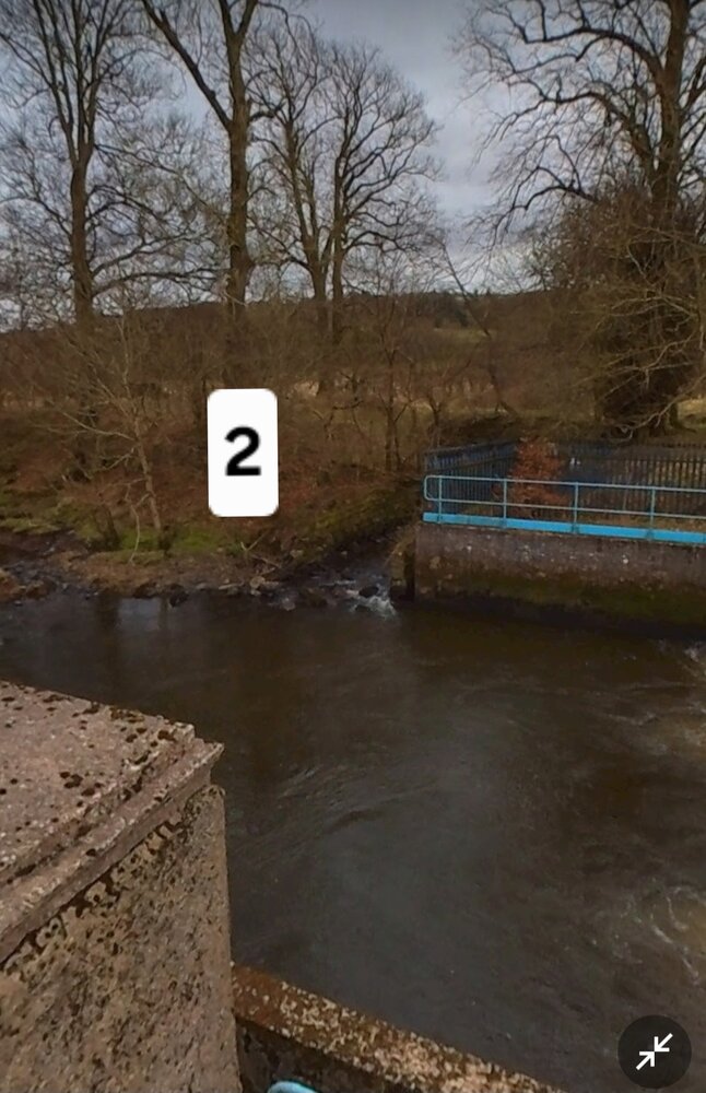

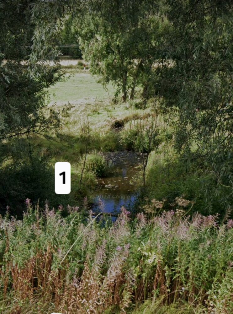

Well to update anyone interested, I've walked the length of the stream and would say there's about 40m of head over 260-300m. As for the flow checking today before the rain it was at about 4L/s and that's been a full month of dry weather so a nice baseline - it should get up to 15L/s easily in the winter.
For the piping agricultural irrigation reels just happen to come most commonly in the 90/300 which can be had for £500-600 which is the price you'd pay for 150m of 63mm pipe so a bargain for 300m of 90mm! Plus on a trailer so easy to drag up the hill with a skidsteer and unspooled down the stream and trailer can be sold after to offset some of the cost since they're pretty robust or kept and used with the skidsteer.
Being the cheapskate I am I could probably build a functioning generator all in for £500 from an old direct drive washing machine motor and just order a turgo wheel however you can buy a complete generator setup from some creative kiwi's https://www.powerspout.com/collections/turgo-trg which is basically plug and play for ~£1400 and comes with 2yr warranty so probably a better option.
Solis inverters are perfect for use with hydro setups and the company will even honour the warranty of their solar mppt inverters when used for hydro in the correct voltage range so can either do a single string inverter feeding the ~800w constantly to offset the house load however it looks like we're more likely to get a dual mppt hybrid inverter for a solar + battery setup with the Hydro providing 24/7 which should make the grid draw near 0 whilst being able to export excess as it turns out there might be 3phase meaning an 11kw limit instead of 3.6kw whilst still on a g98 compliant setup.
