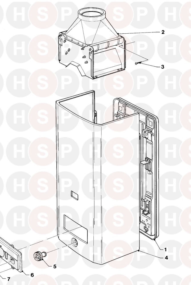

It is until you fit the flue diverter that was made for it on and then fit a flue at which point it's not flue less any more.The ops boiler is flueless
Adding a flue to it is absolute madness, modifying abs appliance way beyond its original spec
I stand by my first remark on it
