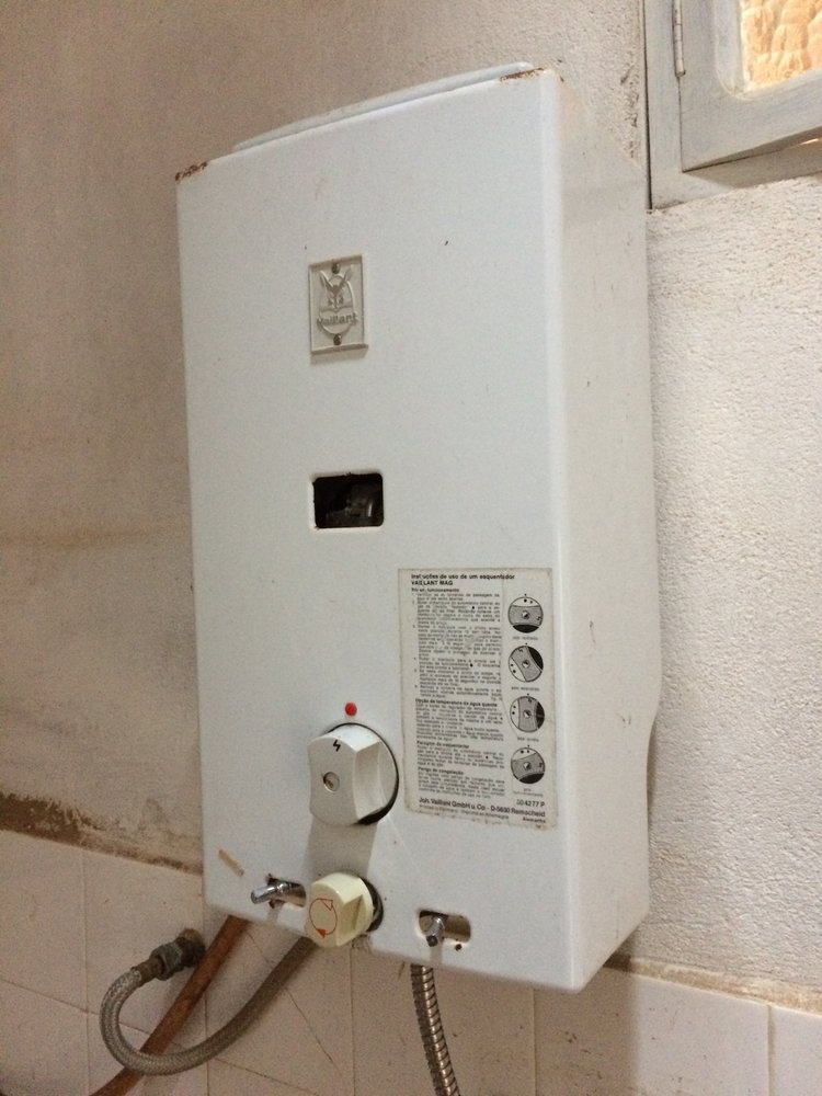

Hi folks, a bit of an odd situation, I’m trying to use an older (1980s ?) hot water boiler made by Valiant. The instructions are in German which is slightly better than nothing.
History is unknown but it’s been unused for many years. It's fed by a (25kg ?) butane bottle which seems to have gas on it ( weight compared to the empty spare, and gas flows when the feed pipe is disconnected from the regulator). None of the controls are siezed, the knobs turn ok, etc.
The system is due to be replaced in a few months but it would be handy having a hot shower working before then.
I’m aware of the safety issues but I'd like the satisfaction of getting it working before it gets scrapped.
Is there an easy way to check gas is flowing, or is there some simple "press this to start" procedure I know nothing about ?

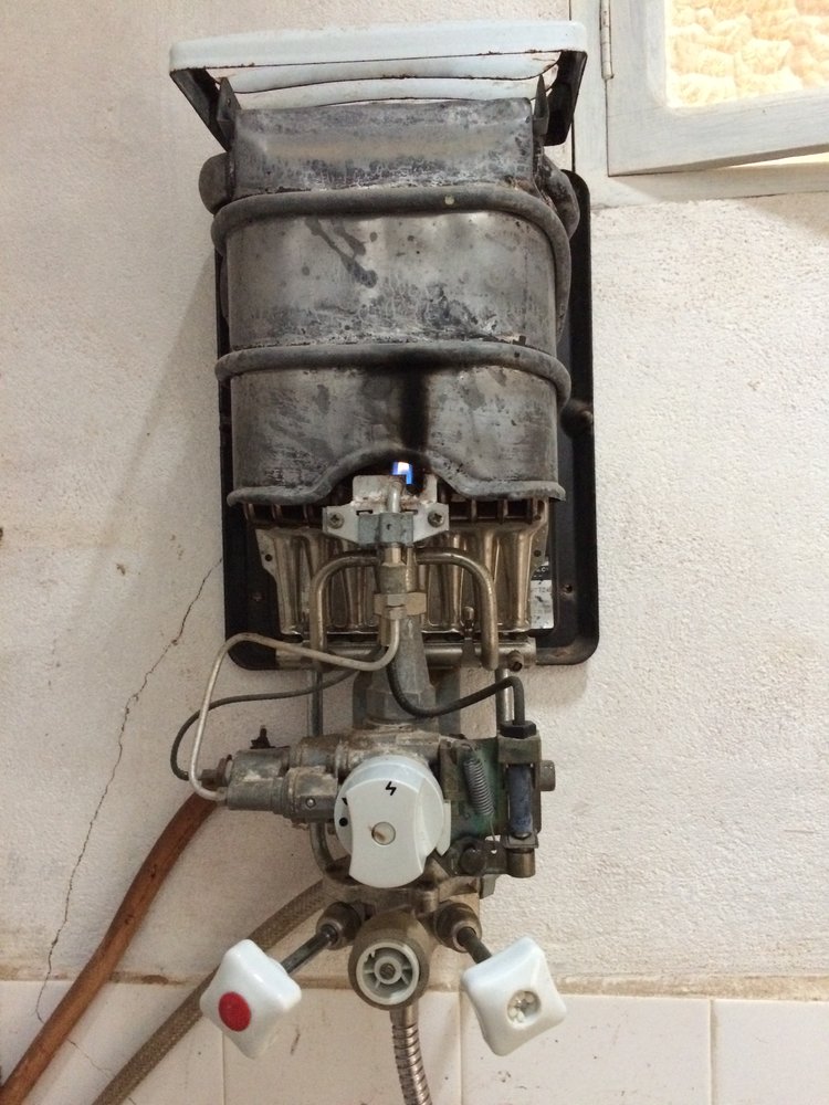

I’ve had the cover off and internals look intact and undamaged, photo before I refitted the knobs :
