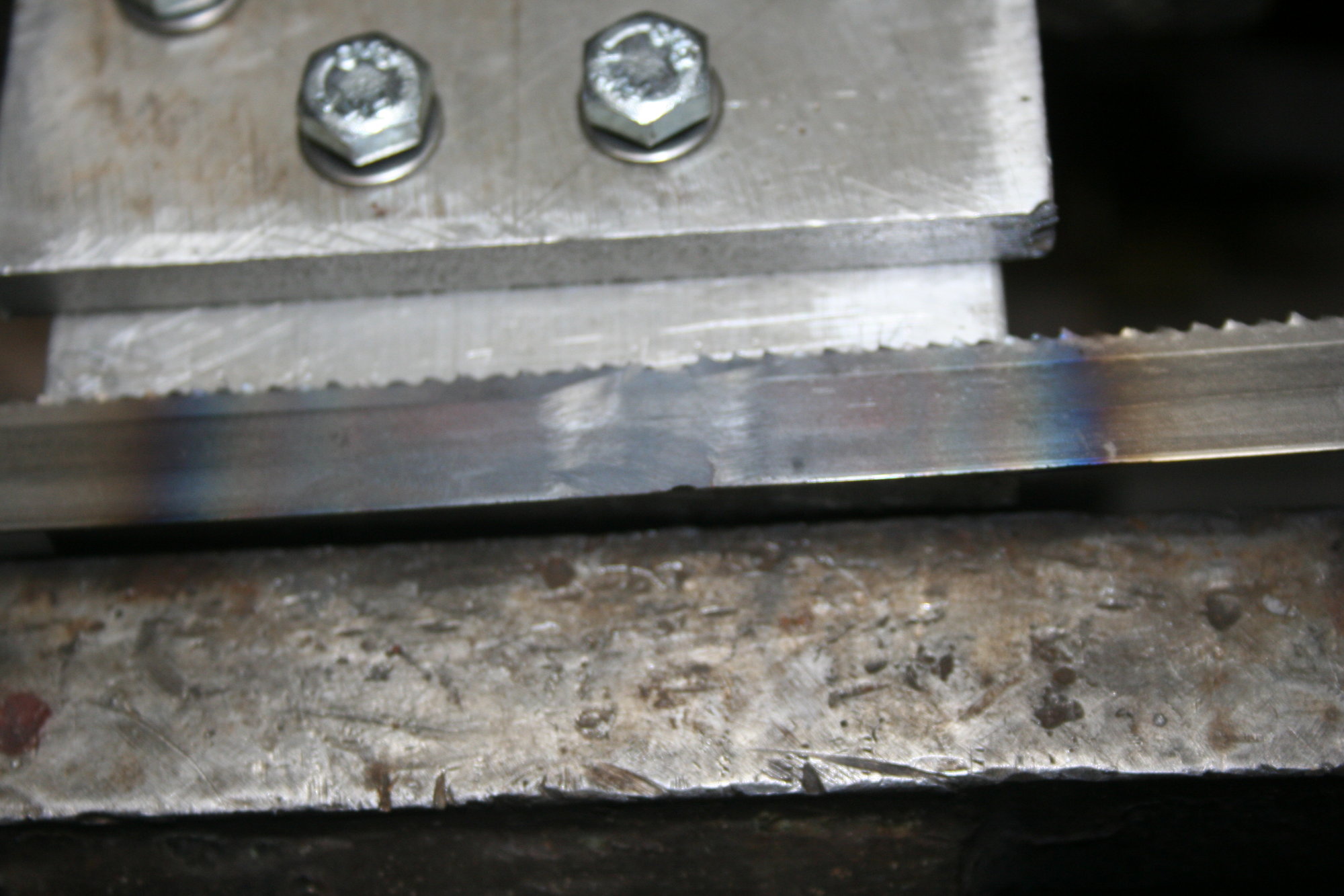

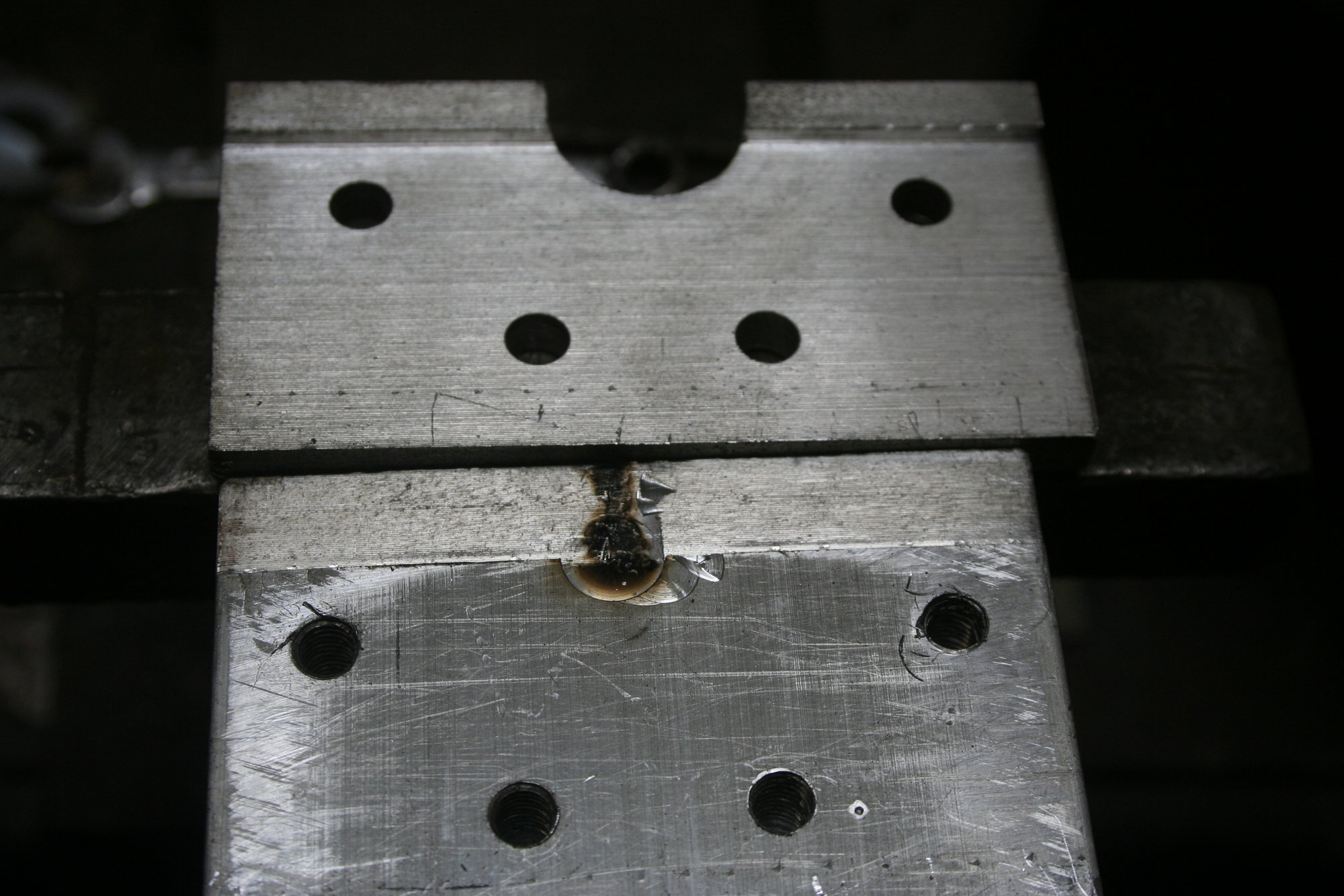

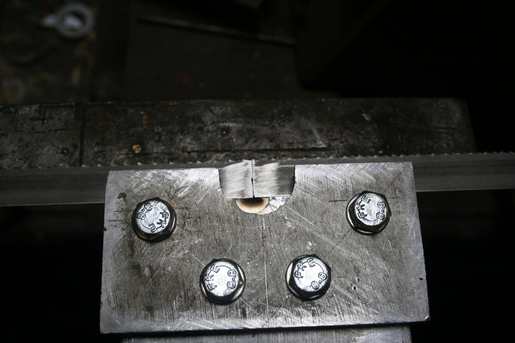

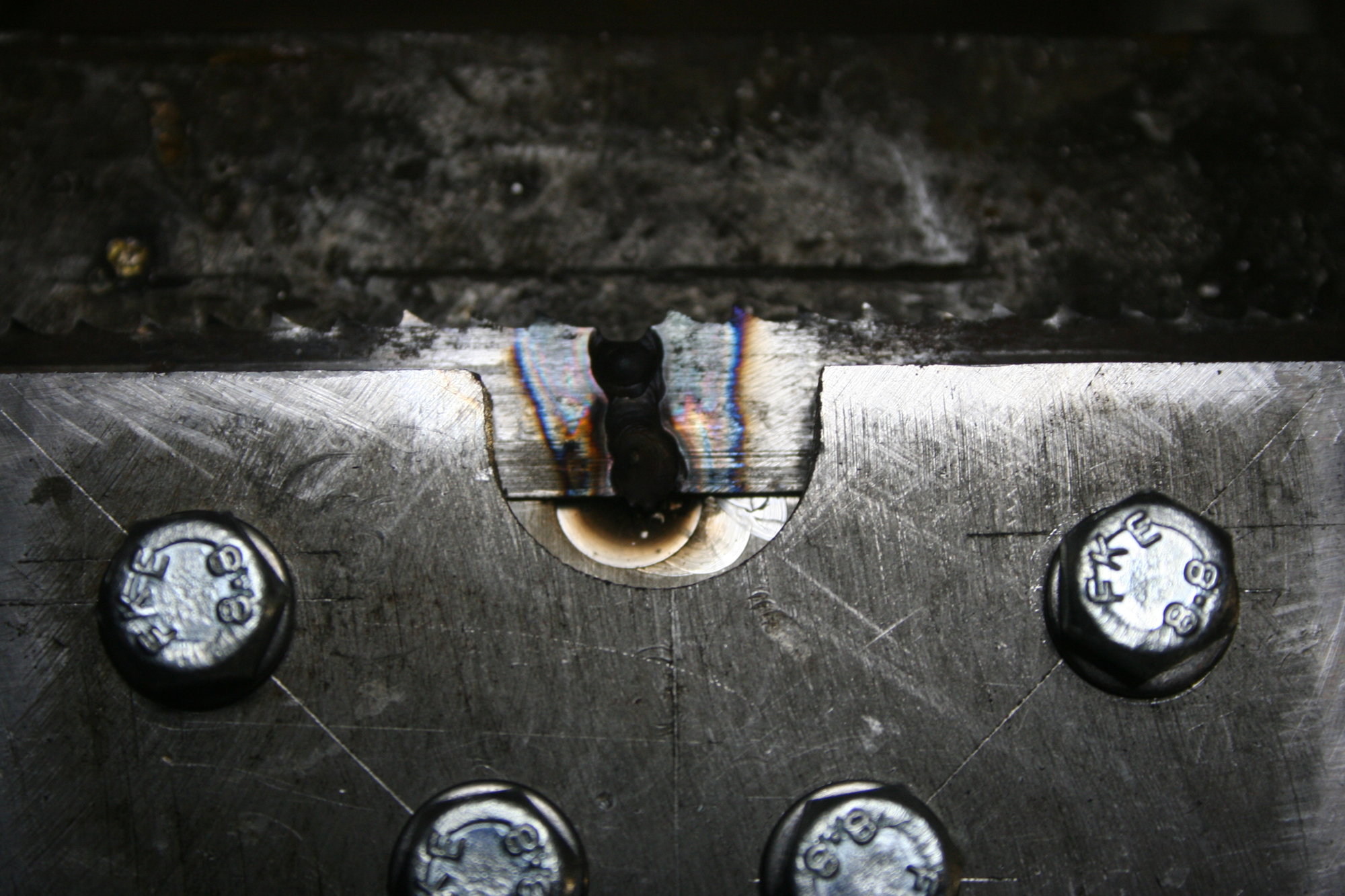

I Tig them on brass plate LINK. You could use Mig but there would be a lot more material to grind off. Once welded the joint is really brittle and any flexing of the blade will snap it so anneal the joint before grinding and if it gets hot whilst grinding, anneal again before use. Annealing is the key to them lasting and trying not to get an undercut on the tooth side and back of the blade.

You are not tempering the weld you are annealing.
I have been considering an electrical anneal with DC current between copper anvils but that's a bit exotic for the amount I need to make.I thought about the fast cooling when annealing, also how much gets annealed. Not saying this is THE way to do it but with the little butane pencil torch, I heat from underneath aiming to get the smallest section around 8-10mm cherry red then back the torch away slowly trying to keep the glow without heating too much of the blade. I should have taken more photos of the experimenting I did with old blades as I have forgotten most of it!I have been considering an electrical anneal with DC current between copper anvils but that's a bit exotic for the amount I need to make.
See post11. I made anvils for a spot welder but I had to scarf the blades. It worked fine.
