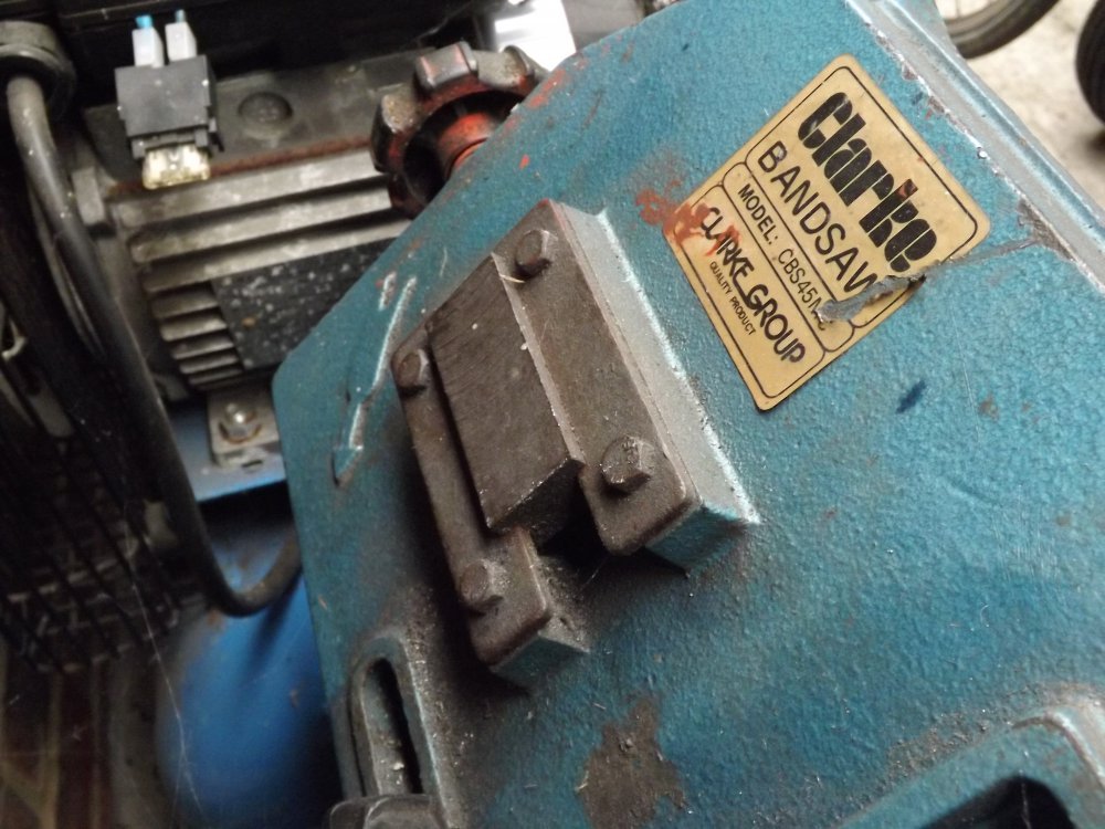

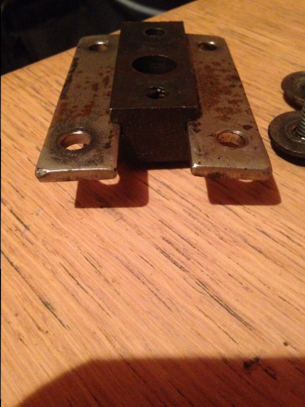

Thank you, without taking them out they look like 26mm o/d x 8mm W x 10mm bore.
I know the slack is adjusted out with the grub screw, but it is there and I know about it, sorting it out will probably not make any differance to its use but it will remove one more doubt from my mind.
10mm bore will be a 6000 series, about a £1 each for a budget bearing but double check before ordering, one of those little differences between the machine manufacturers.
How much slack is there between the plates and guide block? As you add blade tension the guide block will tip slightly taking up the slack on the plates, the grub screw only adjusts the wheel tracking to bring it parallel with the driving wheel.
No tracking adjustment! The bearings on this one look to be 10mm bore too.
