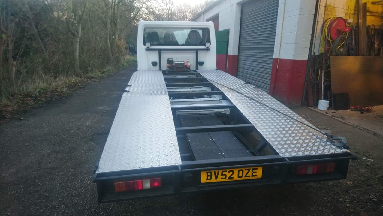

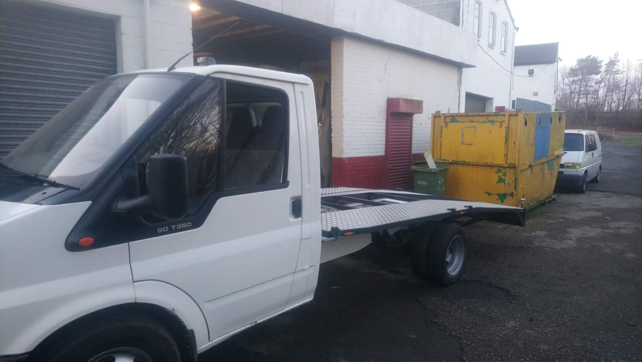

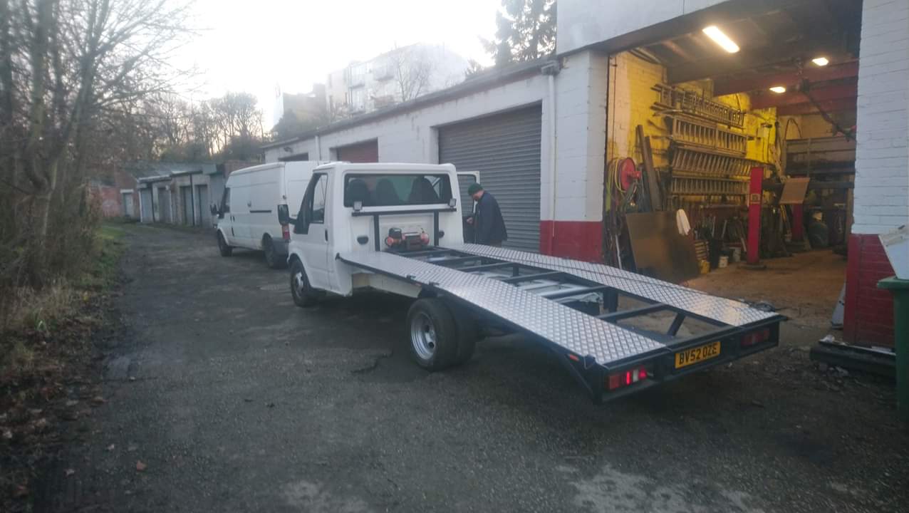

That rings a bell, think that's what that transit was based on.Remember there is a legal max overhang behind the rear axle of, I think, something like 60% of the wheelbase so choose base vehicle wisely.
I built one and it could carry nothing....i would not even buy one now...lolHmm i might leave it hahaha
I'm sure it was 1/3 of wheel base?
is the 60% thing how far you're allowed to have something overhang off the back of the van?
then 1/3 of the van wheel base is the distance the van can stick back past the rear wheels?
(maybe?)

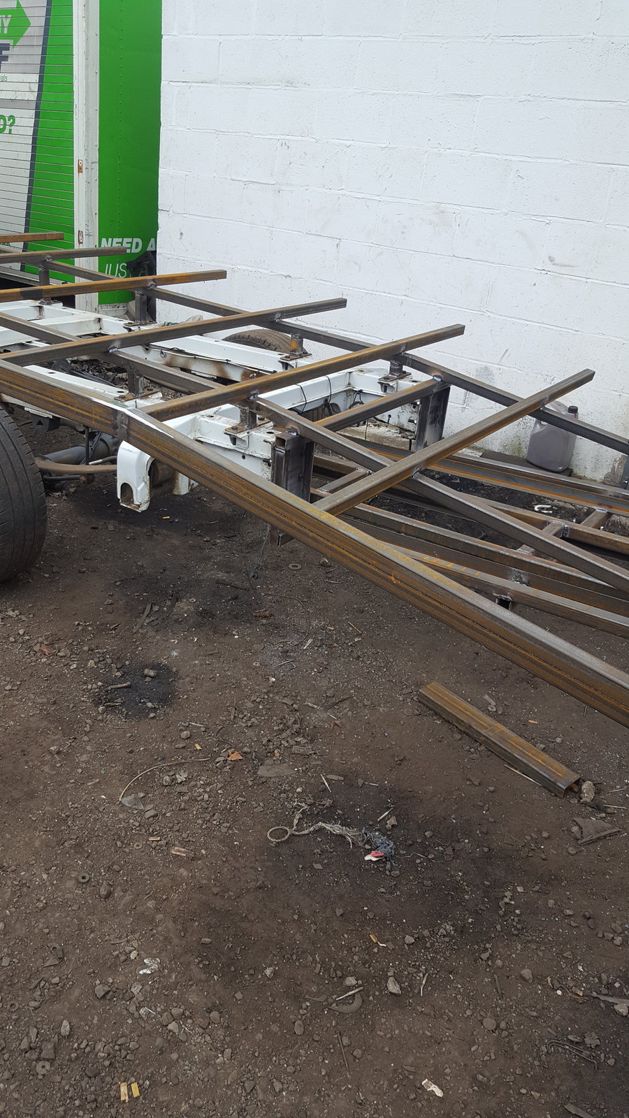

Few areas on that chassie need looking at 1stThis chap has just finished building his own...

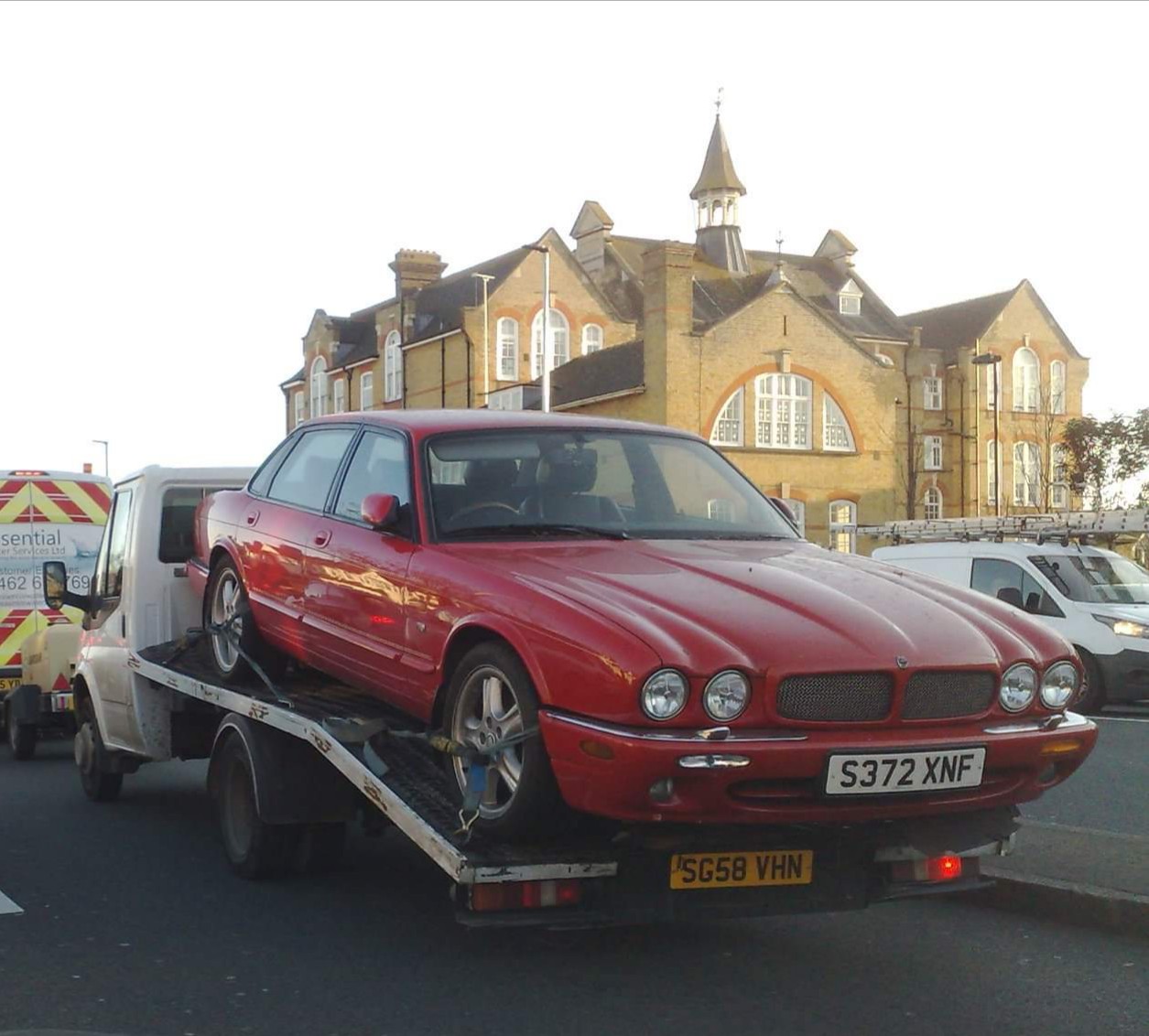

Legal carry weight about 1300kg then?
I think?
Somehow I don't think it's legal![]()
Yer i said that as i didnt know the full spec of the vehical1540kg
(3500kg total)
