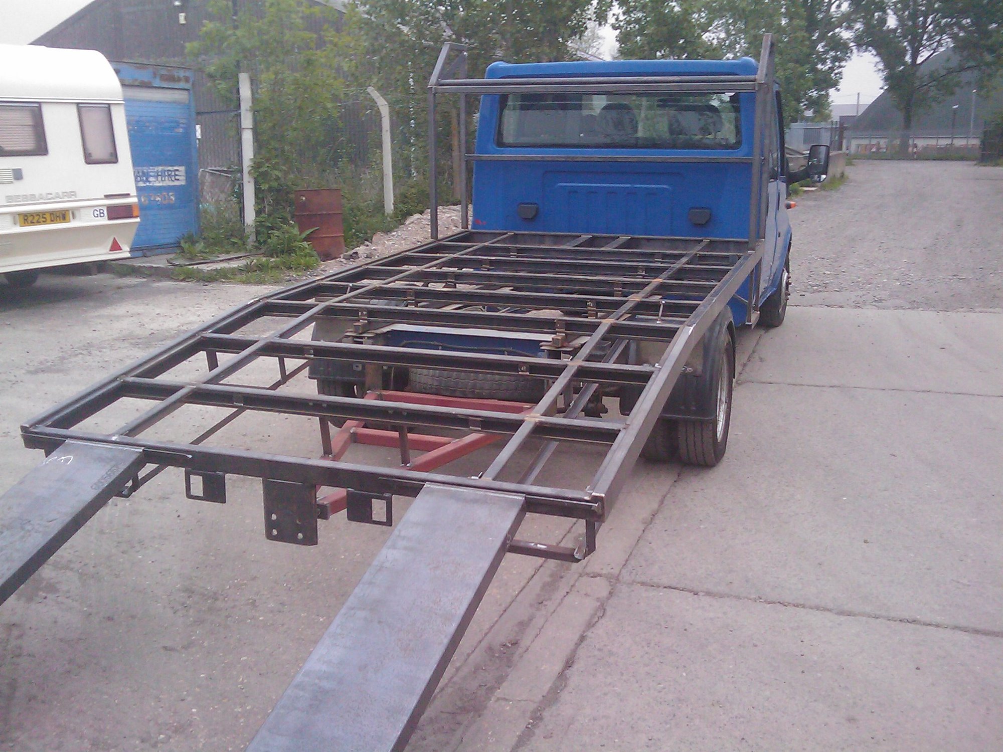

Thinking about building one
The question is do you have much welding experience?Is it hard to build as a home project?
I work as a welder yesThe question is do you have much welding experience?
Can't see it being a problem as a home project, Just depend on if you've got the space for itI work as a welder yes
Its not just about overhang but also about carry capacity for anything other than a kit car..Done a couple over the years
What are you going to put it on?
Whatever it is make sure its a long wheel base,seen a lot of builds on swb trucks with more overhang than whats on the chassis
Steel or ali?
Thats why i asked steel or aliIts not just about overhang but also about carry capacity for anything other than a kit car..
Theres a few builds on the transit forum,main thing is plan it out and keep the weight down with what you build it with,but keep in mind strenghThats why i asked steel or ali
il make it from box/angle then checker plate and a winch welded on,from steelTheres a few builds on the transit forum,main thing is plan it out and keep the weight down with what you build it with,but keep in mind strengh
