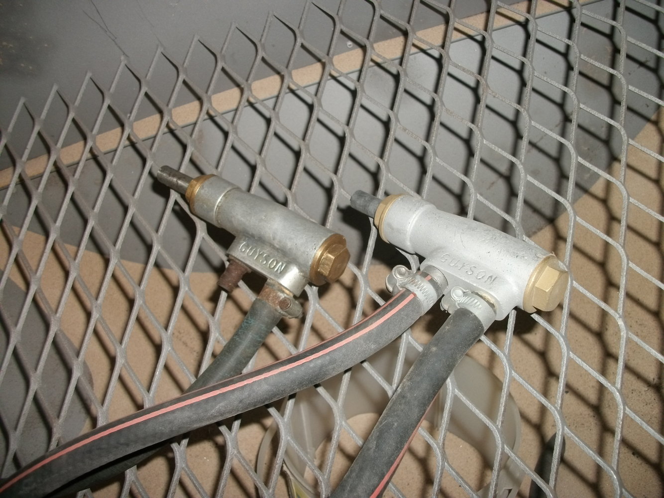

Mine will only 'clog' if left for a while with the nozzle valve not seated properly - the 'clog' clears in a few seconds of using. I've only got a 50l tank, it would be a right ball ache to keep flipping the air ball valve on the tank.there rubbish and clog the blast hosejust use a strait through blast nozzle and operate the pot from air ball valve on the pot supply line
You need to be aware of two 'clog' issues with those guns, as described previously, the blast hose can 'clog' if left for a while with the nozzle valve not seated properly - the 'clog' clears in a few seconds of using again but wastes grit and poor performance. The second is nozzle blocking, I found the nozzle tended to block using fine iron silicate at 2.5mm, a gentle tap of the gun would clear it, all was OK at 3mm.this type

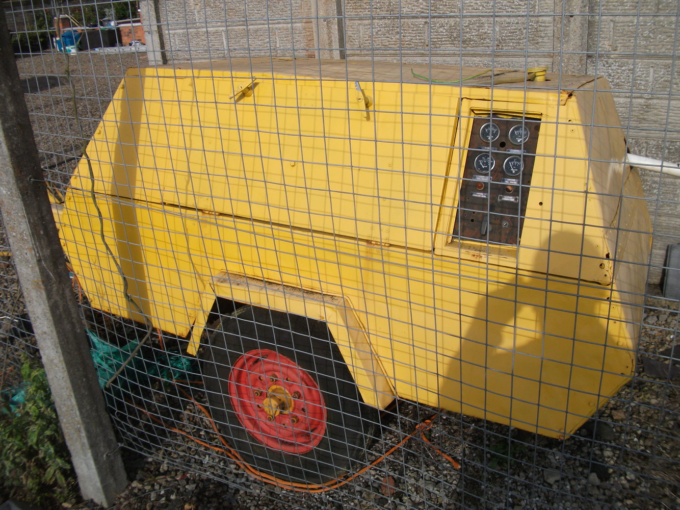

a 6mm nozzle takes a 85 cfm comp to run at 90 psiI'm not familiar with that, do you have a mesh size ?Supafine J

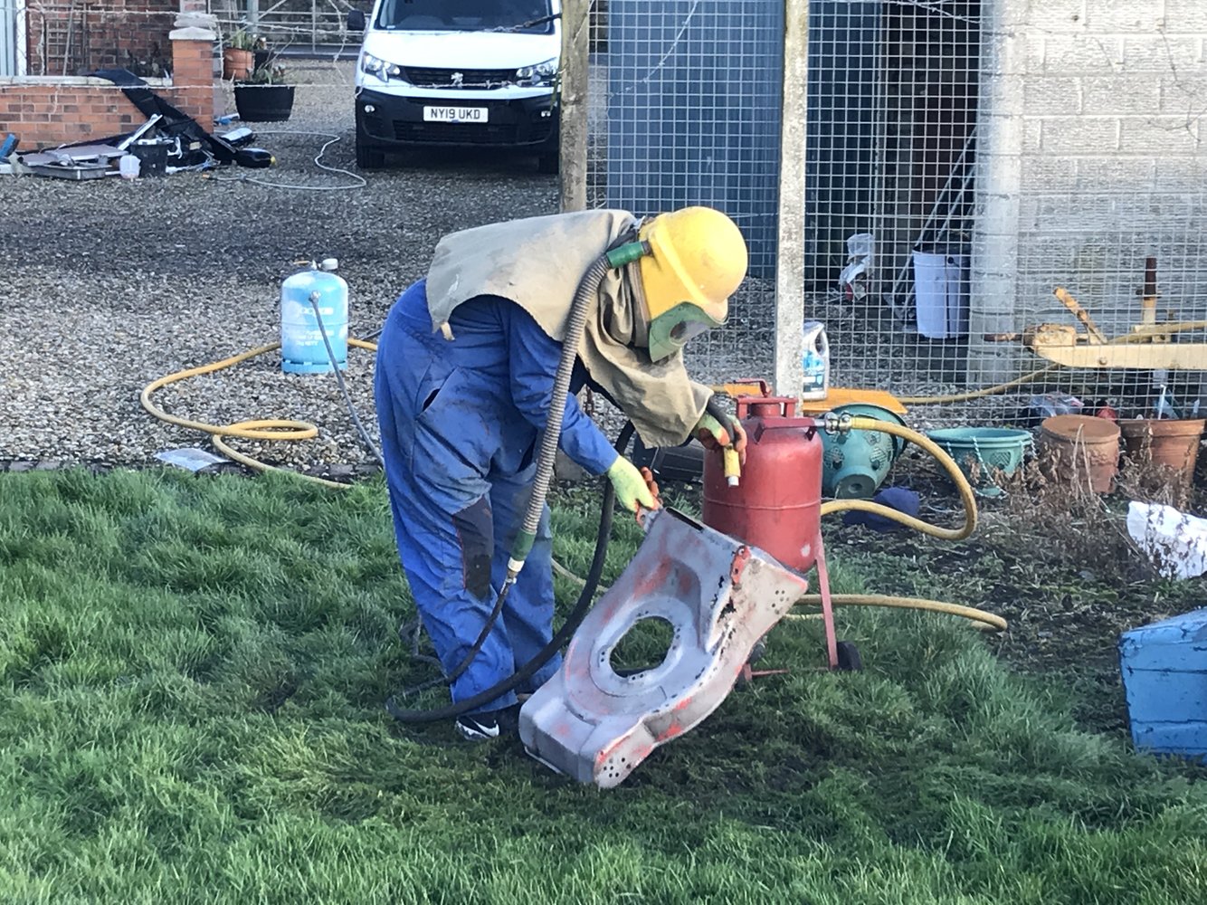

if your having to give the pot a kick the media is either damp or its not flowing down through the ball valve properly in to the blast hose . they are rubbish and clog up easily unless the grit is verry consistent in size which is hardly likely unless you sive it from new .fitting a proper reg overcomes that and is verry forgiving. i can fill m,y pot up regulate it and not touch the reg at all once set to the finishThis thread wasn't supposed to be about the blasting process so I didn't put full information in the initial post.
I have 4 compressors. Plan is to hook them all together to get more air. At present I've got 2 on the pot and it's better than 1.
main compressor is 3.0HP/150L
2nd compressor is 2.0HP/100L
I've also found (I think) the grit I had more success with years ago. It's from Scangrit and is Olivine (magnesium-iron silicate) from what I can see so am just going to order it online.
Also had a bit more success with the blasting and I found the single-most useful way to keep the grit flowing is by rocking the pot back & fwd or side to side. Don't know why it works and it's obviously not practical if you are far away from the pot but it's working for me

if its a pressure pot a 6.0mm nozzle will take at least 80 cfm to run at 90 psi pressure my road tow moble comp runs flat out when blastingWith j blast spafine, 4mm nozzle, I get barely any media flow and blasting takes ages. 6mm nozzle I get great flow and it's much quicker. However I'm only running perhaps 20CFM. What's going on? Based on the chart I should be using an even smaller nozzle!
