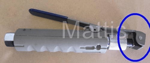

nothing wrong it IS a suction gun nowhere near as powerfull as a pressure fed pot like thisSo what am I doing wrong here? Here's two videos
6mm: https://streamable.com/irrt0l
4mm: https://streamable.com/5ov6ya
4mm highly restrictive to media flow
What chart are you consulting ?But why is the 4mm so restrictive? 4mm is bigger than what is recommended for the CFM I have

its copper slag expendable . you can only use it twice otherwise your just hurtling dust and cloggs easily. sieve on the second go as wellI've never heard of that composition, but it looks allot like "Black Beauty" a brand name of coal ash (bottom ash not fly ash).
Popular over here....with some people, just not me.
It's definitely Olivine but looks quite like J-Blast as it's black. It doesn't have a mesh-size printed on the bag but gives the size-range of the particles. How does this translate to mesh-size?

I got on quite well with less blockages and sufficient air-power but I flt this grit was starting to go 'blunt' after only 2nd (or 3rd?) time around. On top of that the visor was opaque and I couldn't see what I was doing. I hadn't got every speck of rust off the worst areas but you have to draw a line somewhere and I decided to get some paint on the **** thing.
I will be using the blaster again, to clean some much lighter corrosion for the engine-bay of my Jag. So... I'll need more media and a new visor-pane.
