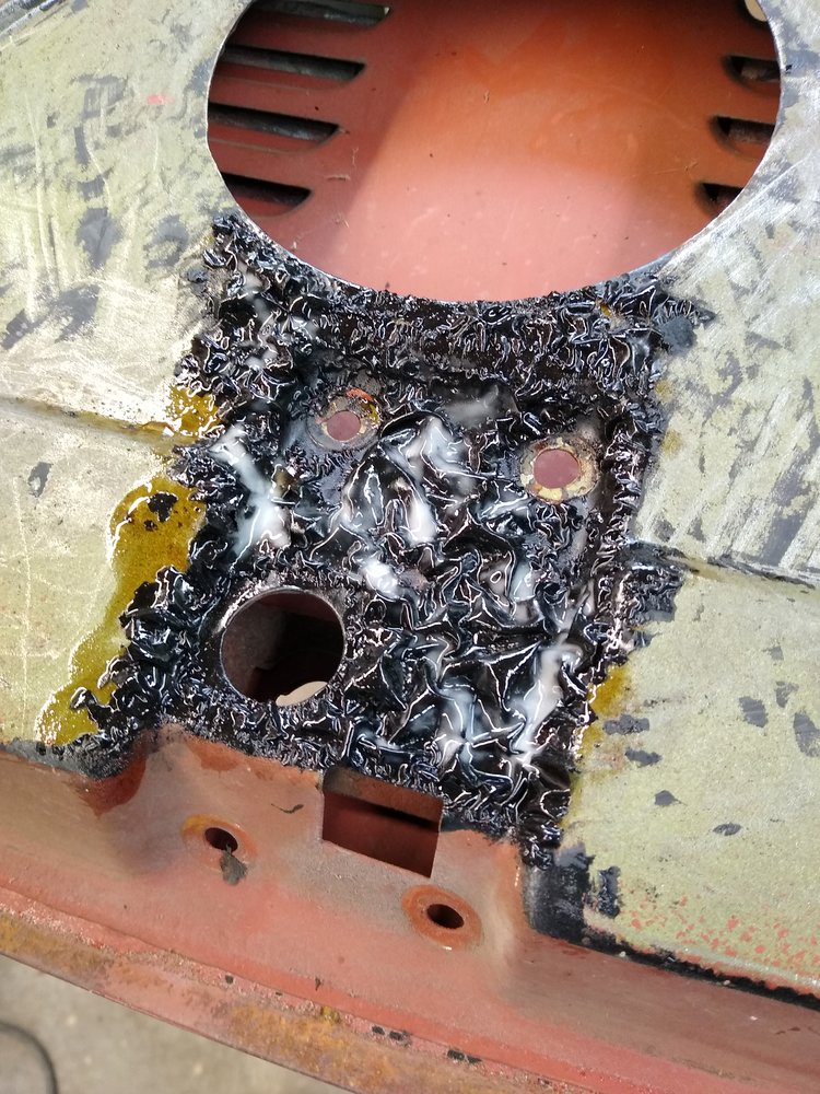

It's not glue, it appears to be some sort of primer that was under the black paint. That was the final bit of the whole panel which was stripped with the Screwfix stripper.Is that yellow stuff glue? If so it looks like what I'm after. The blackening implies it's doing somthing other than just being a solvent which is what I need.

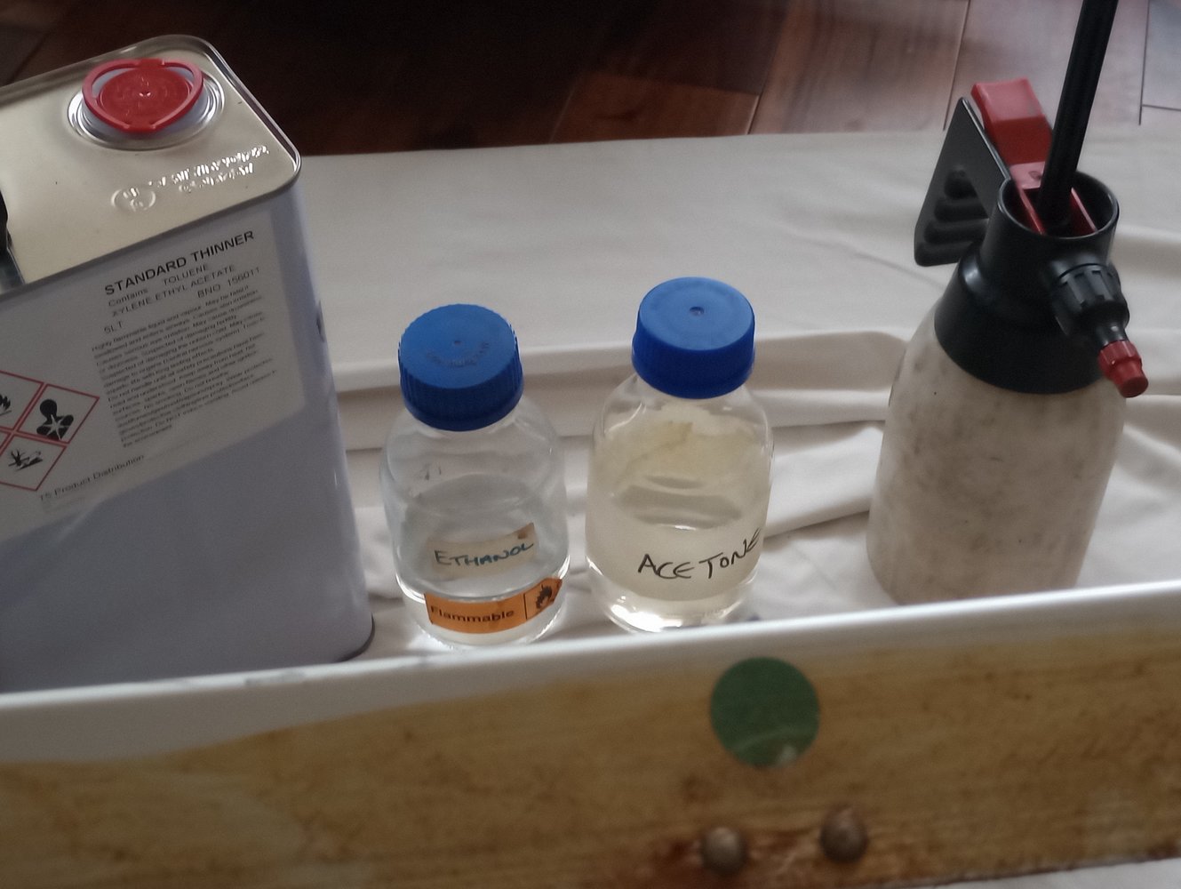

I tried this lot today.
Gun wash, ethanol, acetone and brake cleaner.
Best of the bunch was the gun wash and scrubbed with a scotch pad.

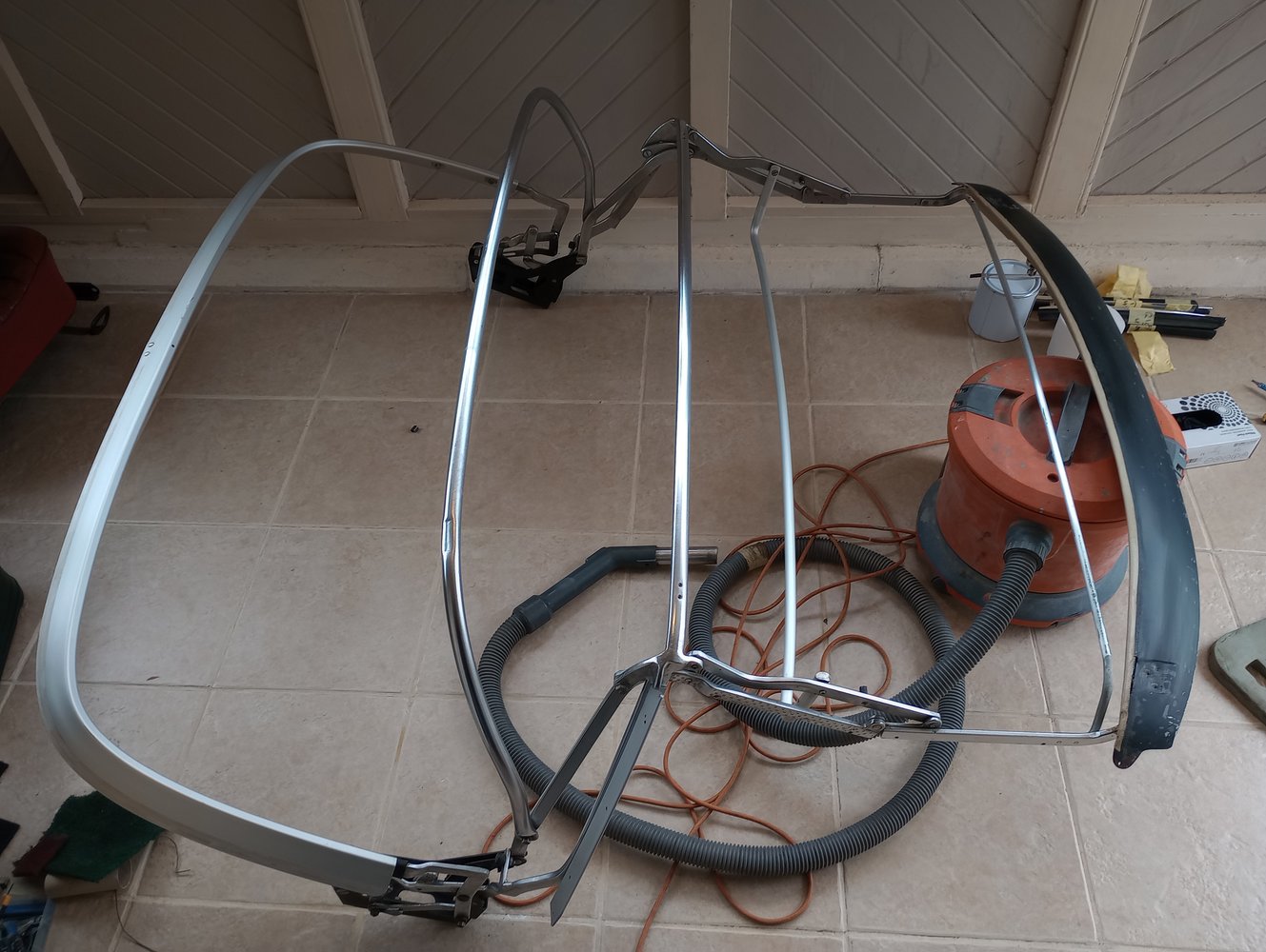

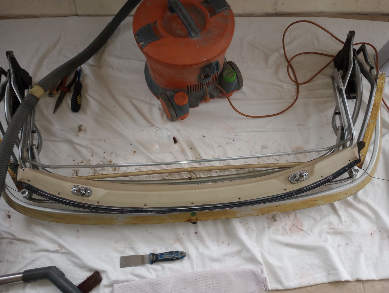

Still a slow job though cleaning up this soft top frame

I wrapped bits a time with a rag soaked in gun wash, then scraped and scrubbed with scotch pads. Worked on it most if the day and probably ended up with brain damage from the fumes.If it's no rush i use old towels with gun wash on and if i can wrap that in cling film its a bonus, it will remove glue and years of paint if you leave it a few days.
