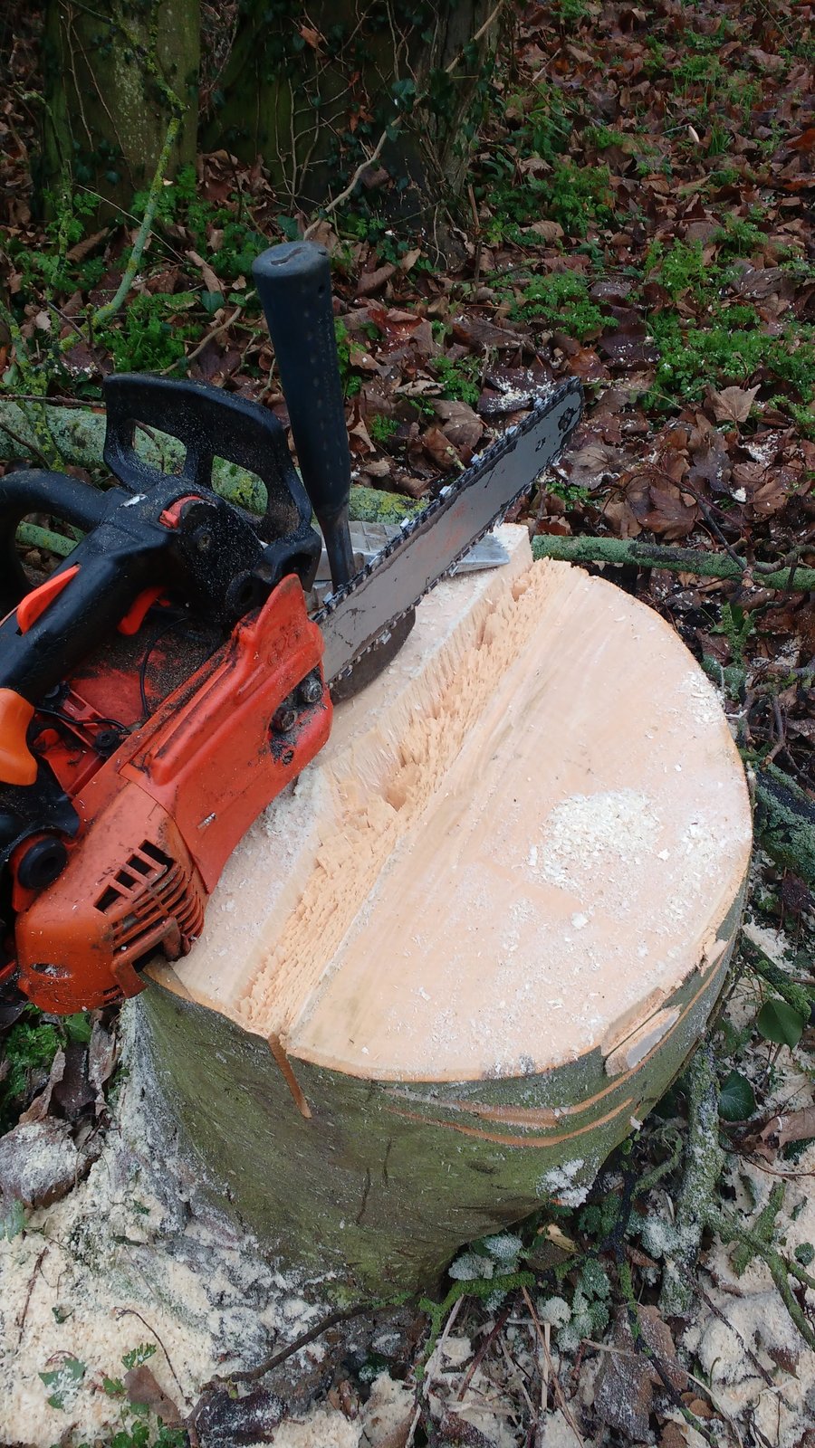

    Im a little lost?
    I didn't recommend a diy saw i suggested the echo was my choice from experience.
    This was my cs360 took a hammering for 4 years i bought one of the first releases i was flat out commercial climbing.
