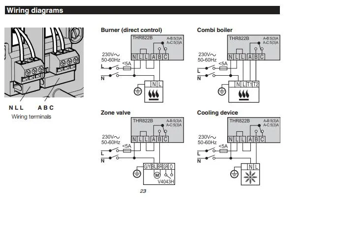

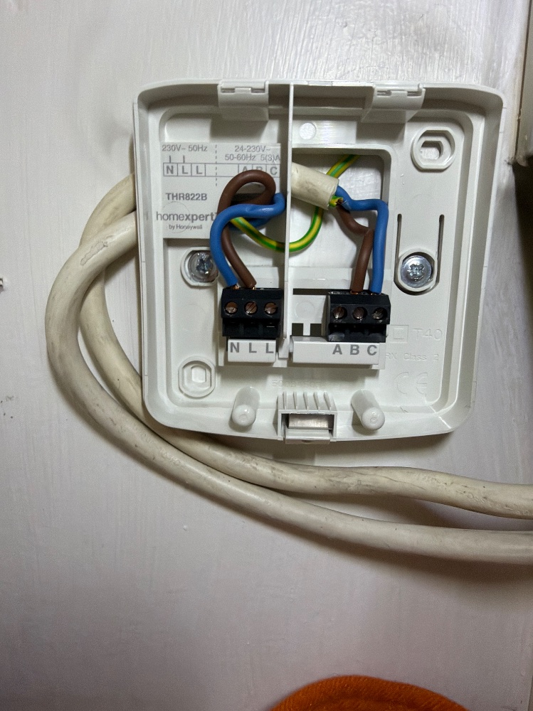

Hi guys, I’ve recently bought a tado wifi central heating thermostat which apparently is very easy for the DIYer
So my first mistake was not to take a picture of the existing setup which I know is a totally rookie error.
It turns out the tado wiring isn’t as easy as it first seemed and I’m basically in over my head. So now we have no heating and the wife is livid.
I was wondering if someone can help to put it back how it was.
This is how it is now and I know the wires on the left are live in but I’m just not sure which way round the other side go?
Thanks for any help.
