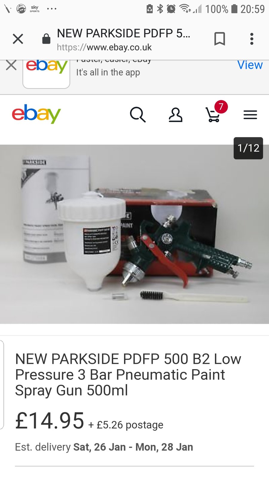

Anyway back to painting.. .i have checked out specs for the primer and gjn and we are using a Devilbiss GTI Pro Base which has a 1.3 nozzle. The paint supplier is suggesting that nozzle is not big enough for the high build so its carrying more solvent than paint.
He has suggested a cheap HVLP gun would assist things. We already have thisView attachment 166227
But at that price is it really better for primer.
I painted my towtruck with it using an enamel type paint. Even the body was reasonable but i now keep that gun for black fire paint so i will need to give it a good spruce up...lolthat gun will produce a good enough finish as is, i have 2 , i did all my kitchen unit doors in white and compared to the new ones in our new house id say the painted ones were of better finish.
