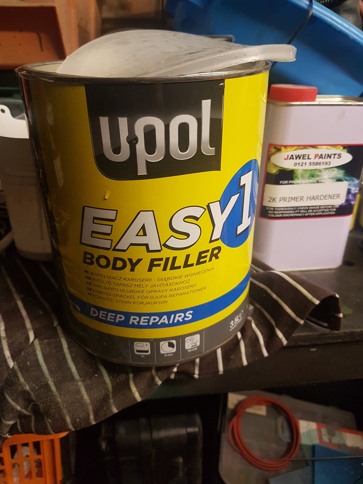

I tend to agree....i was not going to hide it but take it back to steel and plastic and belt and braces. This was around dinnertime.why are you using barcoat ?
its gone wrong because the primer wasnt used properly , hiding under barcoat will just make it worse in the long run
UnbelieveView attachment 166409
No thats after a clear coat. The gun was chucking paint out like it was going out of fashion but at this stage I just want paint on it!...lol I did not have the inclination or mental strength to mess with gun settings that late at night!That is some serious orange peel....
But it does not look like a clear coat.........Is this picture the basecoat flashing off?
no heat doesnt replace hardner , if it hasnt been mixed properly theres a good chance it will never go off ...are you sure its the correct hardner for the primer
like someone else take it all off and start again
Not in any noticeable effect, it is relying upon the chemical reaction between paint&hardener.Does heat replace hardener in effect.
Yeah i wondered if the hardner was like an activator or just speeded up the drying process.Not in any noticeable effect, it is relying upon the chemical reaction between paint&hardener.
I am sure that after a few miles it will be just as caked in salt as the rest of the car and no one will notice.Yeah i wondered if the hardner was like an activator or just speeded up the drying process.
I got the final clear coat on the 2nd wing 5 mins ago so it can all go back on the car and wont rust.. wont win any concourse displays but after my assault and the setbacks we have had i just need a break....
yes ,good stuff used to use it all the time ,but you had to be quick, have had a 3/4 pot full go off on me , bitch to clean out after.If you need to work fast you can add a tiny splash of Rocket https://www.ebay.co.uk/i/201538823050 (other types available)
You literally just want a splash or it will set hard in the gun within half hour.
I have used it on production jobs when time deadlines are tight, some people say it can have a slight effect on gloss levels but it's not anything I have ever experienced.
