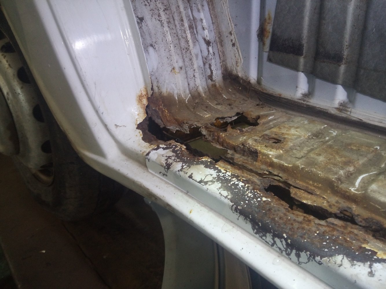

All the usual places on this one are OK. They need some work, but should be ok for the mot, apart from the cross member right at the back which fell apart when I touched it in places.. due to prevailing conditions Im doing the minimum to get it through an MOT then sorting out the beginings of your pics in due course..They rot behind the back of the front wheel arch just where the stupid excuse for a front mud flap is(crazy idea),i've patched up quite a few of theses over time(MOT fails),last one was a couple of months ago,this was on an 08

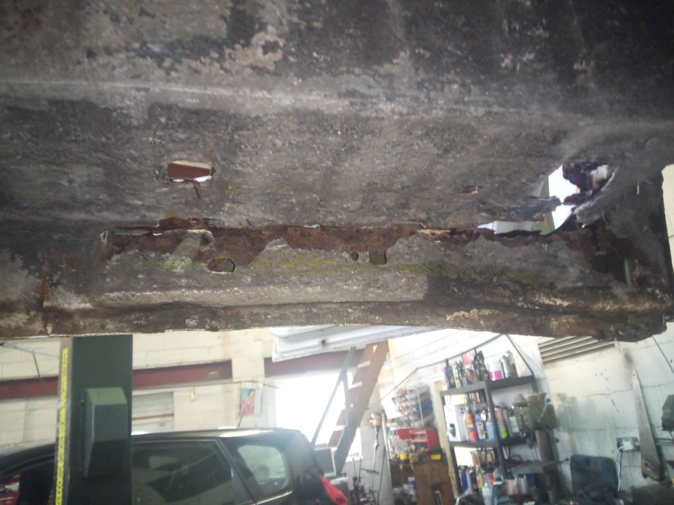

If you look at the right of the pic you'll see a square hole,thats the bolt fixing for the stupid mudflap thingy,that box section there has no drain holes,so work the rest out

Rip out all the plastic stuff and give a good poke with a sharp thingymabob
Replacement panels aren't that expensive TBH
Also give it a good going over on the chassis by the rear bump stops,they rot from the inside out(sorry no pics,cant find them)
