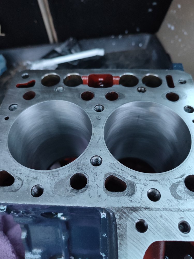

I remember when I worked on a Russian built cold war era seismic vessel years ago. I was 'supervising' 2 Russian mechanics looking after 2000psi 1800cfm LMS air compressors. My company had nowhere else to put me, the industry was on a down turn, so I was essentially a spare body. I even slept in the ships hospital as there was no spare cabin for me.There's a knackered 404d-22 in a 20yo JCB Teletruk where I'm working.
It was working but to my ear rather clattery & rough when I started there back in the summer, slow to rev up & I thought it had a bit of blue smoke.
Hydraulics were slow, it picked up revs slowly & basically ran like a bag of carp. It was also "breathing" quite a bit, pushing oil mist out the oil filler cap.

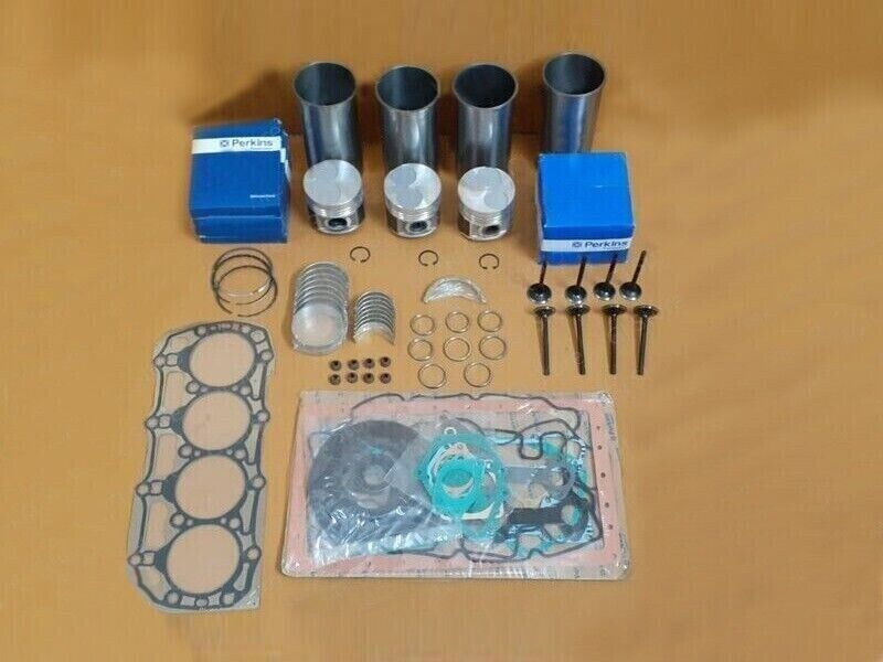

Owner insisted it was fine, & asked me to service it (Saying he'd paid 2k not that long hence to have the engine "overhauled" - well I looked online for the price of the overhaul kit parts & they were 1.8k alone - so that told me all I needed to know).
I reckoned it was clapped & low compression - but he wouldn't have it (he's ex REME as well).
I changes oil, filters, cleaned out the hydraulic system & replaced the oil & filter, adjusted the valve clearances. It ran better, but not that much better.
In a matter of maybe 2-months it got progressively worse, more smoky & clattery, harder to start.... but he insisted the smoke & rough running was just due to an injector, & the poor starting down to glow plugs.
(I tested the GP's & all 4 were OK, & it was breathjng so hard it was blasting smoke & oil from the filler, remove the dipstick on idle amd it blew smoke & oil drops out, & using oil excessively now).
l told him again IMO him it was forked - but he kept using it.
It's now been sitting dead as a boat anchor I the yard for the last 3-months..
