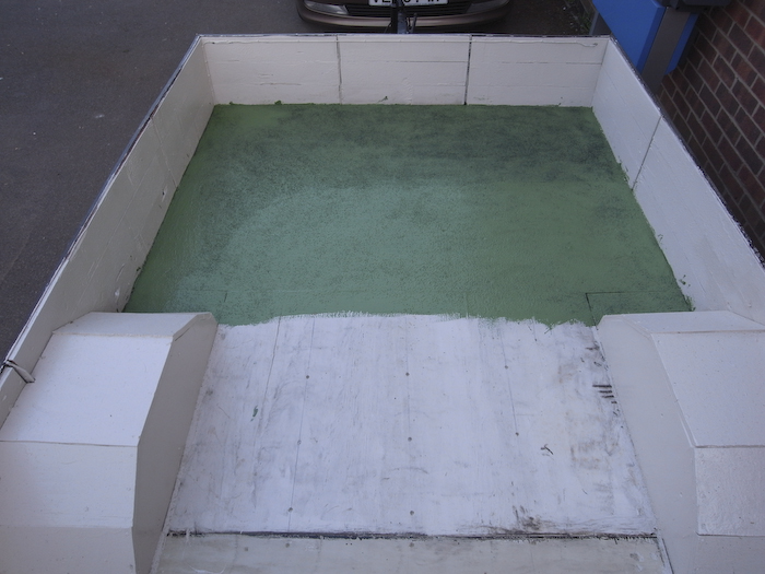

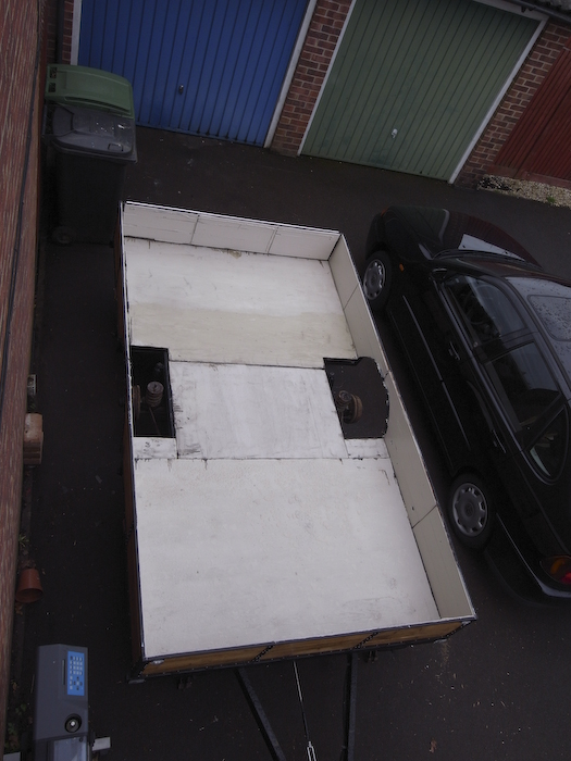

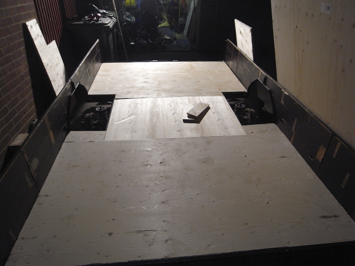

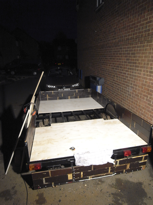

Hello Chaps,

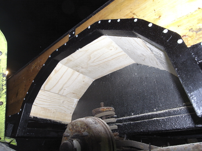

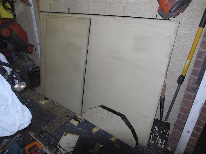

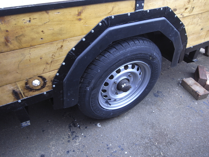

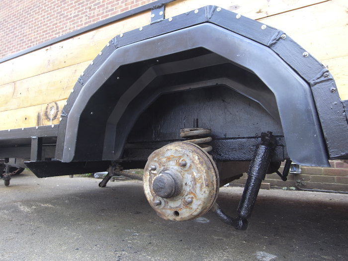

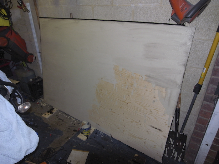

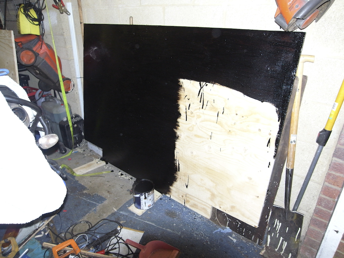

been a few days since the last update cause I've been away for the weekend and work has been busy too, so not had time to work on the trailer until yesterday evening. I've cut the floor plywood to size now and put on the first coats of protective paint. The underside got the Hammerite/Waxoil paint, diluted so that it seeps into the grain, and the top was getting some random paint I had lying around. Again, diluted to a degree so that it would seep right into the wood. Both sides will get another coat before being mounted.

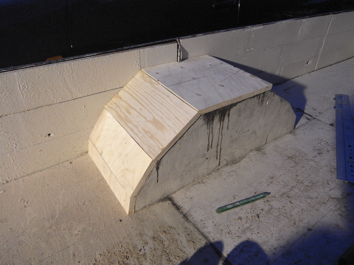

Didn't finish the wooden arches for the wheel arches though cause it started to rain when I was about to do it, so I had to move the whole operation rather sharpish into the garage...
Getting there!
