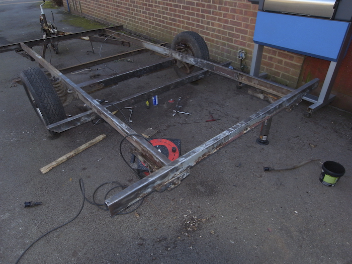

been lurking around on this forum for a while, reading a lot and learning tips but haven't posted so far. I was really inspired by the post from SC_BK (http://www.mig-welding.co.uk/forum/showthread.php?t=2574) and because I needed a trailer I decided to dive straight in and do my own project. I have been welding for a few years and restored cars and motorcycles before, so this is not entirely new terrain for me.
I'm on a tight budget and I didn't have £500 to spend on a big trailer, but I am able to spend £100-£200 per month, and because I wanted to have something to do and learn something I decided to do it myself.

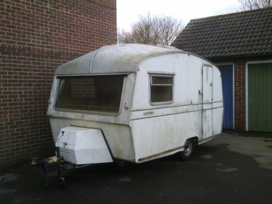

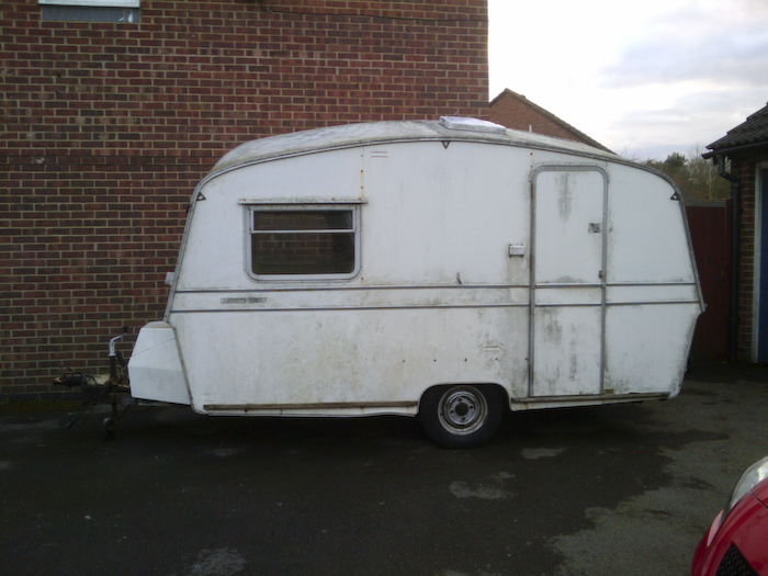

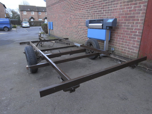

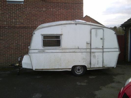

Bought an old crusty caravan from eBay. For £36! Good chassis and all lights worked, but the rest was a bit sorry for itself.

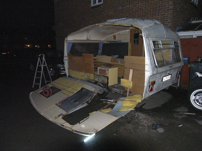

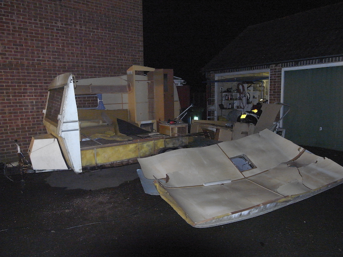

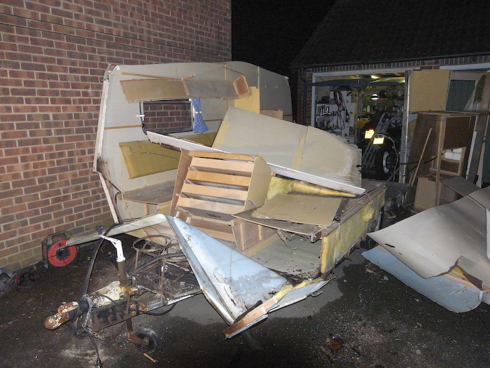

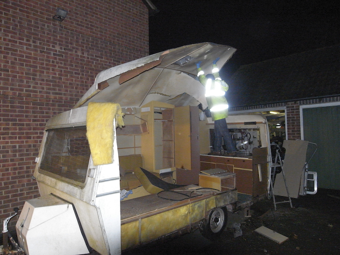

Spent 10 minutes considering whether I should save anything from the caravan, but after realizing that it would take me AGES to unscrew and take everything apart 'gently' I decided to just trash the whole thing. Got my circular saw out and started cutting the sides and roof off.

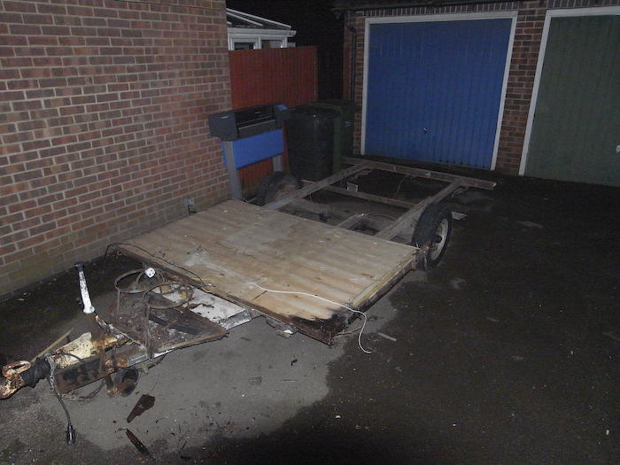

That's how it looked after I cleared everything away with my girlfriend.

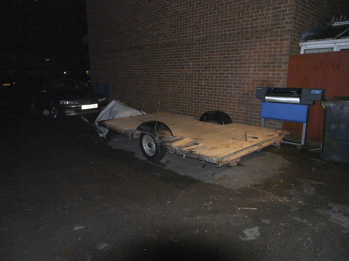

Last thing I did that evening was to remove some of the wood from the chassis.

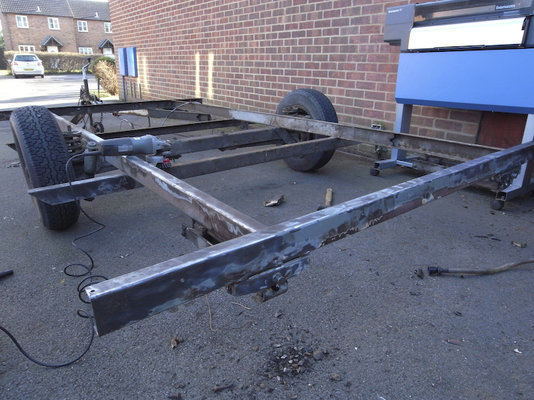

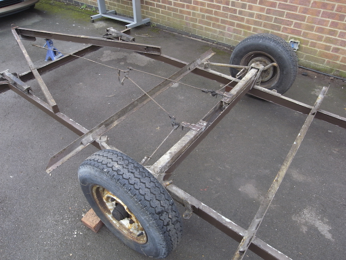

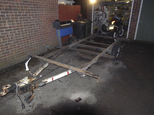

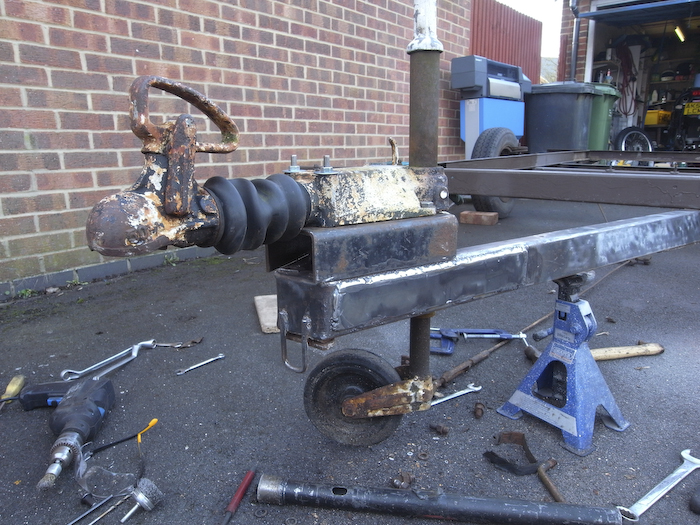

2 days ago I stripped the chassis completely:

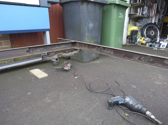

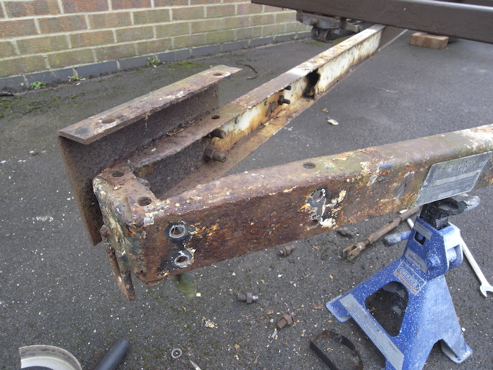

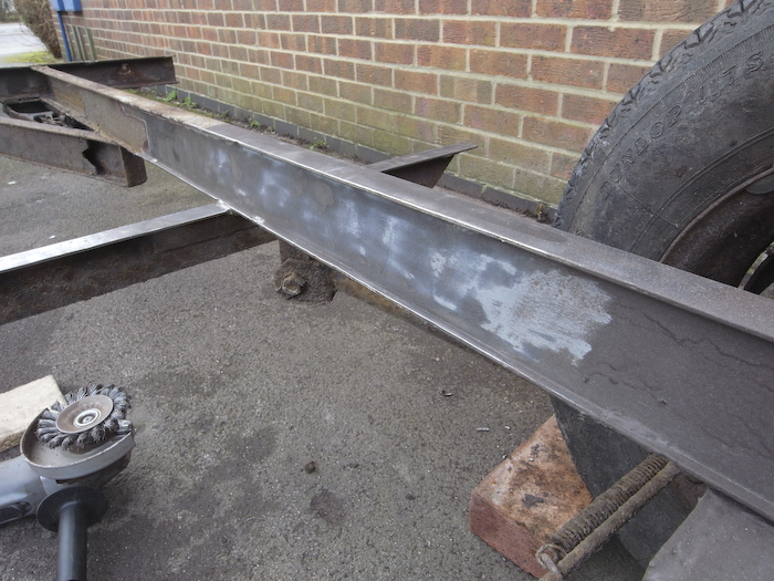

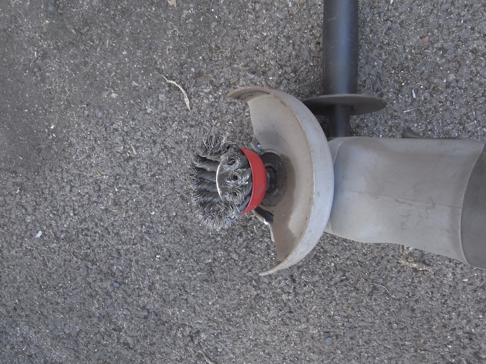

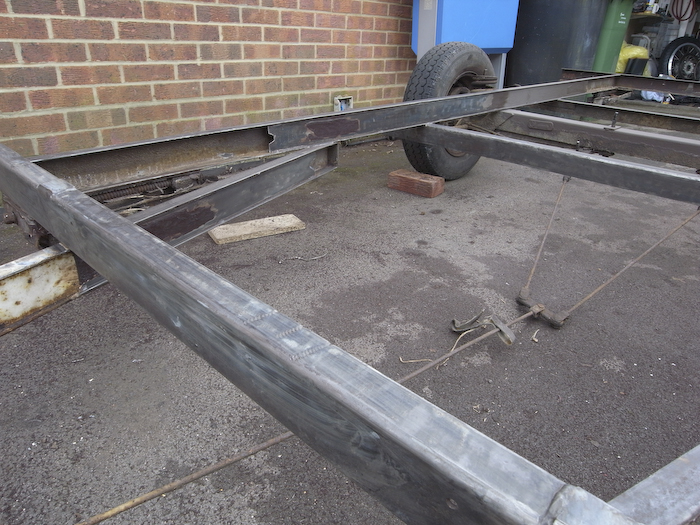

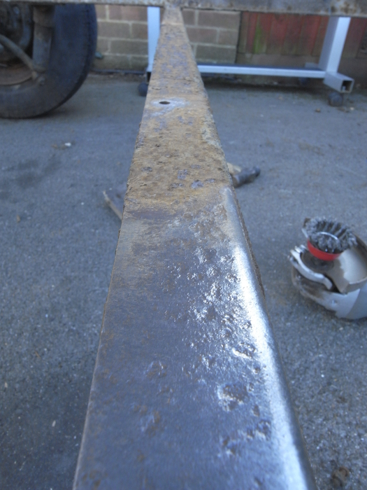

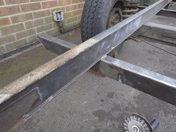

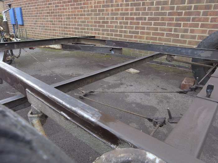

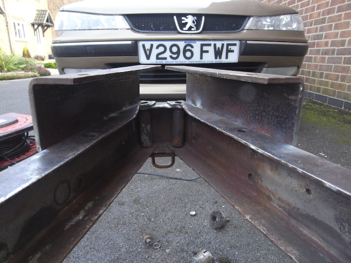

And today I started de-rusting the chassis with a wire wheel on a grinder.
The chassis rails are in a remarkably good state after 40 years!

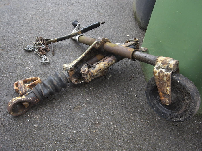

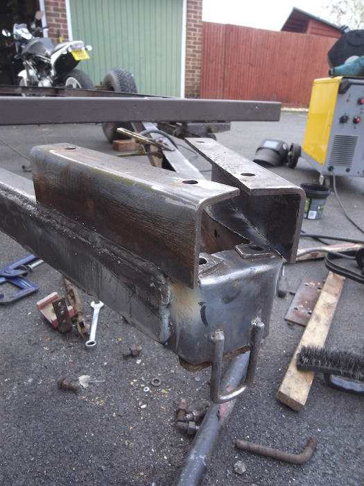

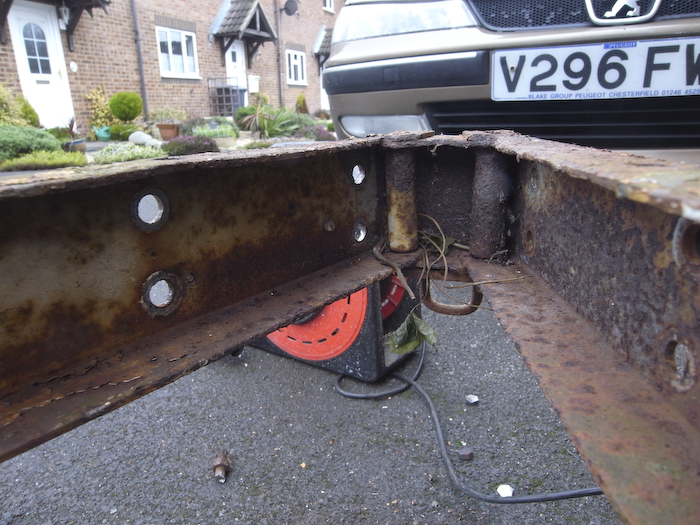

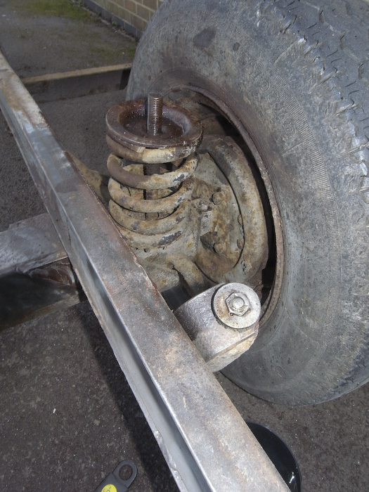

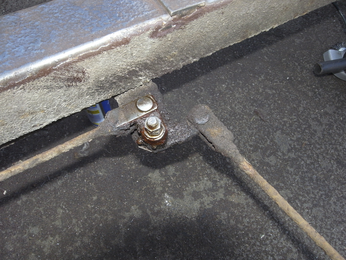

That's the suspension, which I'm stripping to clean, paint and rebuild. Brakes will be overhauled too. Safety first!
All nuts and bolts were in surprisingly good nick. Either because they were covered in grease or paint.

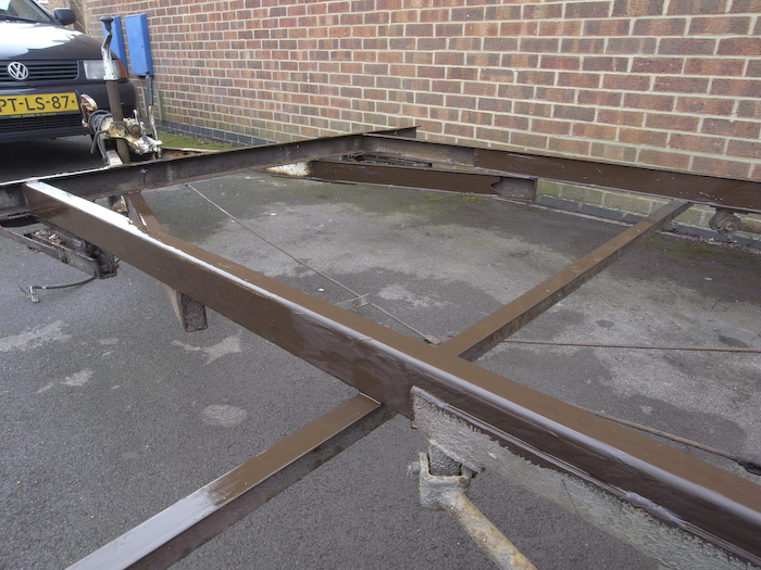

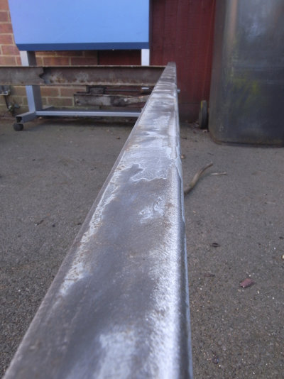

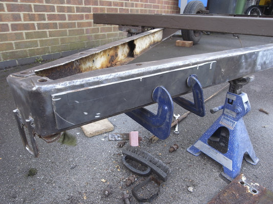

After about 4 hours of hard labour I only managed to get less than half the trailer rails de-rusted and the paint removed.

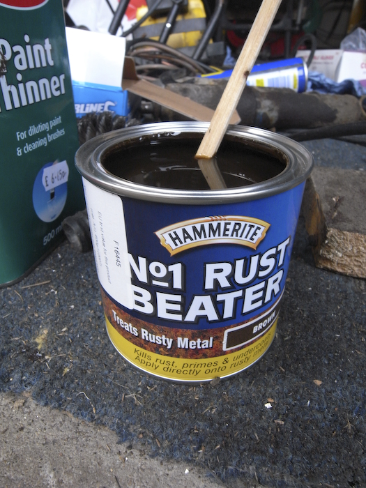

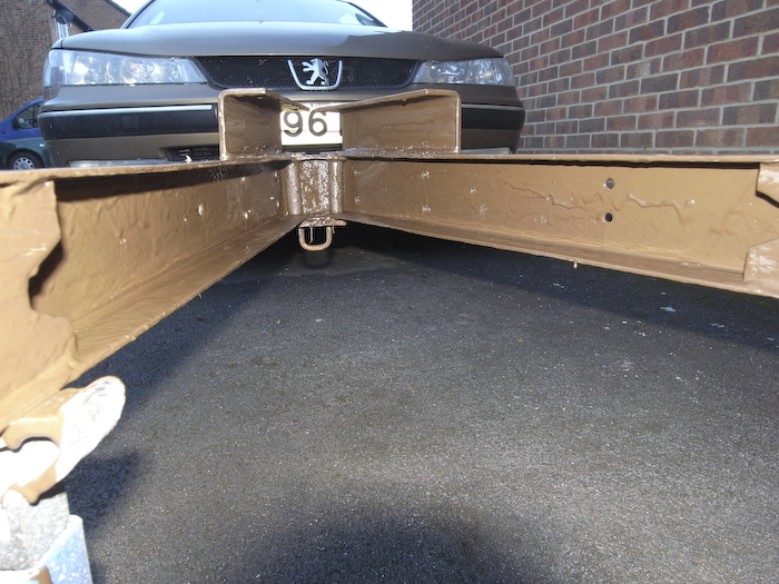

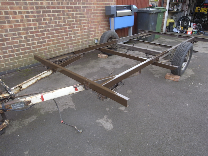

then I painted those bits in a rust preventing hammerite paint. This'll be followed by a top coat of black hammerite.

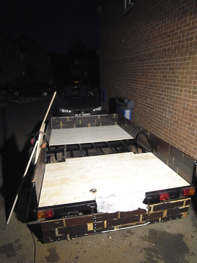

Next things to do:
1 - Finish removing all rust and old paint. Apply new paint.
2 - Disassemble suspension and remove wheel to clean, paint and rebuild.
3 - Weld top frame in 40x40x4mm angle and railings of 16x16x3mm angle.
4 - Build tail gate

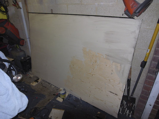

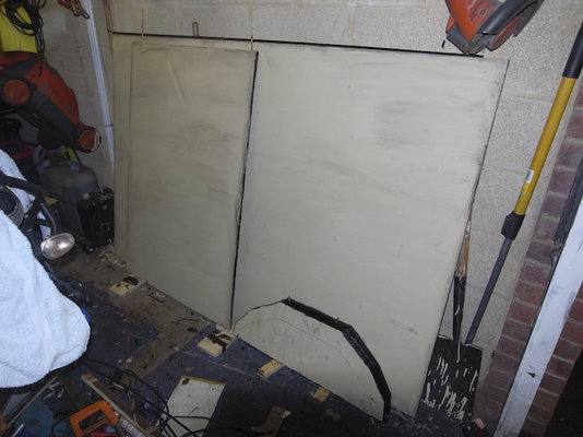

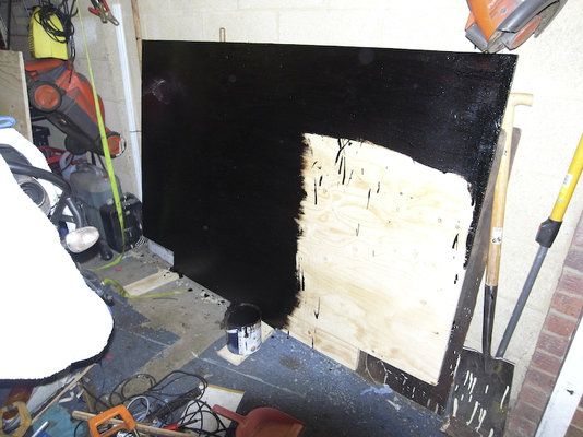

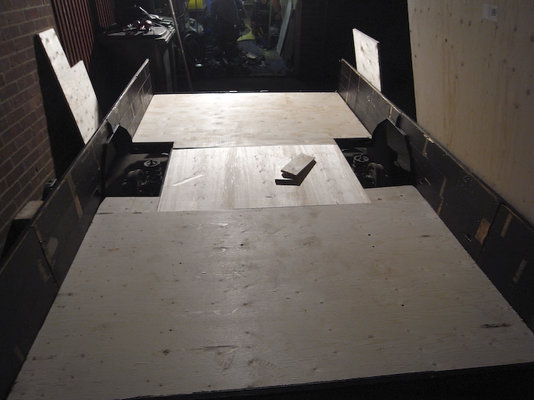

5 - Fit flooring made from OSB (painted on both sides to prevent water absorption)
6 - Fit lights
I'll be doing some more work tomorrow and next week, so updates to follow!
Cheers guys,
Mich
