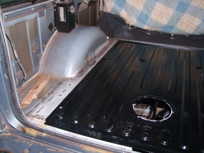

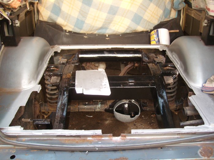

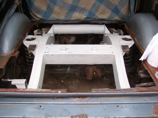

if i was you i would clean up and paint them frame rail's before you weld the floor back in
I was thinking the same thing, wire brush on grinder, then zinc primer, then 2 coats chassis black.
