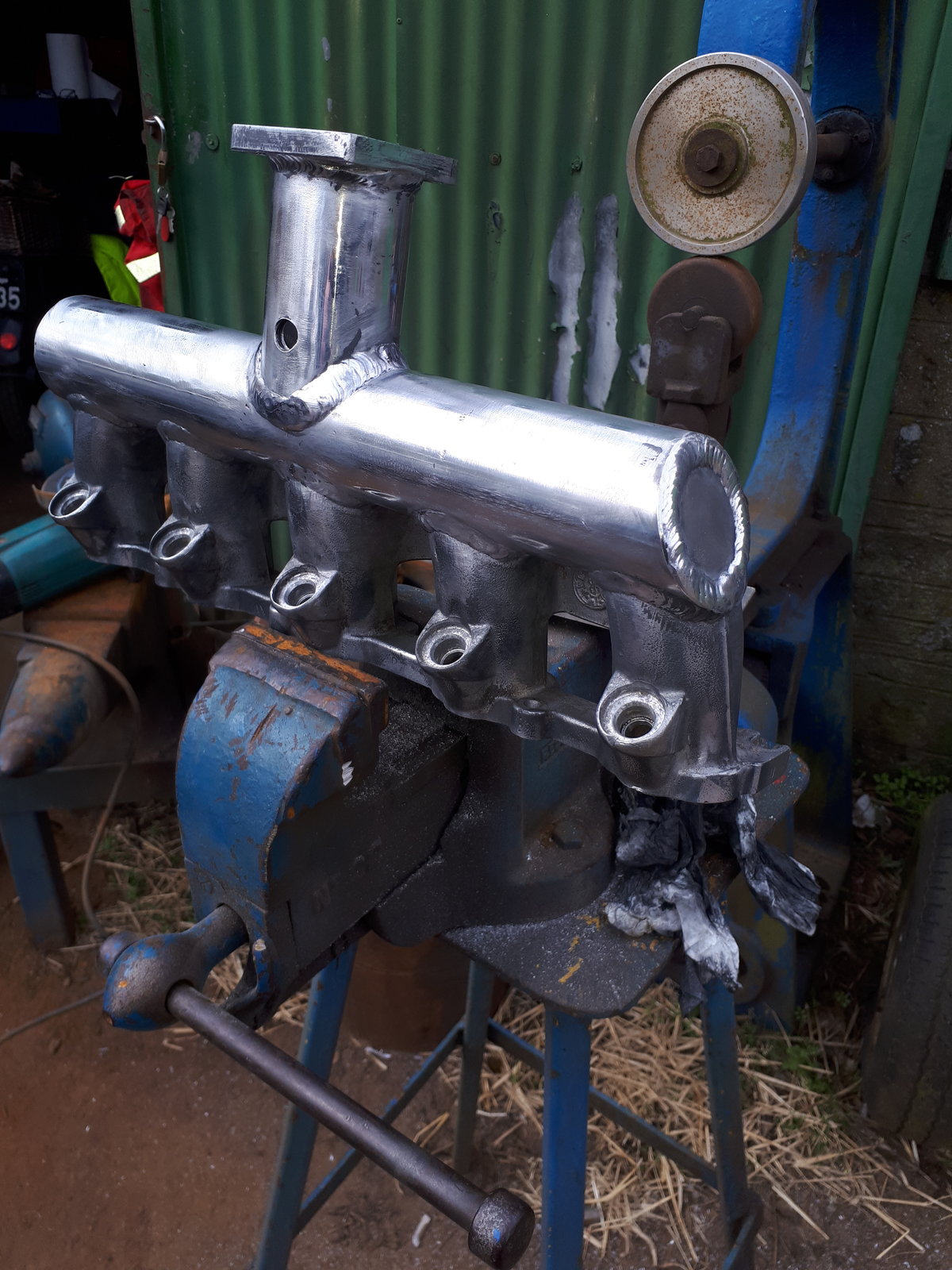

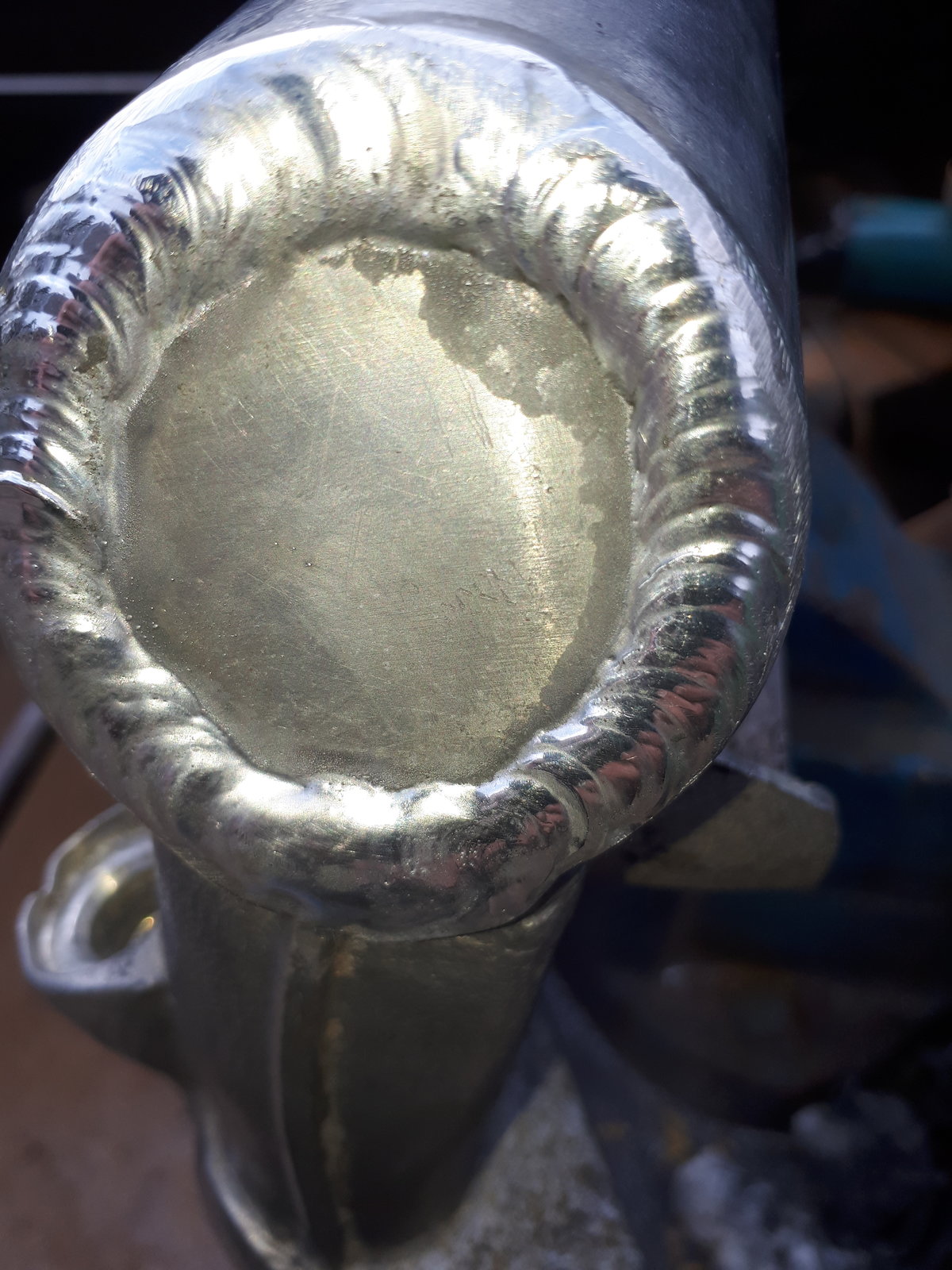

sods law had to mitre cut one end to miss thermo housing it fits ok now .

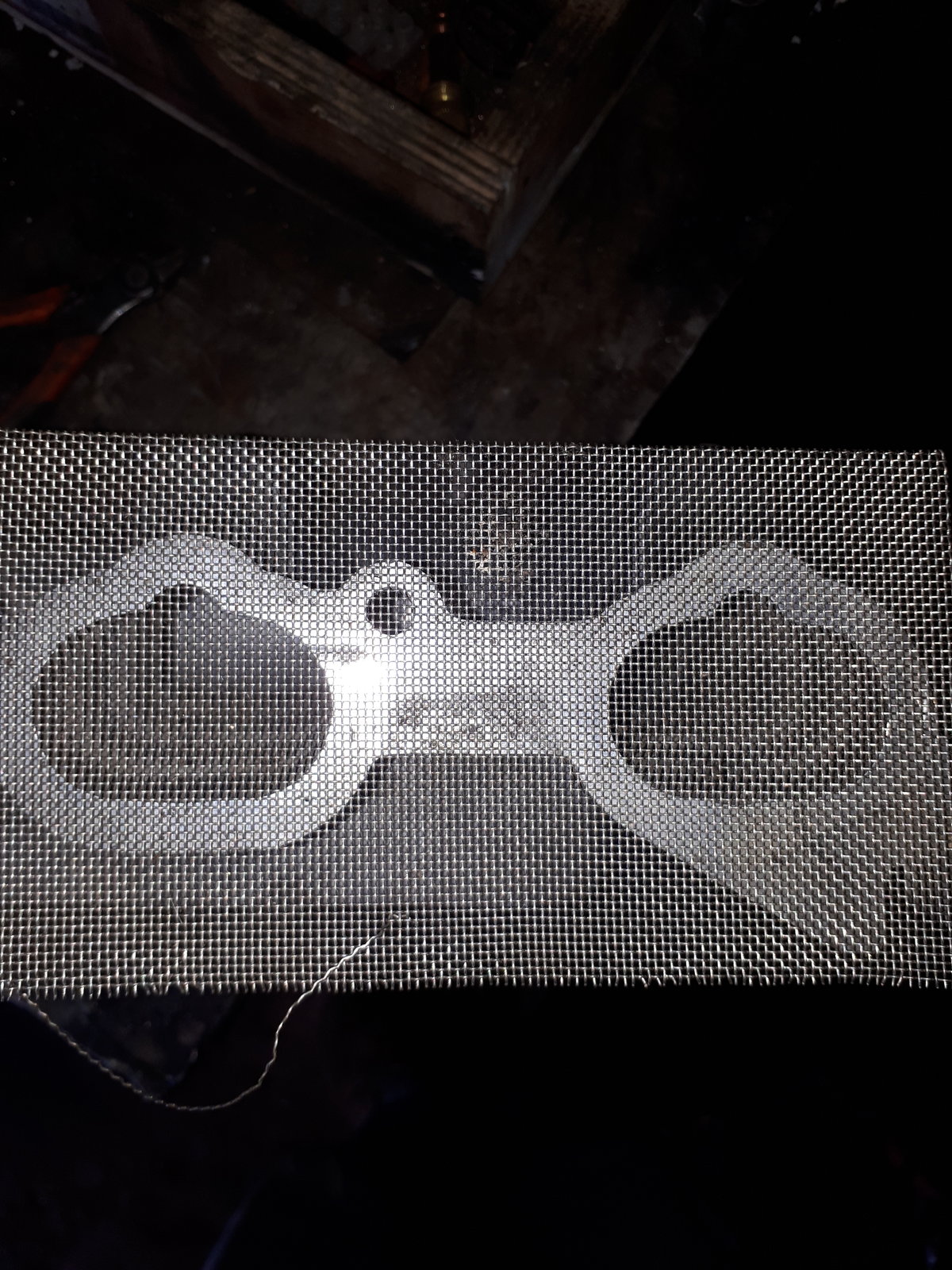

thinking of using stainless mesh as a flame trap on the joint between manifold and cyl head ,they used this on aero engines to prevent lighting up
the manifold and carb in the event of a spit back , it refines the carburation too and doesent restrict the intake as you would expect !
