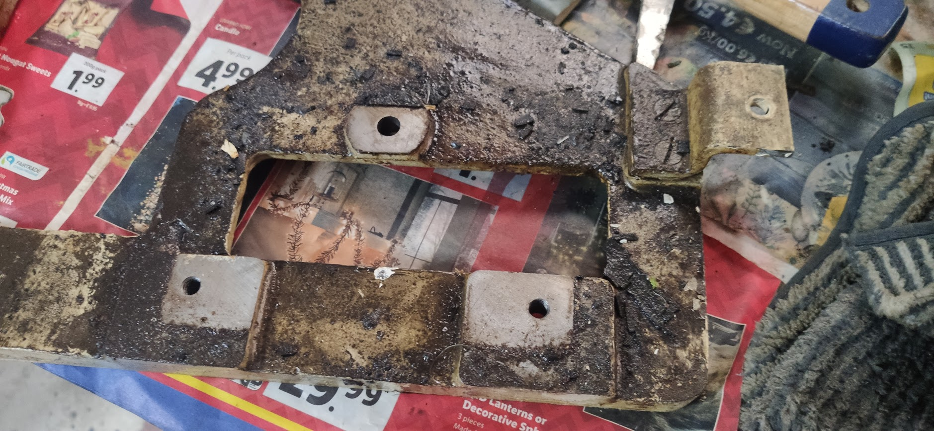

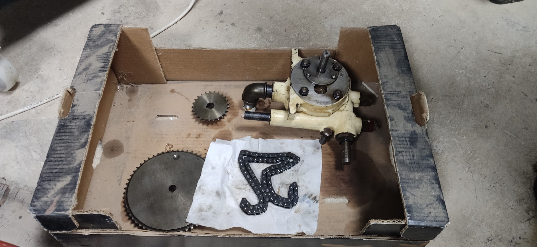

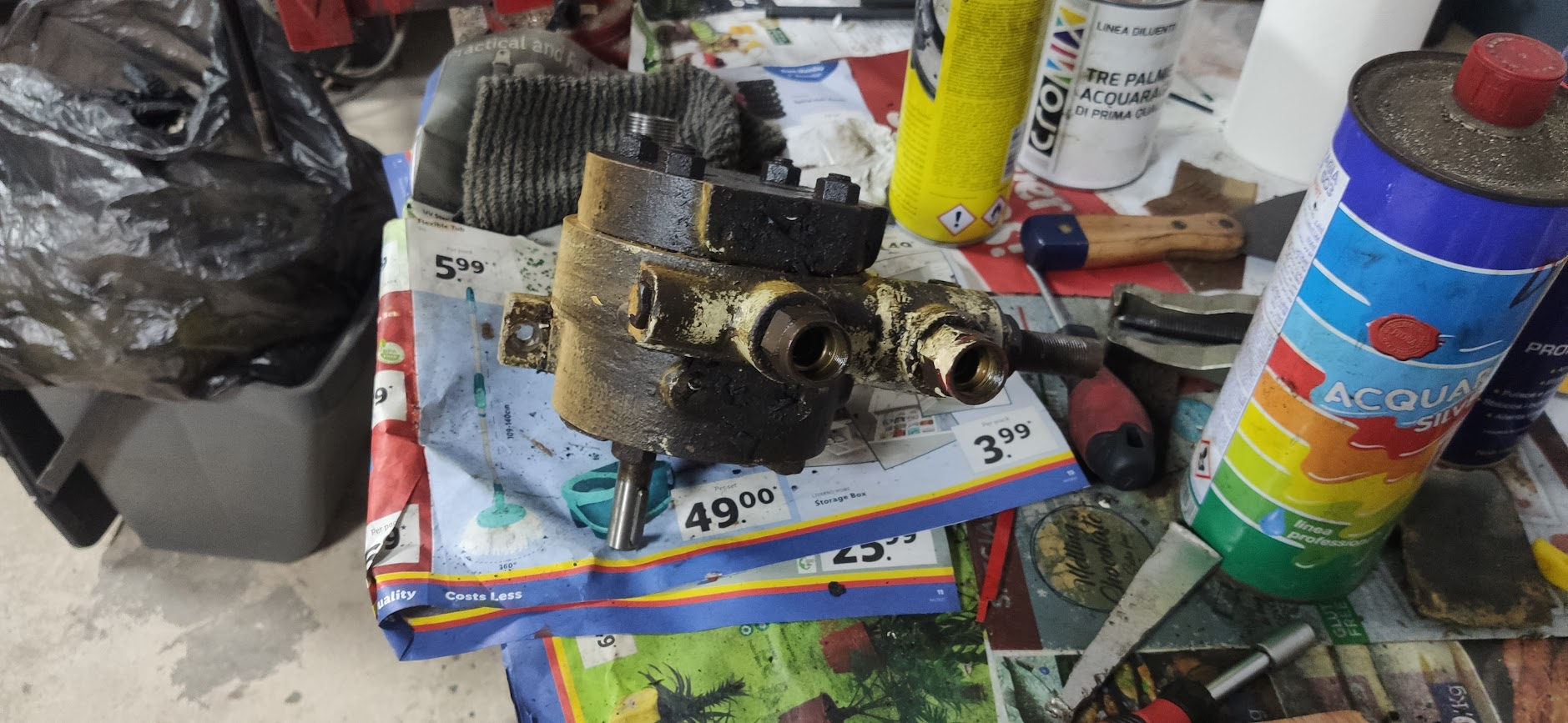

I took my hydraulic pump tank out and found similar slime and blockages, but also the motor was rubber mounted on mine, and the rubber mounts were bad, but generic isolation mounts off ebay did the trick and were cheap.
As mine is a Burdette hydraulic automatic machine (predecessor to the eliott's & J&S designs I believe), information is very difficult to find, but eventually I paid for a manual from lathes.co.uk covering it which is a mine of much needed info such as the hydraulic pressure relief valve pressures on the hydraulic system, running temperature of bearings (its a plain spindle with adjustable bronze bushes) etc. Currently I have a blown hydraulic hose in the knee to attend to and am using it manually though, so its a good time to sort any suspect hoses before its all back together and the dro scales etc connected because of course fixing it post assembly is a pain with all the lines and wiring in place hindering access.

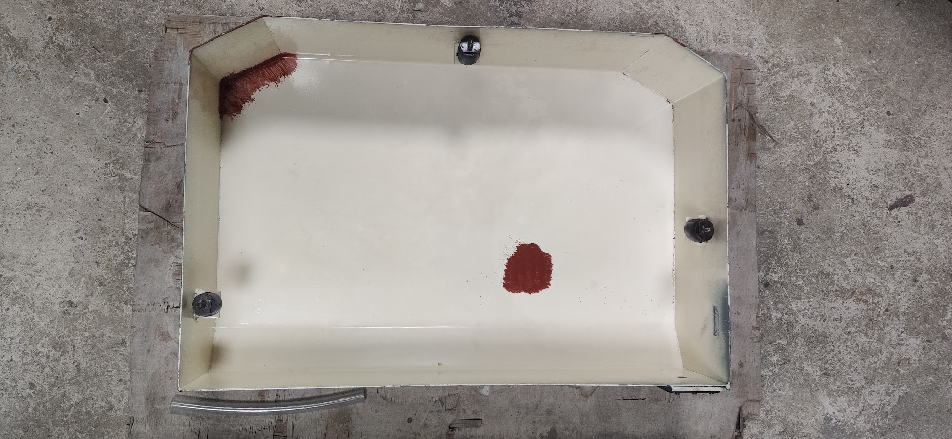

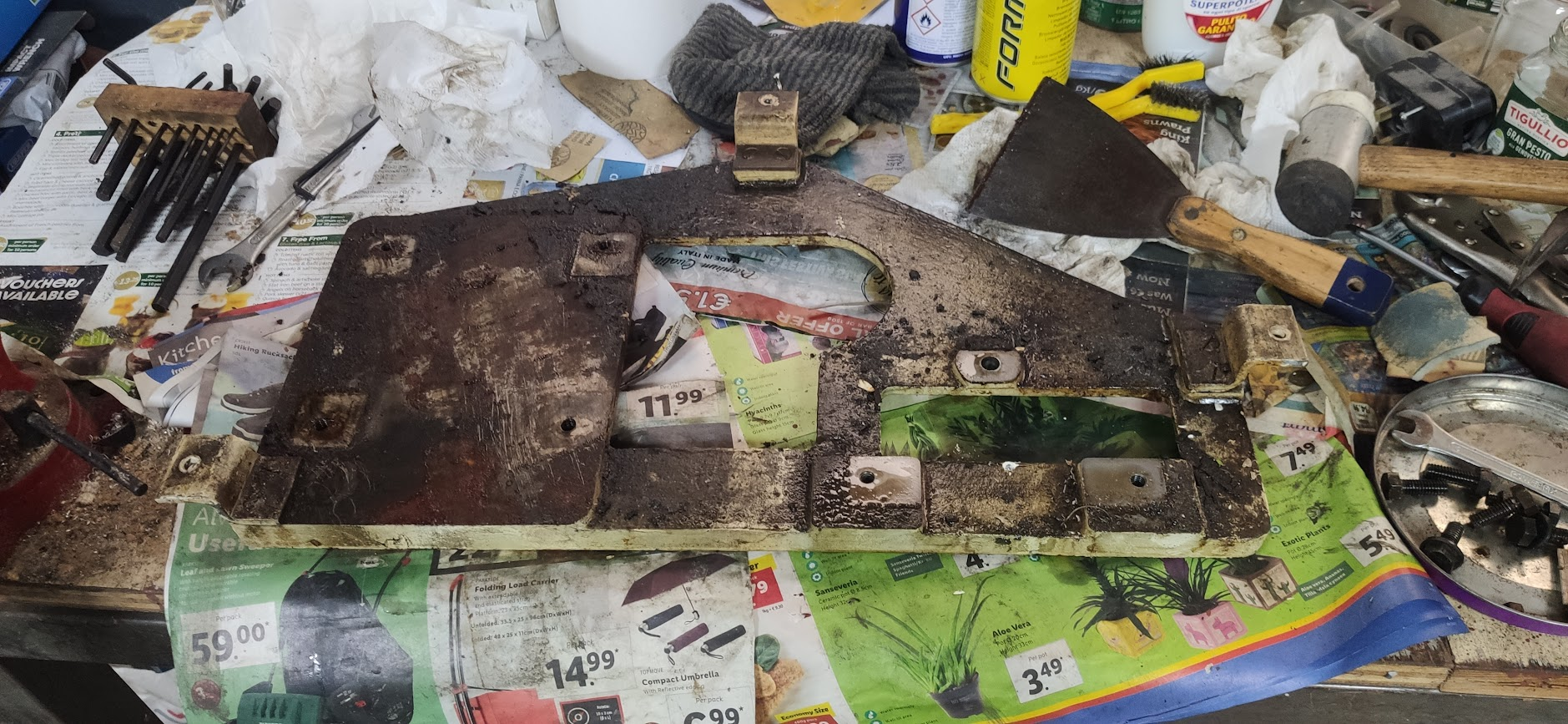

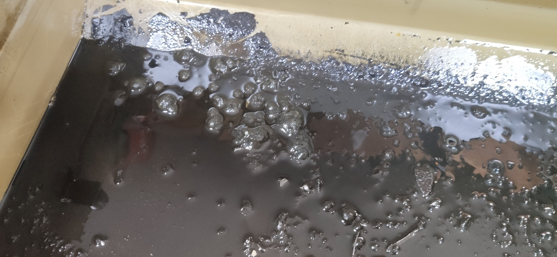

That coolant tank will fill back up of black slime pretty quickly, its just how they are but you know they are working when its in the settlement weirs & just a question of housekeeping to manage it.

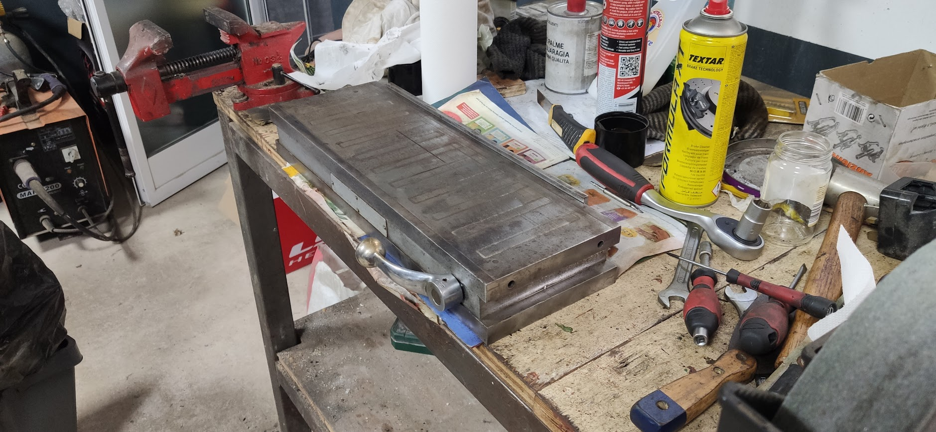

Having a cheap chinese spindexer is handy too, because you can magnet it the chuck or clamp the bed, and set it to a index position to grind on flats or hex etc. Ive used this to grind cutters for my rotary broaches and other stuff. I say cheap, because anything that goes in the worktank inevitably ends up with black grinding slime inside it and I dont want to put a nice tool in there and subject it to this. I also take my mag chuck off for housekeeping because although its a pain to get re-clocked back in accurately, all sorts of horrid stuff gets stuck between the chuck and bed and causes corrosion hidden away otherwise.

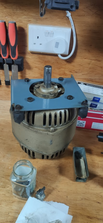

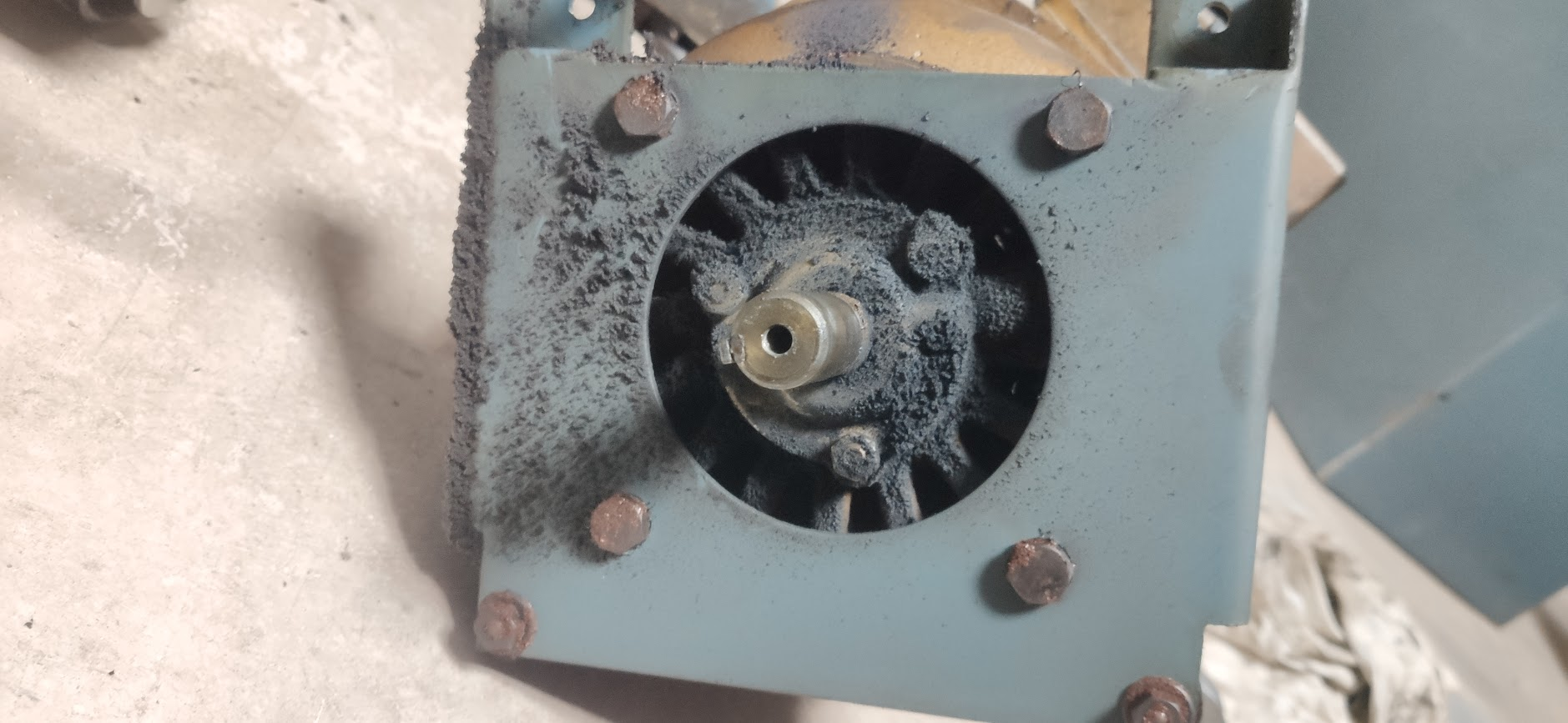

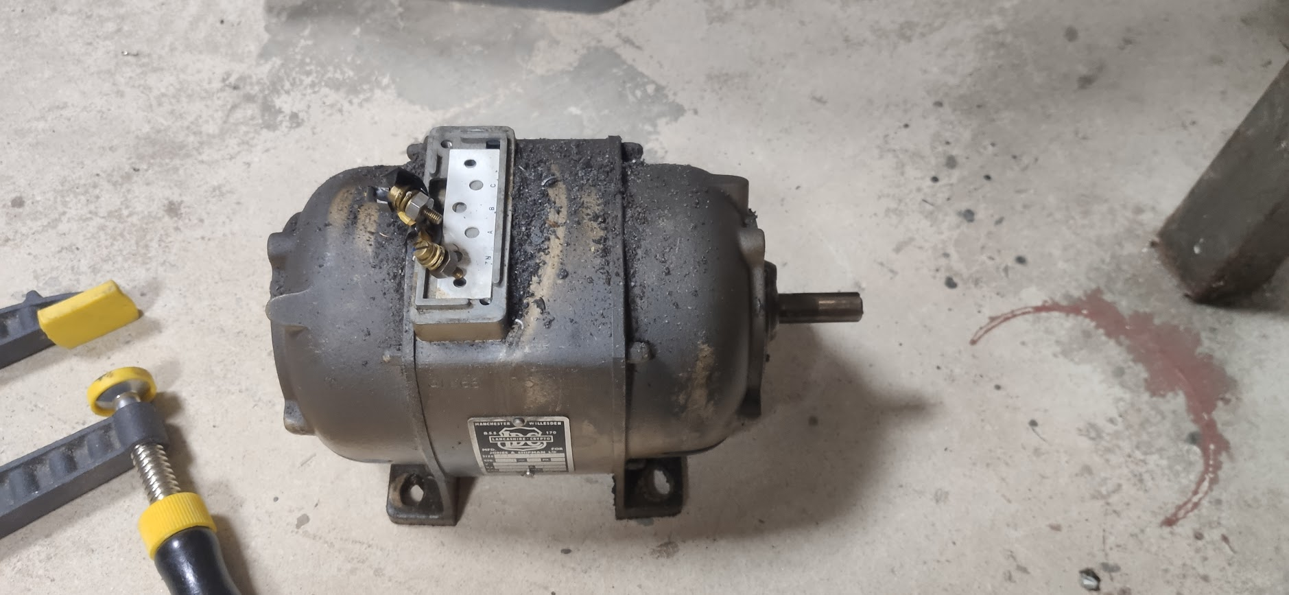

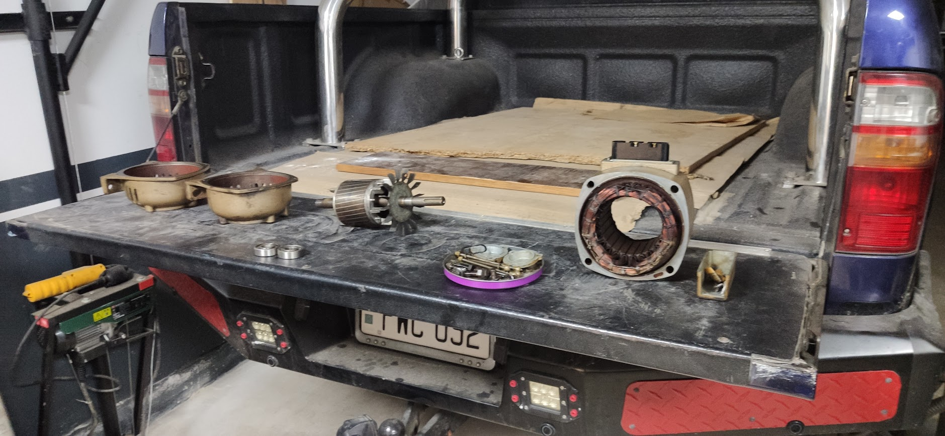

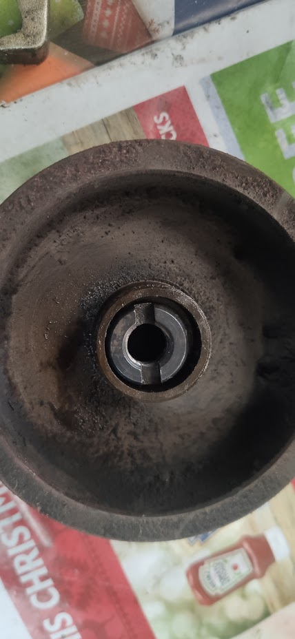

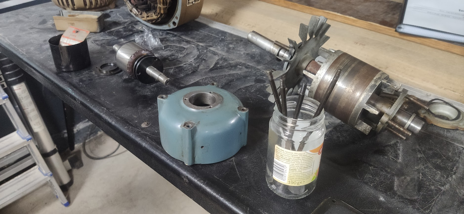

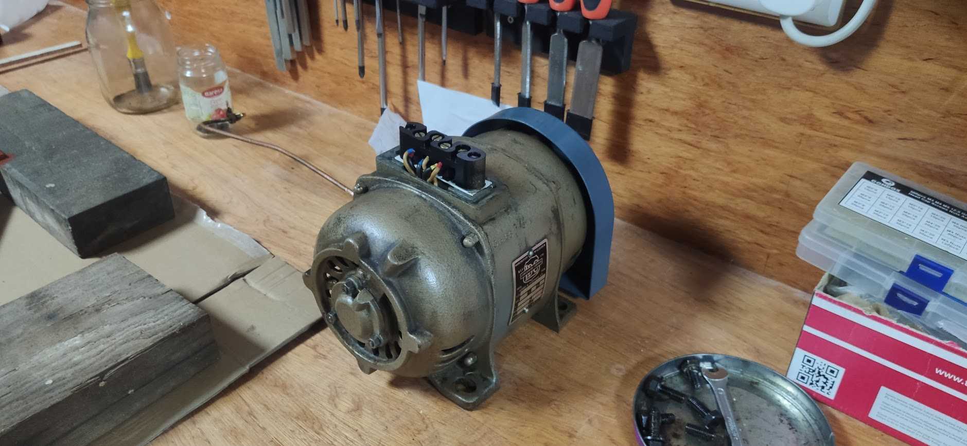

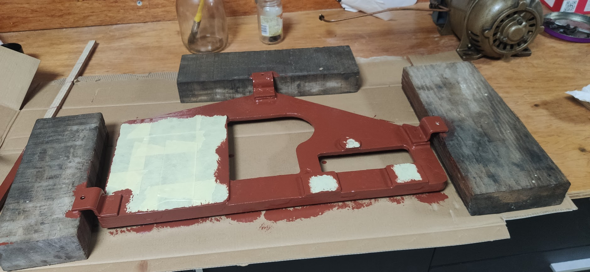

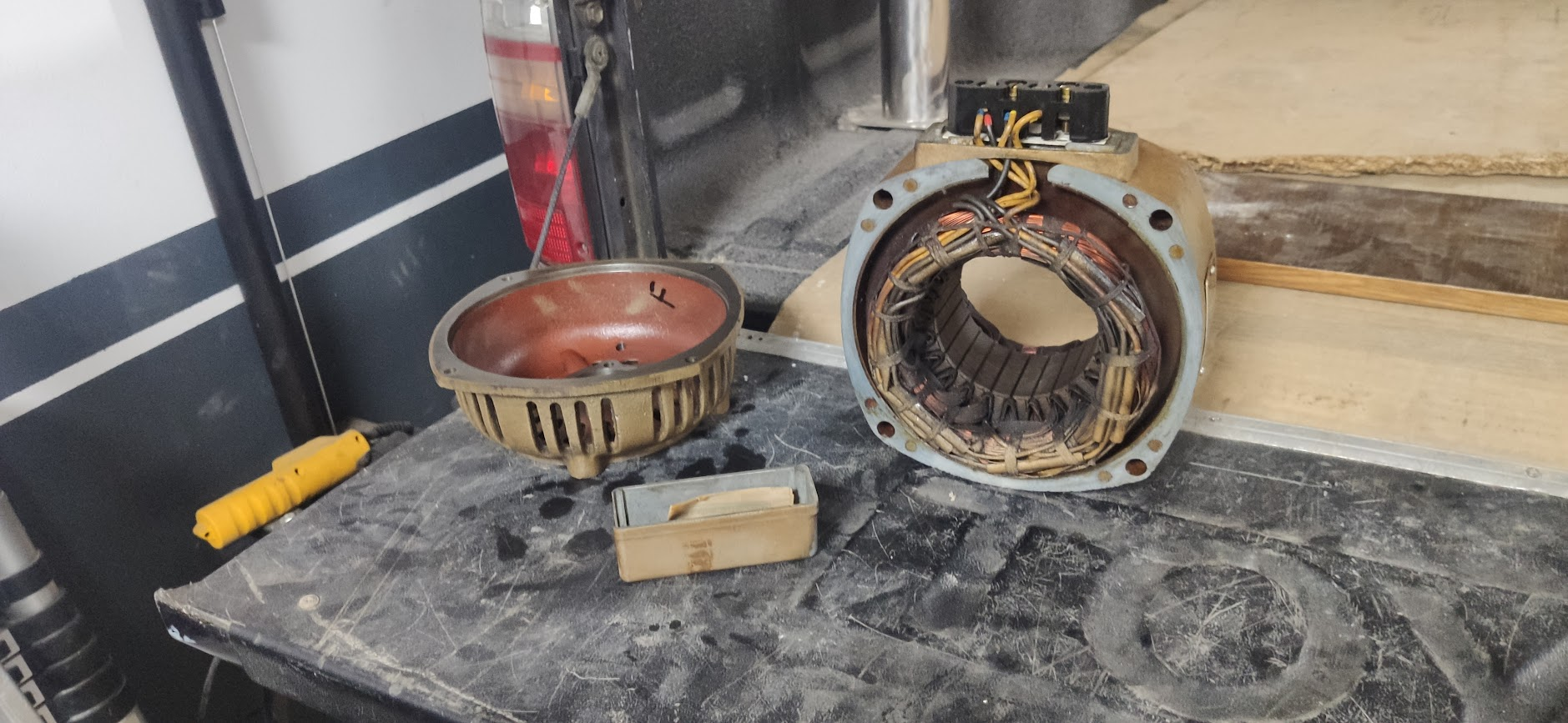

Pulley was a bit of a b**** to get out but i finally managed. Both the motor pulley and the spindle pulley have a lot of surface rust which has been transferred to the belt. Will definitely need to replace the belt. Somehow I forgot to take pictures of the motor pulley and belt

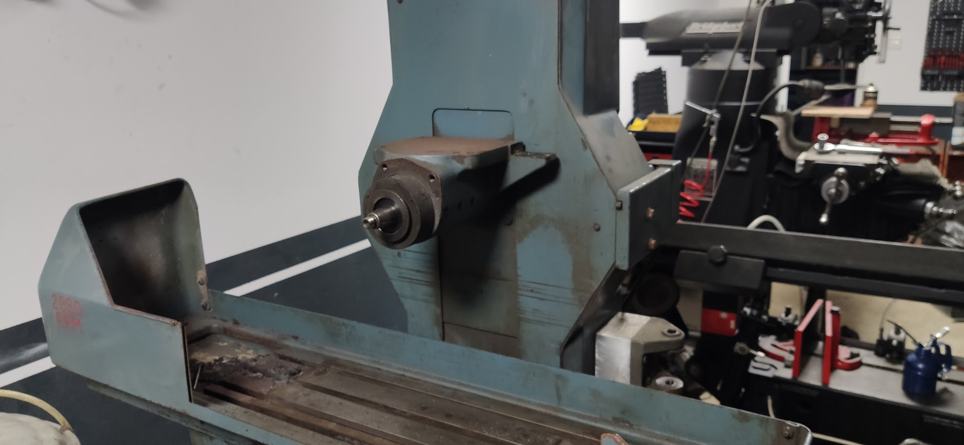

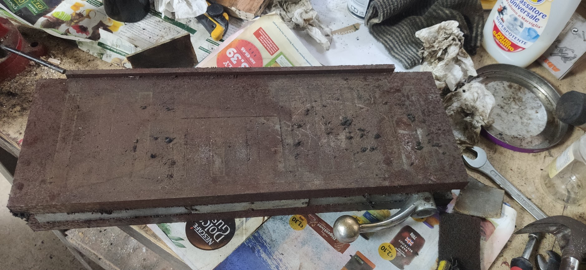

Yeah for the most part the machine seems to be in good condition. There is considerable surface rust on the exposed surfaces and also on the guides that the head column rides on but I'd rather not touch those since they need to be properly set up according to the manual. Will see what I will find once I take the table off as well. I took off some of the oil nipples and can confirm that there is no grease in them so at least the previous owner wasn't one of those people that sees a nipple and thinks its for grease.... either that or he never oiled it... oh well xD

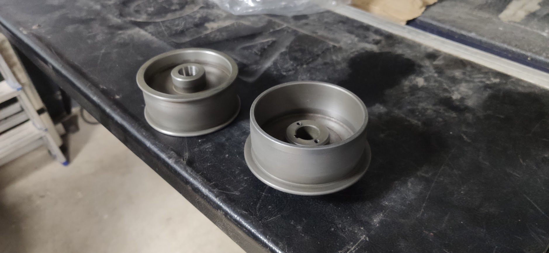

Thanks hehe really happy with how the pulleys turned out tbh.Good work.

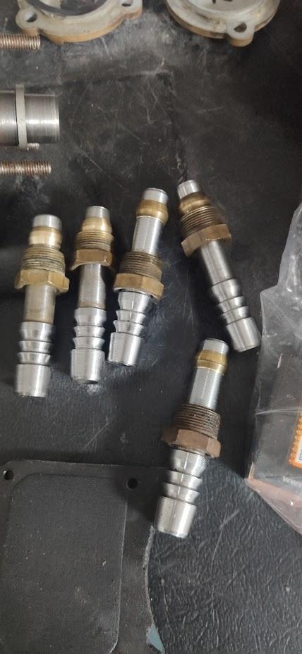

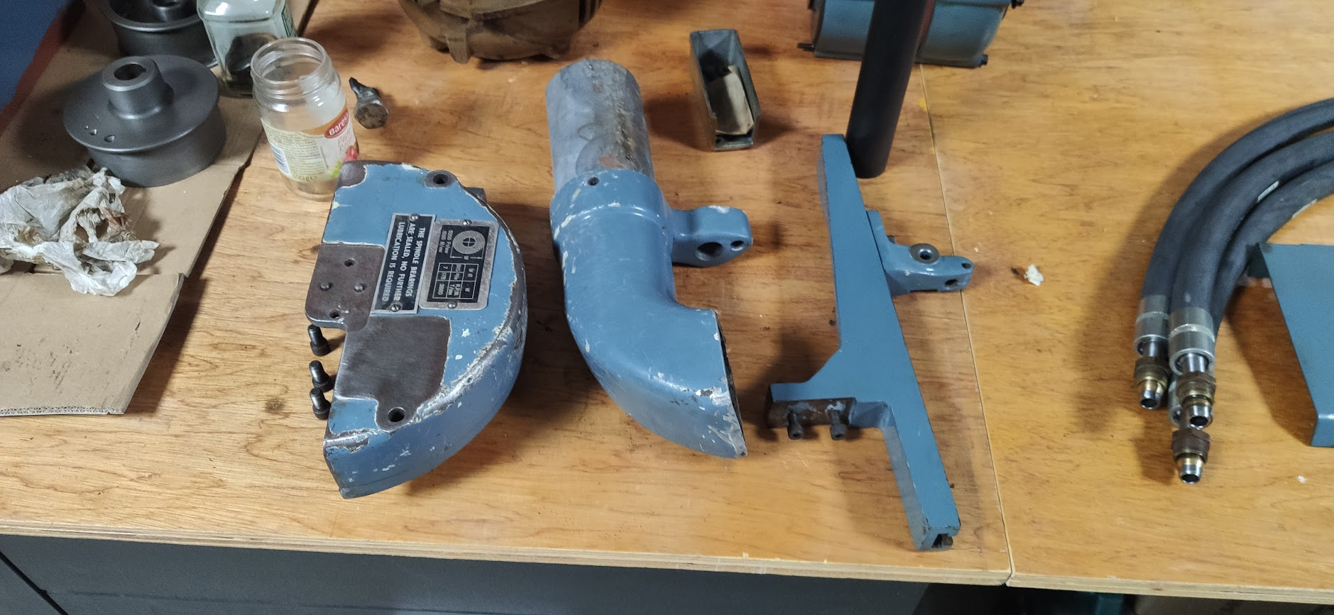

Those hoses look good. The hoses on mine could probably do with getting replaced at some point too.
However, while they are not leaking, I might as well keep using them.
The pulleys look brand new!
And regarding your hoses, yeah if they're not leaking I wouldn't worry too much. Are they still relatively flexible? Mine were rock solid :/

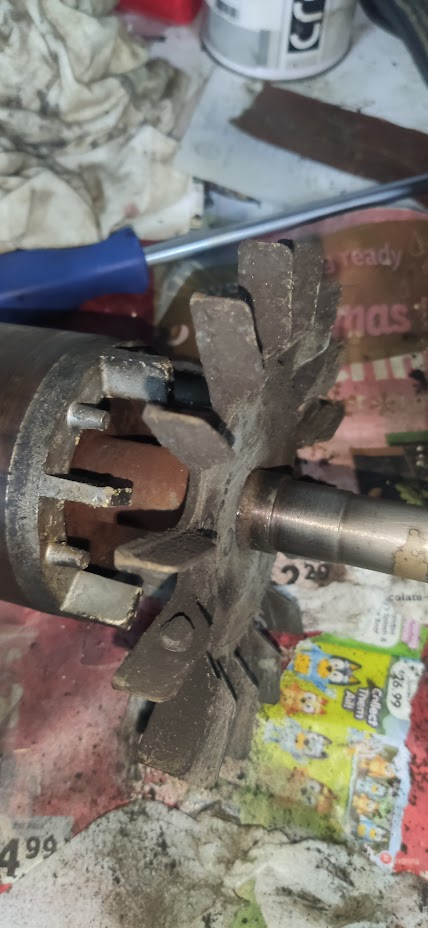

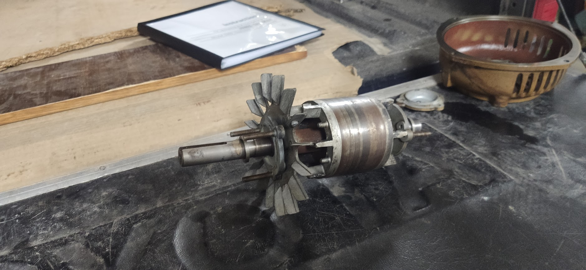

Yeah I did notice the pulleys have some drill marks, and even the motor armature seemed to have some weights on the fan. Didn't touch that so should be ok.Good work on the hoses.
Be aware that all the drive elements for the spindle ( motor armature, drive pulleys etc, spindle irself ) are all carefully balanced and even a slight imbalance can introduce herringbone patterns on the work.
