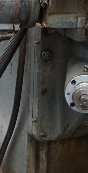

Mine isn't like that, it has two locking bolts, which I assume are bigger versions of the saddle one which I made a replacement for. They have short handles on them to lock the Z. To be honest, I don't think that there is a huge amount of wear in it.What is the serial?
You can easily tell by looking at the front of it. If it has this kind of style bolts with a castle type ring round the cap screw then it has the adjusters in.
I'm not entirely sure however how it actually adjusts, if it has shims in or just varies how tight the rear strips are clamped on.
If the rear strips are attached with _just_ cap screw bolts (like mine) then it has no adjusters and you'd have to take material off the mounting face of the rear strips to tighten it up. Although actually I think it would probably be better to add a turcite strip and if need be add some shims. It would of course depend on where the wear was.
