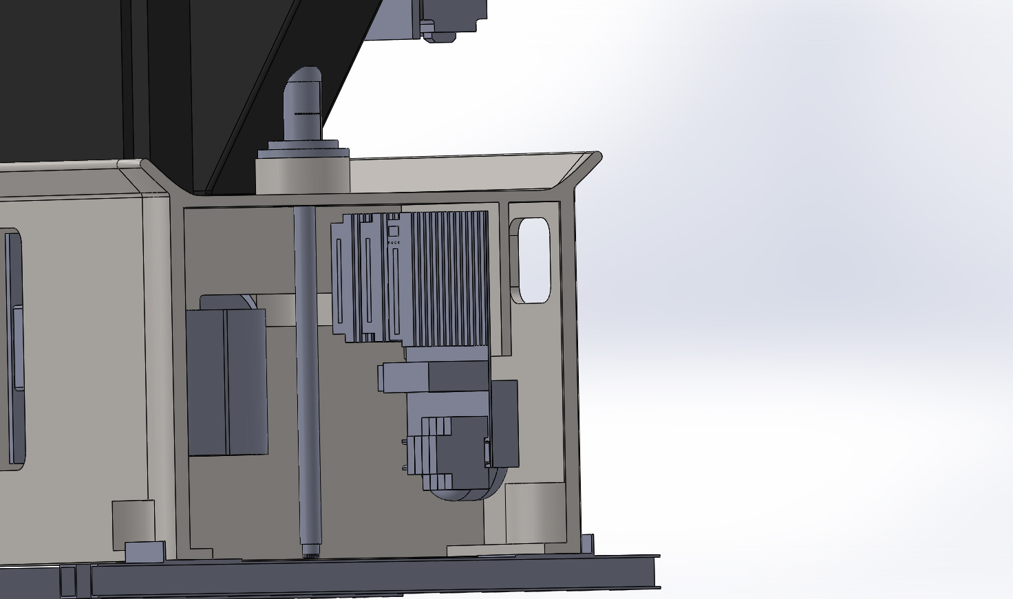

We'll take the axis in turn. Firstly the Z.
Now Andy used a driven nut. This has the advantage of being neat but the disadvantage of being complicated. On looking at his model I thought...Hmmm, I think you can get a suitable sized motor into the knee.
That is an 8.5Nm NEMA34/86 hybrid stepper. In theory it should work fine 1:1 as it has more torque than Andy's setup but I can always run different ratios if that's not enough (as well as for more steps per mm).
From there we needed to drive the shaft itself. Unfortunately the existing setup isn't suitable to replicate. It used thrust bearings and ran the shaft directly on the casting. Being very slow speed and into cast iron this works perfectly fine. If there had been a bronze push instead I may have considered using it anyway.
It's not fine to run at high speed and with the tension of a belt on it. Unfortunately there isn't much inside the knee to bolt a bearing to. The round section there is bridged to the front so you can't just clamp something on and the casting isn't really flat enough (anywhere) to easily bolt into. This is one where if I had other machining capability it would be easier. If I could reach down in there for example and flatten the casting so it was square I could use it to bolt to. That would need some fairly hefty machine ability though.

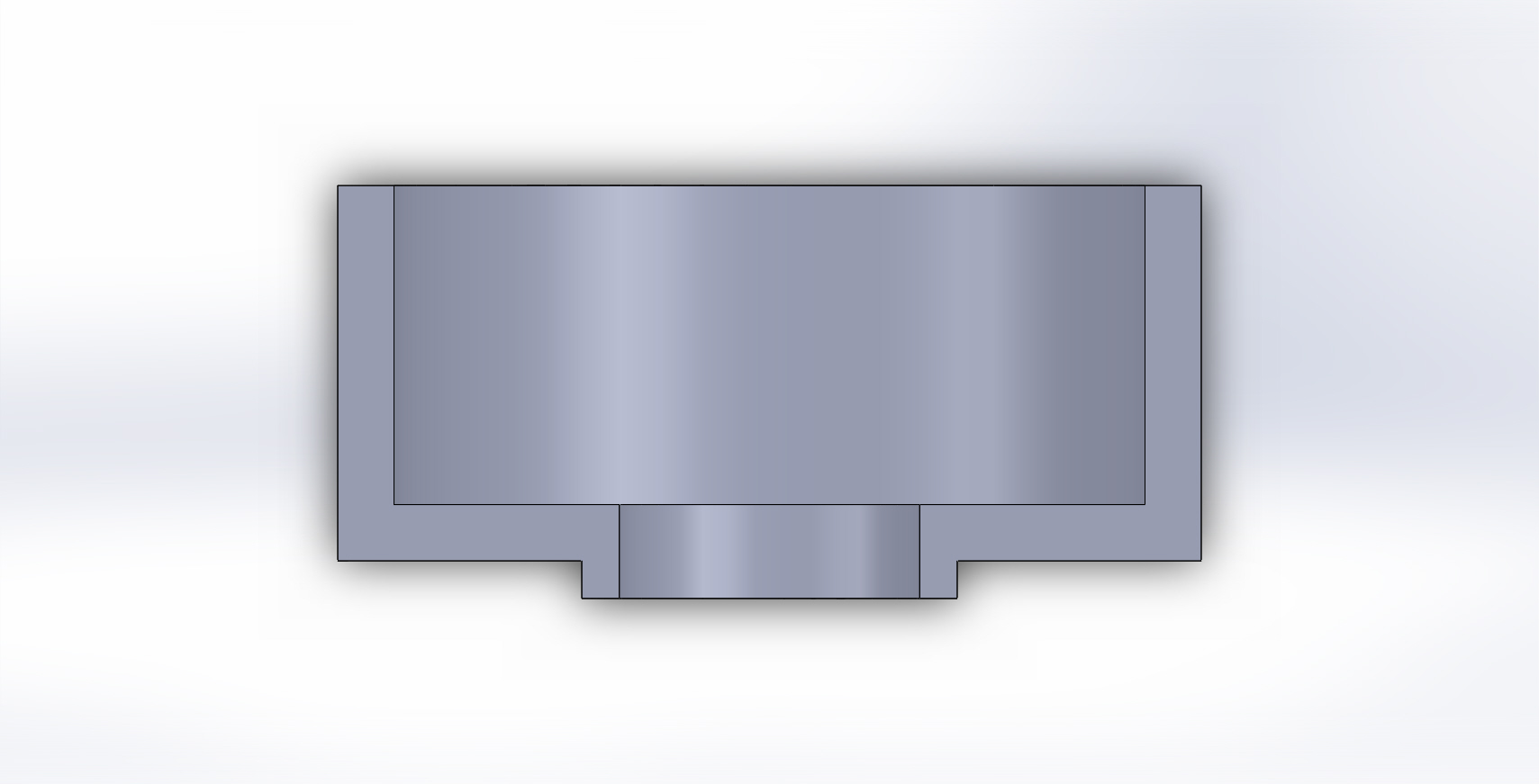

So I settled for making bearing holders that with a lip that would sit top and bottom into the hole for the original shaft.
This is of course where the lathe came in and appropriately as previously mentioned it's a Harrison lathe as well.
A couple of cups machined up.

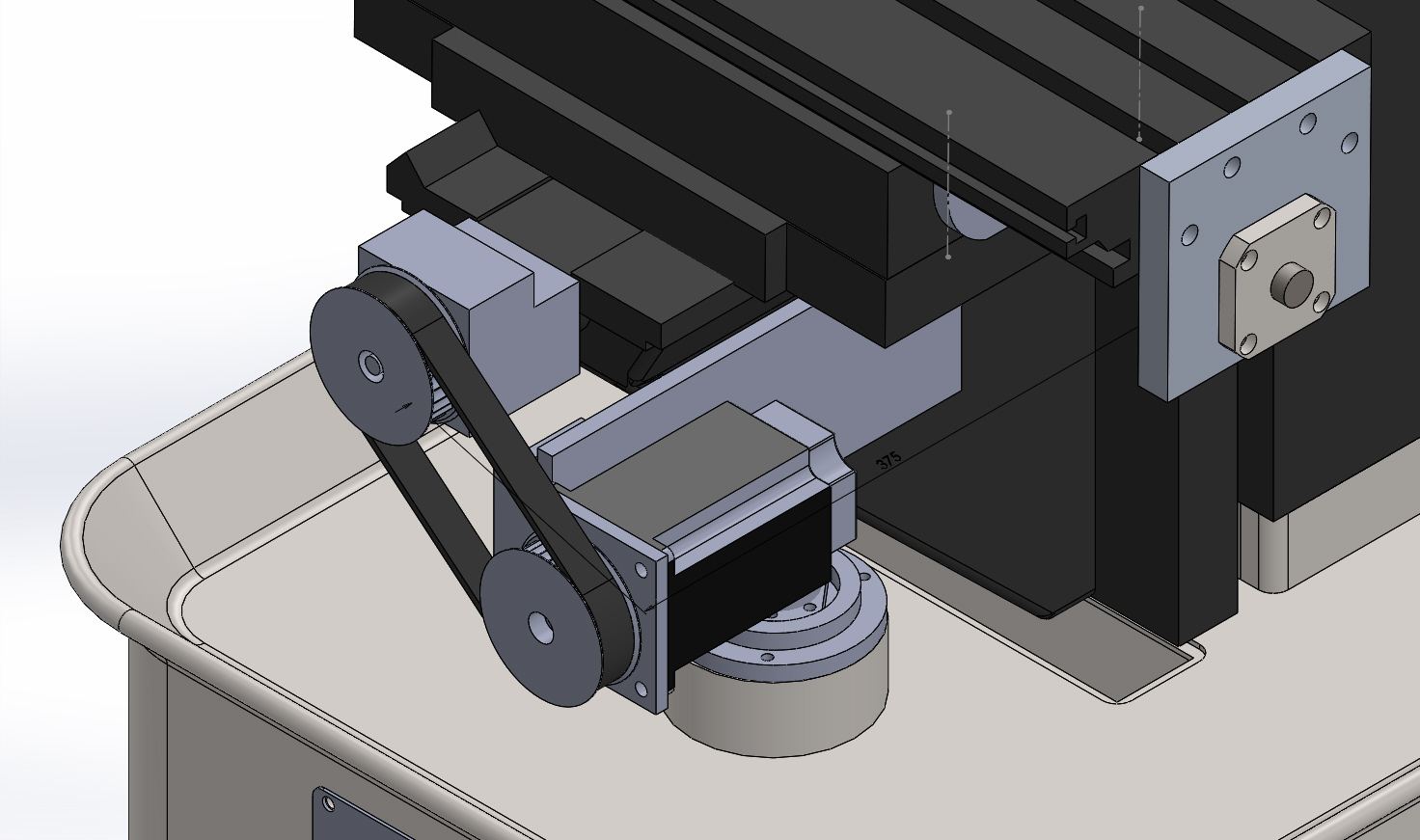

Next up I needed to hold the motor in place and also to tension the belt. To do this I made up a mounting plate with a holder for the bearing carrier and a eccentric tensioner. The tensioner is required because the motor literally cannot move. It has one position and can't get a belt that is the correct length.
Mounting plate from the bottom.
and with the motor in place.
What you can't see there is the bolt through the side to hold it all in place...Which was fun to transfer over to ensure I got the correct position!
To account for belt tension (because the side I had to work with fell between belt sizes) I used a pair of bearings on an eccentric mount. The tensioner is on the "slack" side of the belt, ie under normal use the weight of the knee will naturally tension the other side and there should be very little force on the tensioner itself.
