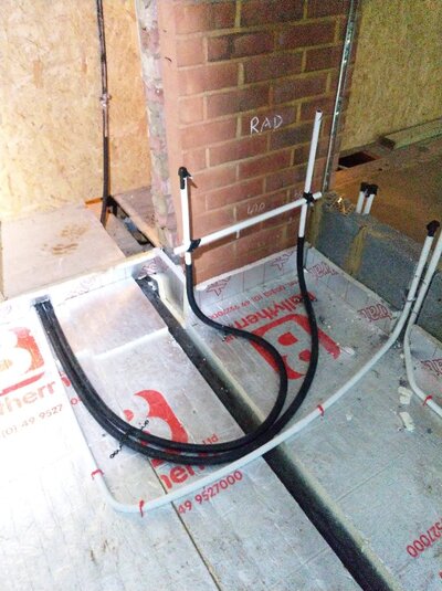

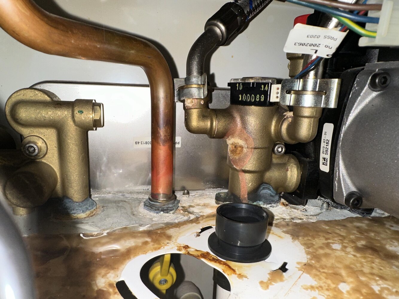

Daughter has no money ? I she eligible for a new boiler heating grant or financial help as the old boiler is now 12 yrs old & often come into the government warmer homes replacement schemes , My 39 yr old oil fired boiler was microbore and all piping was removed as it is not effective in getting enough water to the new double rads . All new 15 & 22mm pipes were surface run through the roof void ( we have a large bungalow) , where they did have to drill the walls there was very little mess on our two day old new carpeting which was easily sucked off by my heavy duty vacuum cleaner .Daughter inherited grannies house recently. Heating is knackered. It has a leak on a brass valve bit. Repair man says its not cost effective to repair. Its an ideal logic of 2012 vintage. It was installed during one of those campaigns headed by johnny ball that ripped off old people. The previous heating was the old back boiler type installed by council in 1984. Anyway it still has its original radiators and microbore piping.

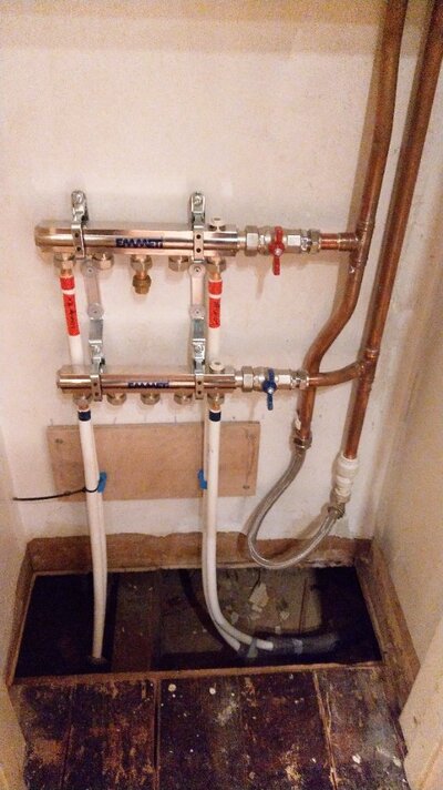

Daughter has no money so I'm paying. What can I do myself to reduce costs. I suspect its pointless trying to keep the rads and pipes, nothing has been serviced or flushed ever. Can I just rip out the old microbore and put plastic or could the layout be different considering this layout was for an old system.
