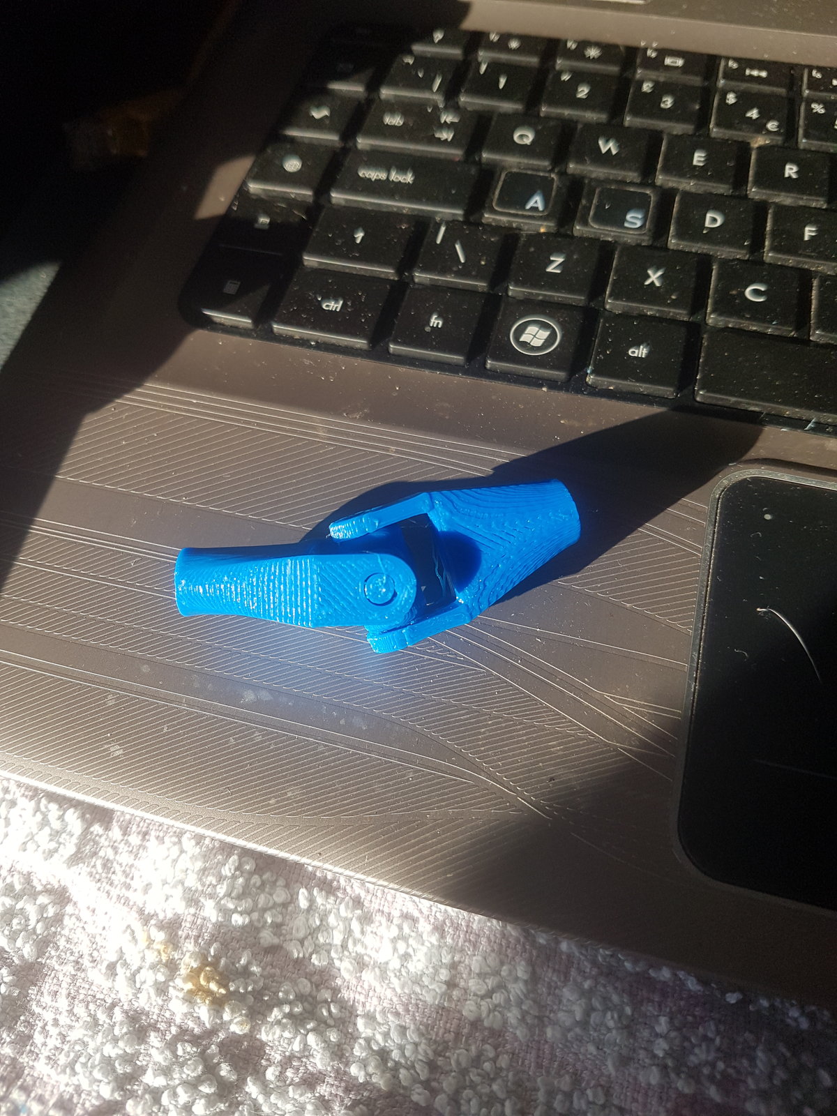

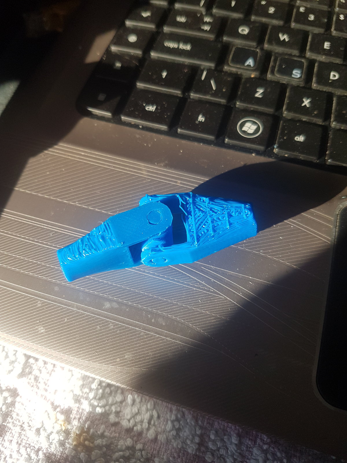

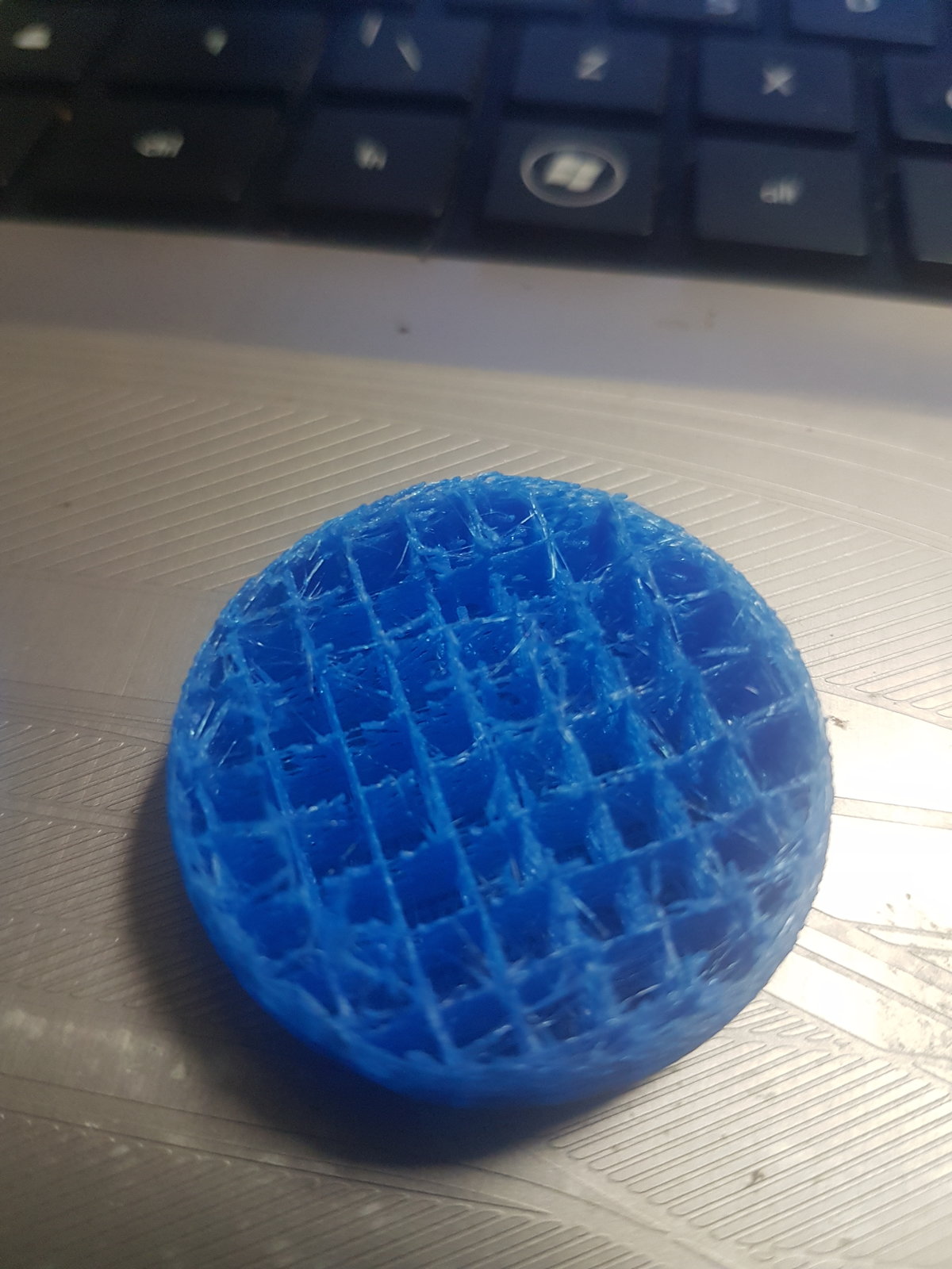

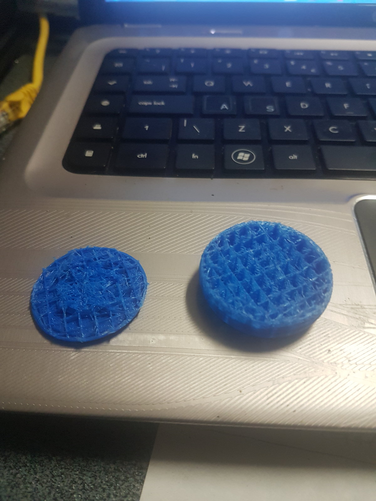

What is extrusion calibration?Maybe a little too cold, check your extrusion calibration too.
You can read some articles on calibrating for close fitting parts.What is extrusion calibration?
^ Yeah but for most of us we don't need that unless doing close fitting or precision parts.
Out of the box with standard setting it is extremely unlikely......unless it's been messed with.Or you want parts that don't fall apart when you use 'em![]()

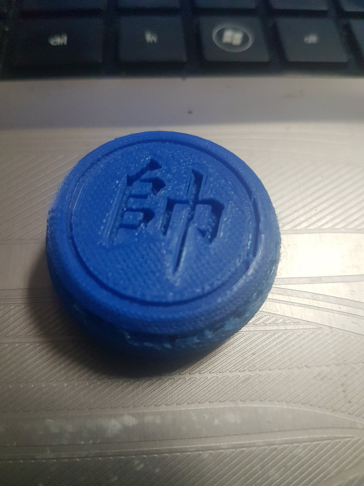

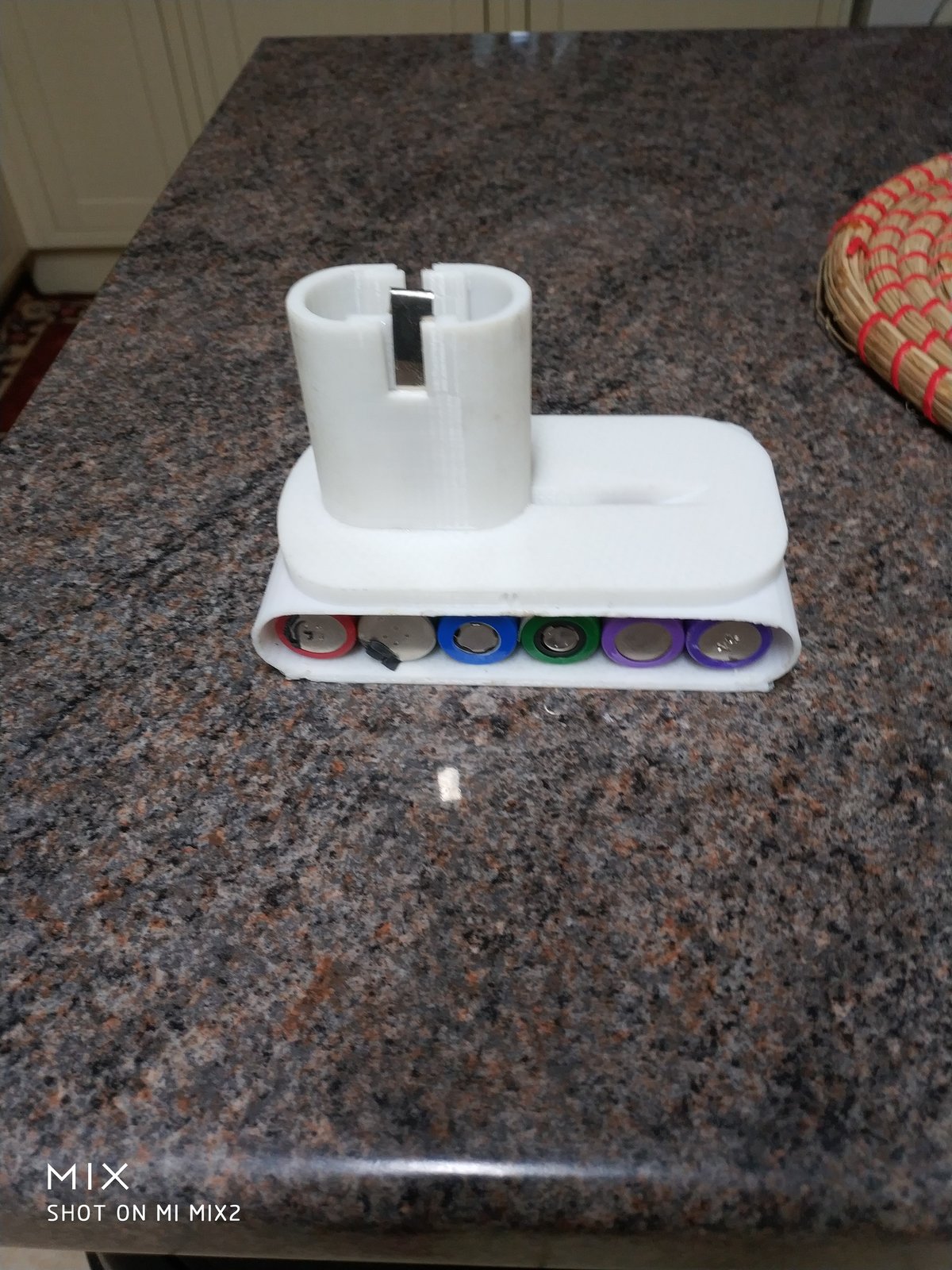

Just printed this at the file settings.You can read some articles on calibrating for close fitting parts.
Out of the box it should be standard and work though, but if you were printing letters in one colour and printing a separate piece with holes for them then calibration becomes very important.
However, if your bed is level and everything is "out of the box" setting it should work reasonably.

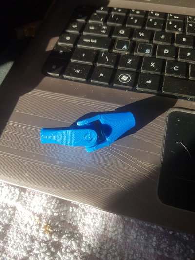

The below is a small file I drew / printed successfully, feel free to give it a try if you wish. Delete the .txt on the end to be able to use it as is (this is the gcode file of a successful print taken straight off the SD
Mine has thankfully....so much to learn its a minefield...i think i prefer setting up networks. And thats a dark art. LolOut of the box with standard setting it is extremely unlikely......unless it's been messed with.
Strangely it did click ...but like before only when doing the base layers....is that normal?No clicking and underextrusion this time?
