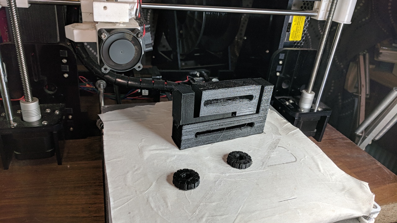

Ok so spin up Cura again if that is what you are using
0.2 layer will give you 4 hours
0.3 layer maybe 2.4 hours
Obviously courser finish
10% fill would be tolerable
Have a look at shell or wall thickness
I have seen a 0.8 or 1.2 take upto a third longer than a 1.0mm shell / wall thickness on hollow items
Do you know about using multiples of the nozzle width for shell thickness?One thing I've noticed, using a 1mm using a 0.8mm shell, and 10% infill results in a VERY weak print - like a pink wafer biscuit.
1mm 20% is a LOT stronger.
I think for the tool holders, I'll be using maybe 2mm / 40%
You need a thicker top layerOne thing I've noticed, using a 1mm using a 0.8mm shell, and 10% infill results in a VERY weak print - like a pink wafer biscuit.
And then you could also get into considering dimensions of your object to layer heights, for example with a 0.3 layer you might print something 30mm thick accurately but not something that was 31mm as you could only have 30.9 or 31.2 - unless the gcode generation figures it outDo you know about using multiples of the nozzle width for shell thickness?
So if you have a 0.4mm nozzle your better having a 1.2mm wall thickness rather than 1mm.
Yes.Do you know about using multiples of the nozzle width for shell thickness?
What's the white stuff on your heat bed?
4" wide masking tape of some type.What's the white stuff on your heat bed?
