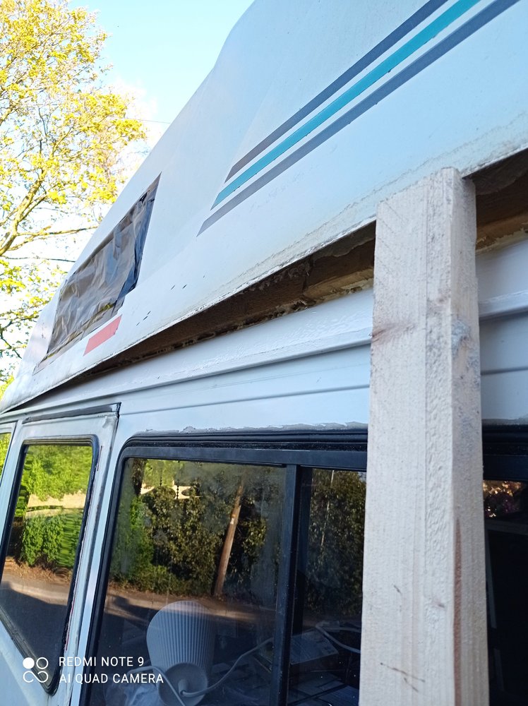

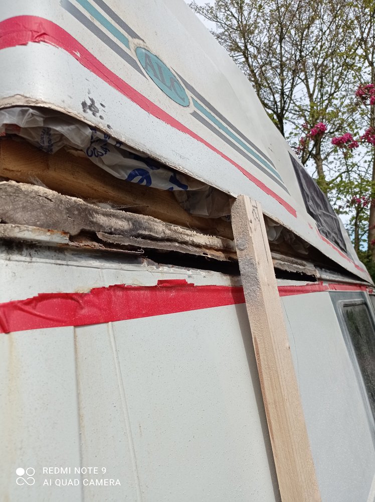

As @Stuartg1 said I’d expect that to be bonded. A multi tool will make short work of it. You can actually buy a blade for bonding.
Not being a doom monger but it’ll be a can of worms. However, do it right and you’ll get plenty more use out of it
So it’ll be worth it in the end.
Once you strip the head lining you may well find some fixings but I’d expect bonding myself.
