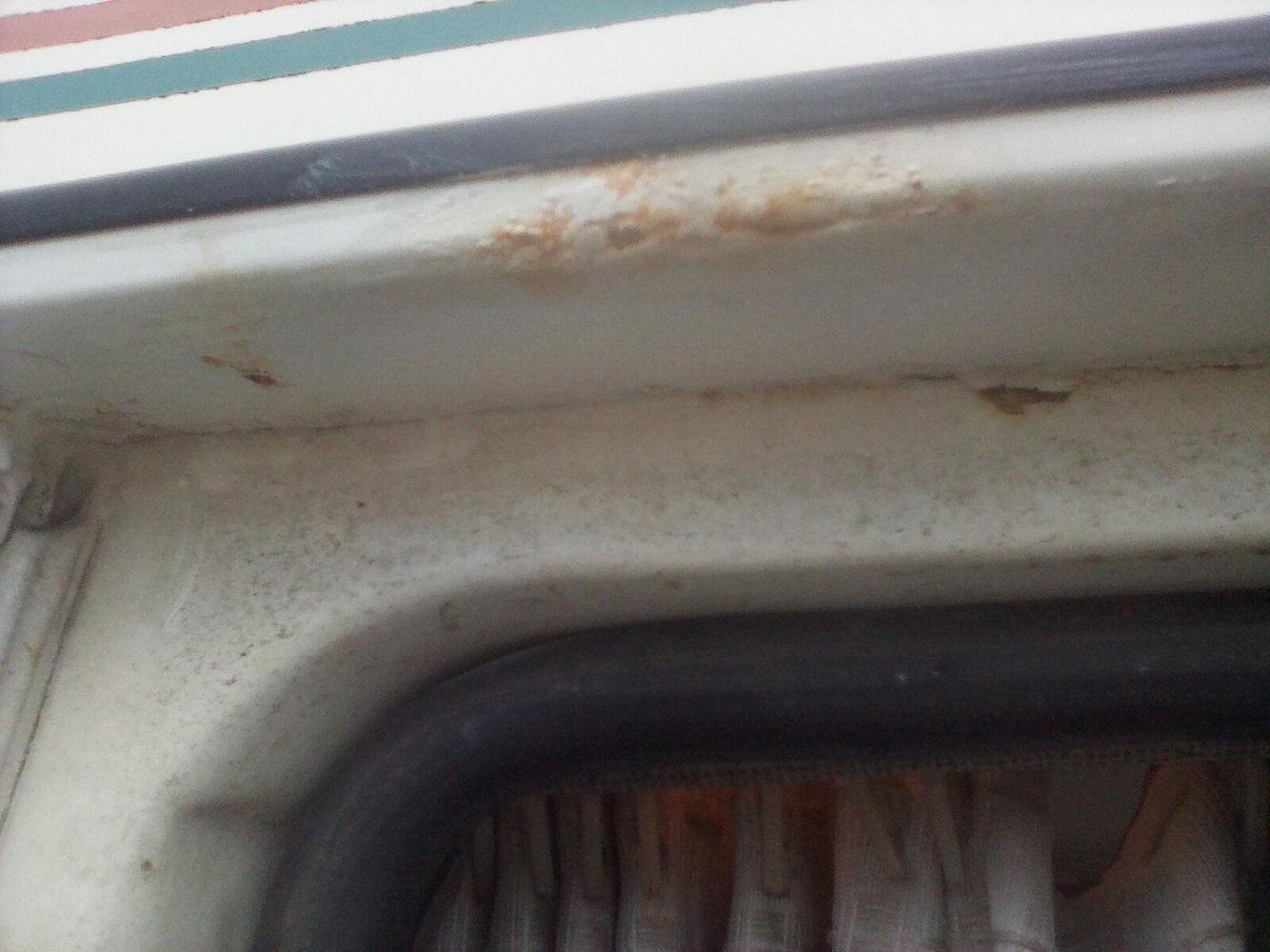

Fiat Ducato, 30 years old, Fibre glass Elddis roof.If we're talking about a VW camper van you can get the panels to repair the gutter/roof above the door:

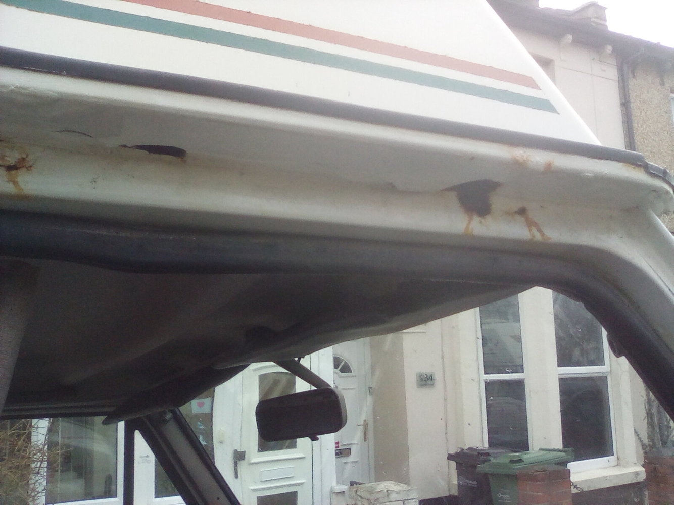

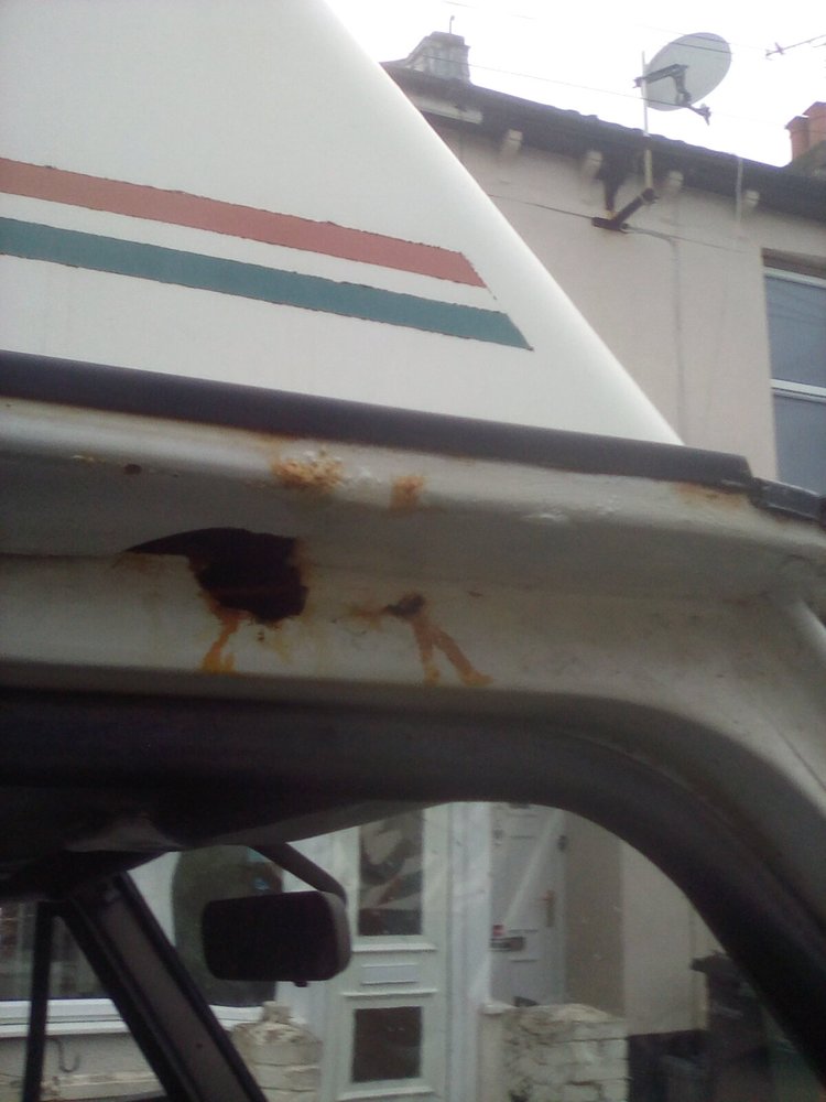

Plenty of other things needed repair! This was a bit of a afterthought I think. The only obvious rust is above the door. Only a cm short of what you say is B pillar, so, yes, needs doing.Sounds like it may be eating its way down the B pillar, by the wording "just scraped it through an MOT" and that by the time another 12 months have passed it will be too late without 'surgery'![]()
YepBest get some photos tomorrow, me thinks.
Thanks. I'm assuming the internal roof is a separate skin to the external one. How do you get a neat finish on the cut out bit?As above really Cut the fibreglass away weld then glue back together, I have a similar age Talbot you will find a bit more rust but its all repairable, if you need parts and have a pattern Weldingwood on Facebook is fantastic, he remanufactures mostly Landcover bits but would make you a gutter repair patch. The Repair panels from Costal Motor homes are good too, some others on Ebay etc are very poor
