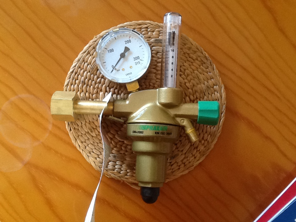

what evidence do you have for this? from what i can see the machine is welding but there is little to no gas flow, which to me and most others here says that either the bottle has run empty, there is a blckage somewhere in the system or there is an air leak that is dragging atmospheric air into the argon and diluting it
You sure they are not checked? That's not what I was told.!Is your machine new? If so its almost certainly a problem with the set, as none of the R-Tech sets are checked before despatch, and seems like DOA or failure within a few days is pretty common.
Has it worked fine until you added a regulator or changed something?Looks like what you are saying is the problem Chris.Yes the machine l bought it new l have it for a some time now. And now l got a regulator with a flow meter. Thing is that the melting on the first day was perfect it was doing it properly and the next day it was not melting it was even burning the tungsten. Have to give R-tech call then.?
It is a fact electronic based equipment has a high early failure rate....tested or not.....but I was told by R-tech that they rework the machines replacing some parts to their own spec.i was trawling through google looking for reports of dead machines and can't find any.... my 161 is great as is my r-tech plasma cutter and stick inverter. definitely a lack of gas, perhaps a sticky solenoid or as BB says a leak somewhere or air being drawn in....
