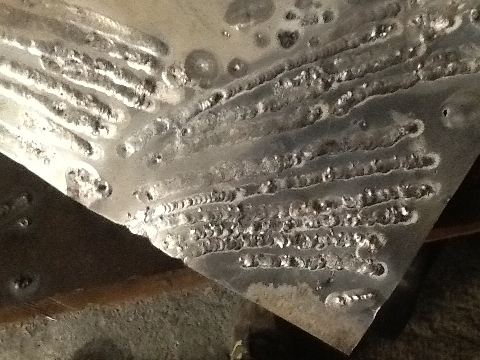

Pic1) 2mm aluminum sheet started good doing the melting pool.View attachment 73073

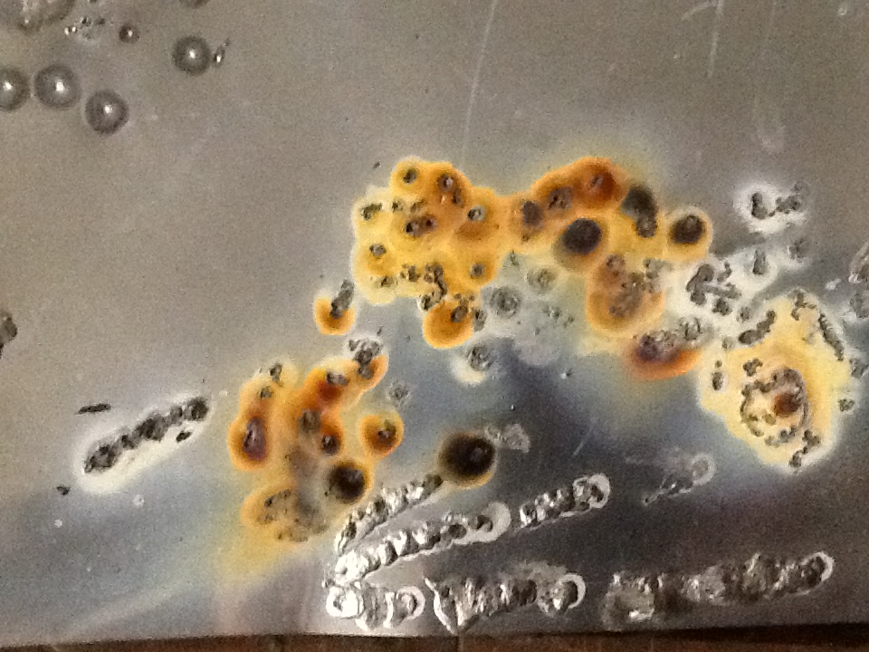

Pic2) The next day l carrion practicing then this happened.View attachment 73072

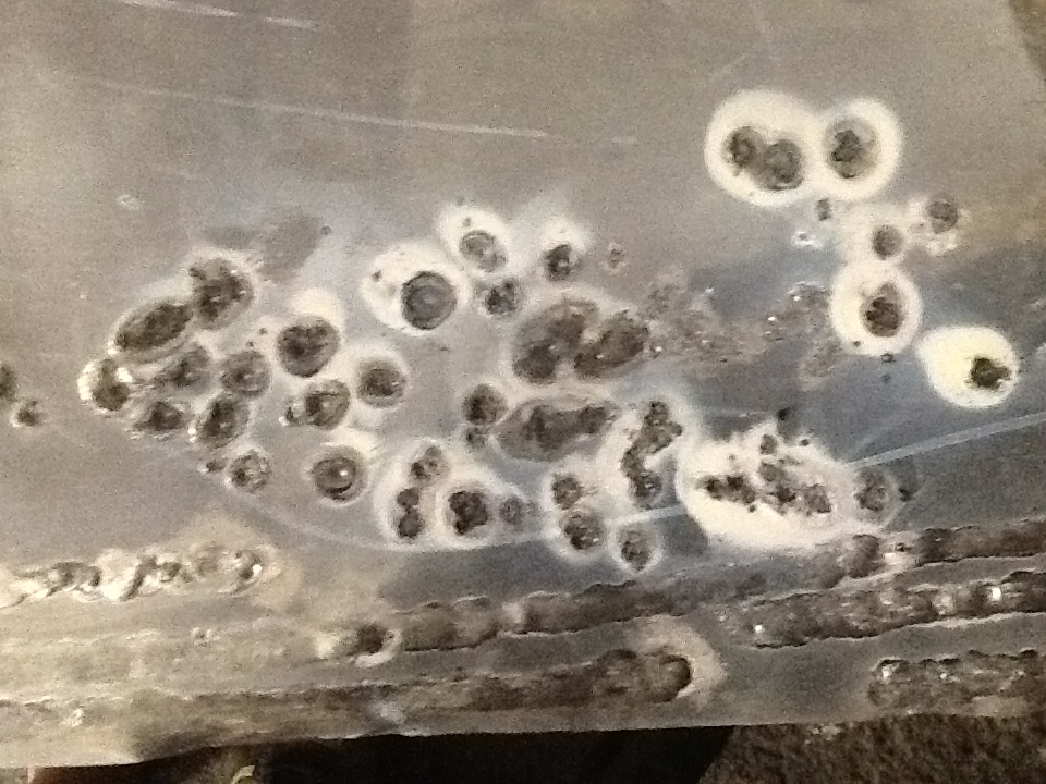

Pic3) l checked with the hand trigger.
I yous'd the blue stunystan could be contamination or l have a problem on my R-tech 161amps.
Just checked the gas flow is ok.Is your gas flow ok? the soot looks like poor gas flow/coverage
Is your machine new? If so its almost certainly a problem with the set, as none of the R-Tech sets are checked before despatch, and seems like DOA or failure within a few days is pretty common.
What do you call ok? What lpm? And are you using pure argon?
Looks like what you are saying is the problem Chris.Yes the machine l bought it new l have it for a some time now. And now l got a regulator with a flow meter. Thing is that the melting on the first day was perfect it was doing it properly and the next day it was not melting it was even burning the tungsten. Have to give R-tech call then.?
deffo looks like you have run out of gas, or have a gas issue of some description.
No it was okIs your gas flow ok? the soot looks like poor gas flow/coverage
Yep argonWhat do you call ok? What lpm? And are you using pure argon?
i was trawling through google looking for reports of dead machines and can't find any.... my 161 is great as is my r-tech plasma cutter and stick inverter. definitely a lack of gas, perhaps a sticky solenoid or as BB says a leak somewhere or air being drawn in....what evidence do you have for this? from what i can see the machine is welding but there is little to no gas flow, which to me and most others here says that either the bottle has run empty, there is a blockage somewhere in the system or there is an air leak that is dragging atmospheric air into the argon and diluting it
