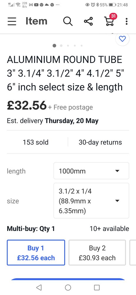

3 1/2" (88.9mm) OD x 1/4" wall is available. That would give 3" or 76.2mm bore, so would need boring out to get the 80mm you need leaving just under 4.5mm wall.
88.9mm x 6.3mm (3 1/2" x 1/4") Aluminium Round Tube
3 1/2 in x 1/4 in Aluminium Round Tube in Stock Now. Bulk Discounts. Buy Online or Call 0800 520 0729. Top rated Supplier.www.aluminiumwarehouse.co.uk
Yeah that's the supplier I meant. I used them when Droitwich Aluminium had not got what I needed.Try:

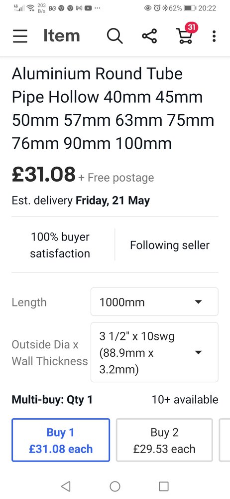

Edit: 90 x 5 metric tube (expensive) https://www.ebay.co.uk/itm/254627829193

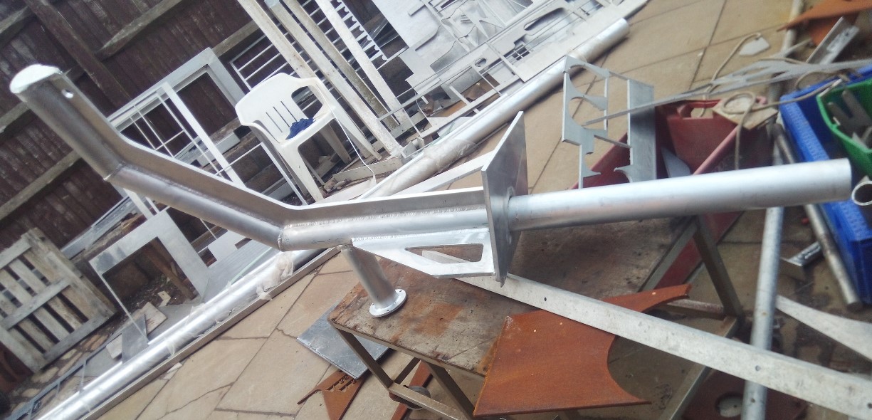

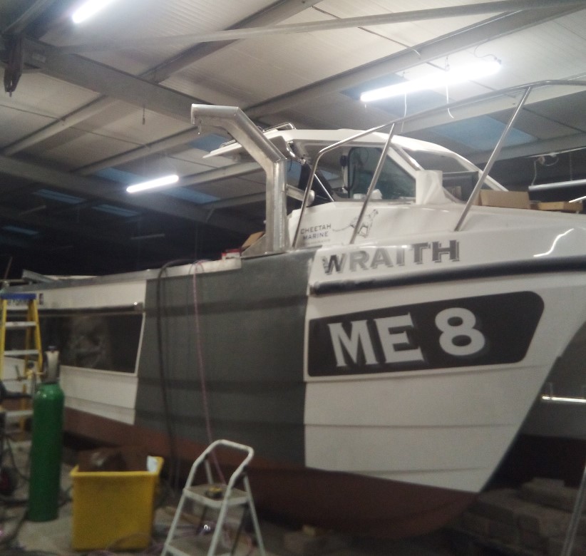

I used it for the davit arm on this boat and I am fairly certain it was 3.5" x 1/4" wall.
