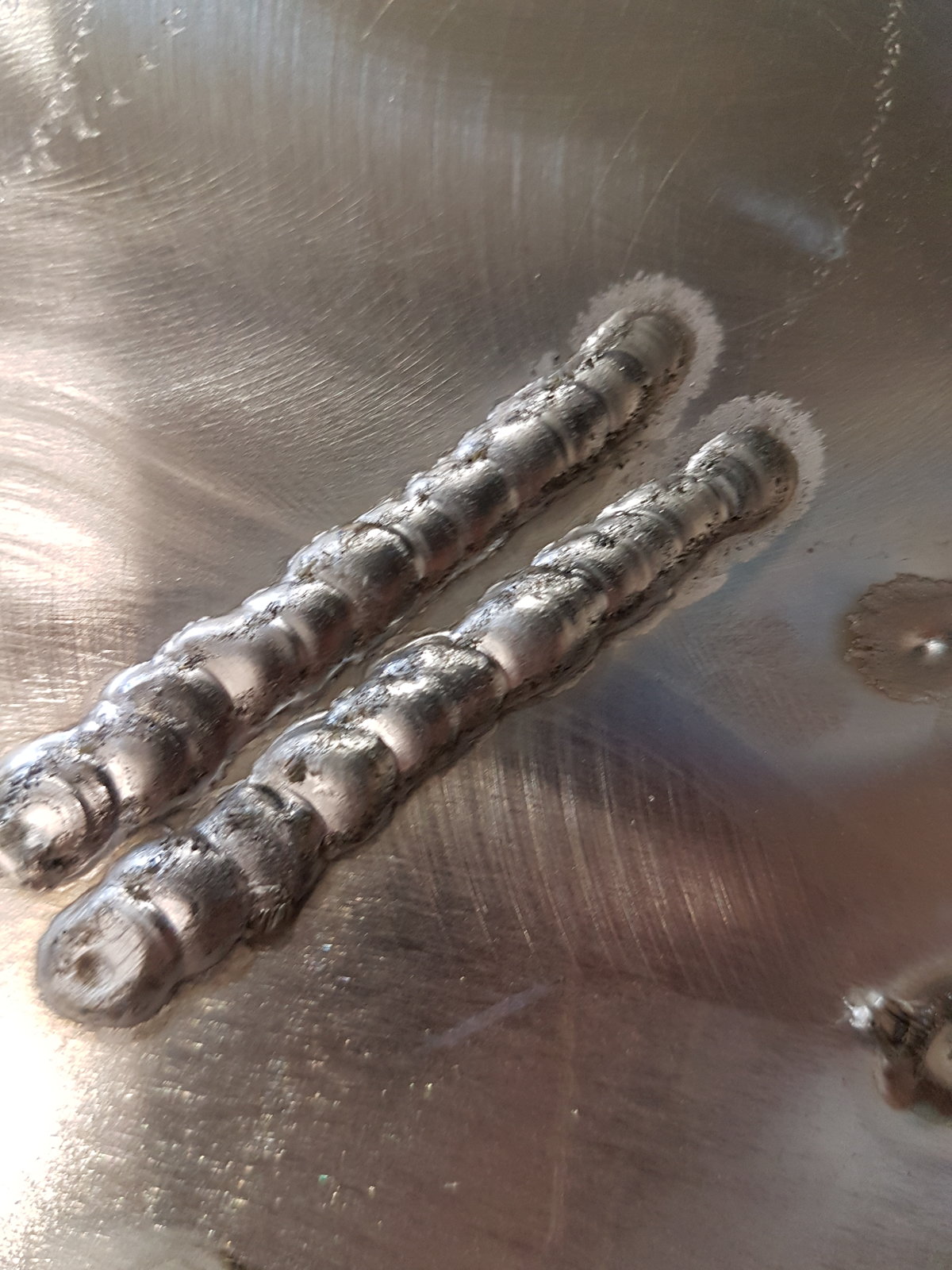

Changed to a normal cup and checked for leaks can't hear or feel any

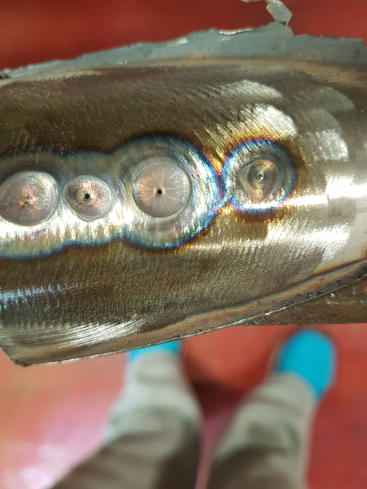

Also here's a couple of welds on stainless with about 8 seconds of post flowView attachment 138716
grand ive emailed the company who supplies the gas lets see what they say about it
That means nothing.Changed to a normal cup and checked for leaks can't hear or feel anyView attachment 138707
That means nothing.
Your unlikely to hear or feel it unless it’s really Severe.
It’s all too easy to blame the gas but in reality it’s a very rare case you get a problem.
Leak test your joints.
Your not using ptfe tape are you.
Take it all off and refit all your fittings without it mate.Yes I'm using ptfe tape
I dont know this machine, but is the 35% cleaning not possibly 65% ? I was confused for ages by my machine with this till Richard set me straighti checked every fitting on the gas line with a soapy water spray and no leaks at all
the machine is a Sip hg2500p ac/dc tig
all the fittings have been taken off cleaned of any ptfe on them and refitted and leak tested with no leaks and still same results

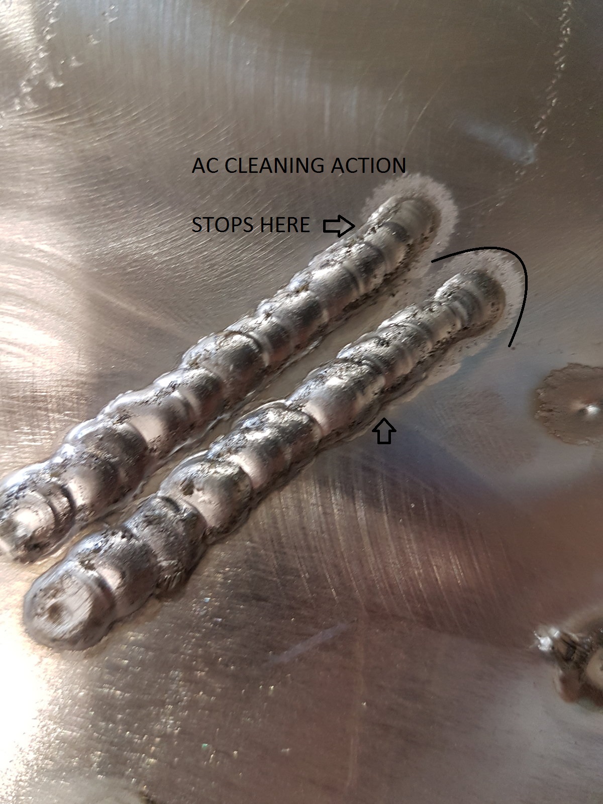

One thing I see in the ally image is the Cleaning action from the AC does start, you see the light grey splash due to oxide stripping, but then it goes off.

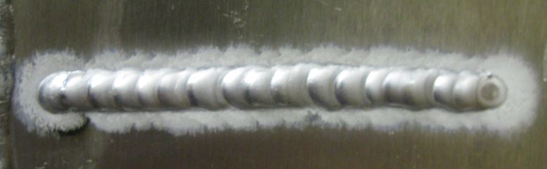

My long shot is it may be an electronic fault. As soon as it gets going on AC it works until a device warms up and then it goes more like DC. Compare with my ally attempt. Does your machine have Auto AC balance?
